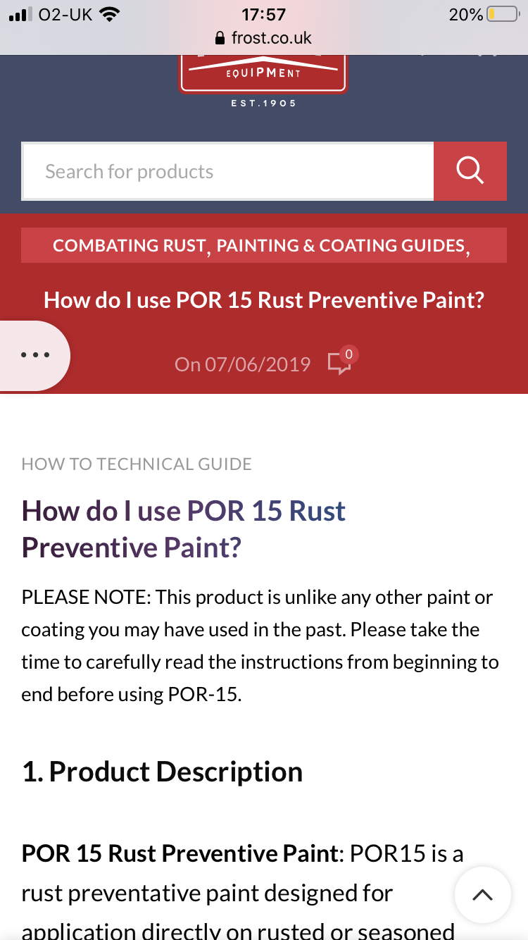

I was considering this job myself. My initial thought was buying some Hammerite Straight to rust, but came across an engine sway thread for a caddy van and they used something called Por 15 Rust-preventative paint.

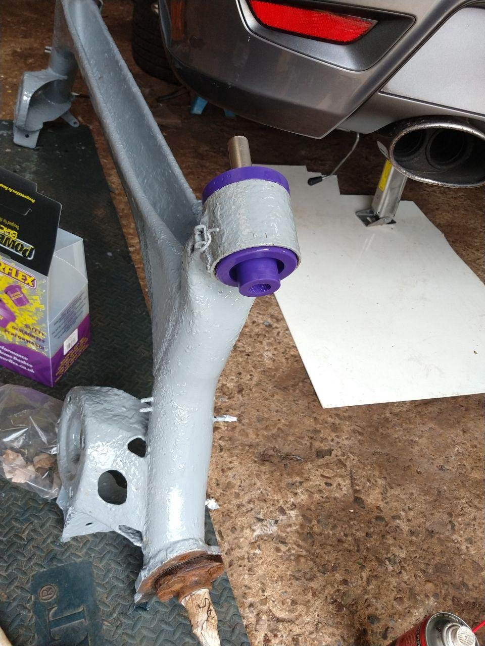

Anyone know the how to fit the powerflex rear beam bushes?
I have them like this but wonder if i am supposed to use the platic end from the old bush to cover the protrusion on wheel side

Unsure if i explained what i mean correctly 1976579126_rearbeambush.png.2b0f2588d4b7bf080b716b9d3a97153b.png
This bit sticks out the side of the rear beam and fills the gap.
with the powerflex one there is only that narrow end to it + the metal insert. Unsure if that is correct or not. Any ideas?
Thanks

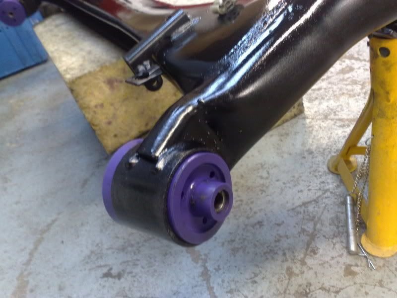

Looks to me like you've got it right. This is a pic from another member's installation (Tech1e)....

Thanks TMB
great :)
I know Techies ones are superpro but imagine it is much the same

& as for the bushes I used Powerflex all around & my OEM bushes did not have that spacer....so the Powerflex bushes went back in as shown..
