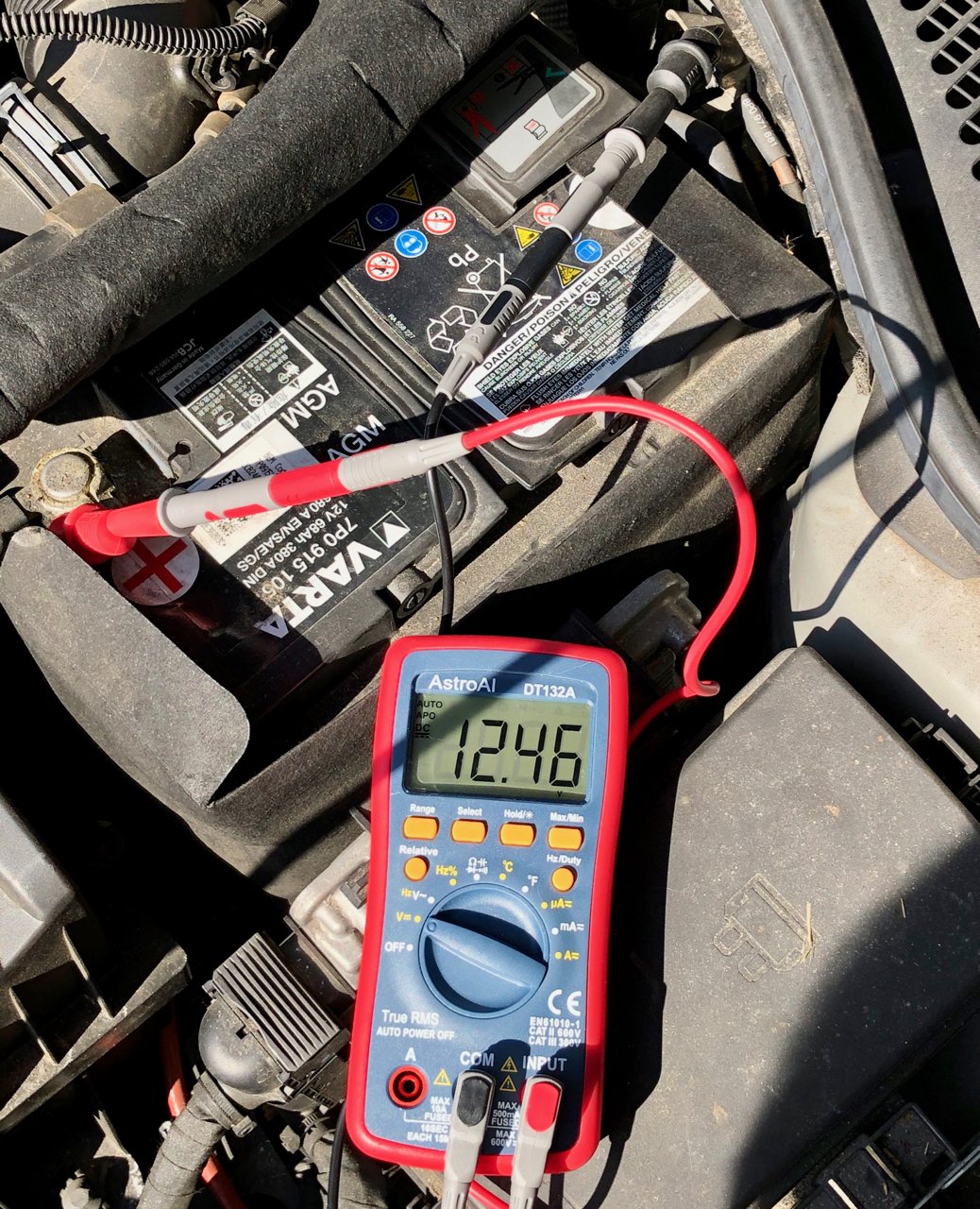

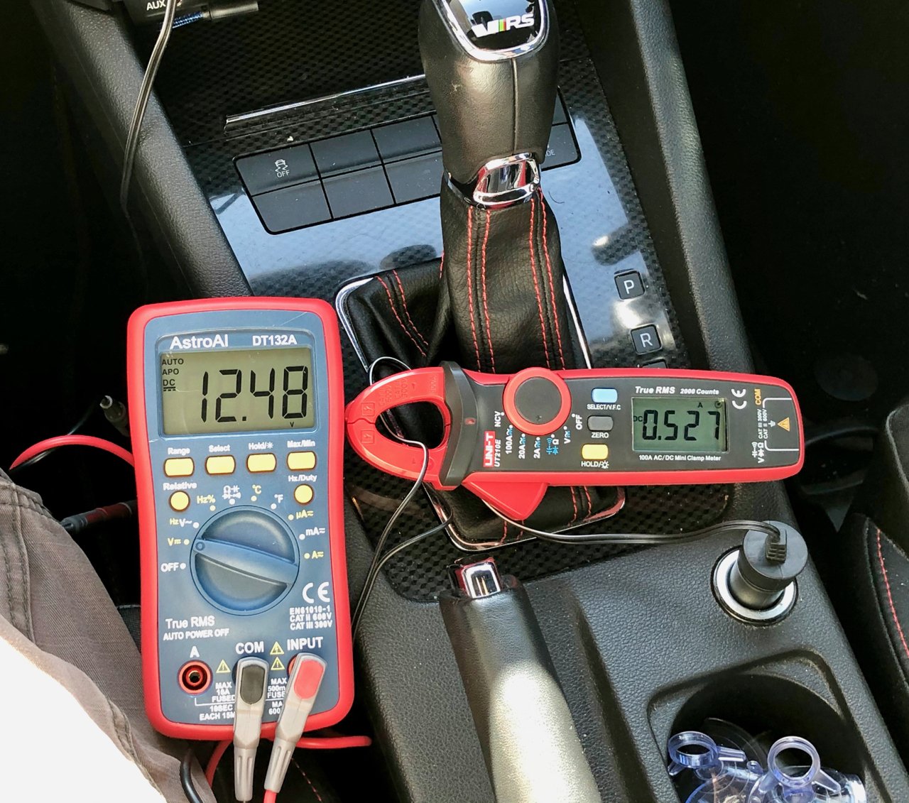

I think the battery level may have dropped too low. Using a multimeter across the battery terminals this morning i was getting 12.1V.

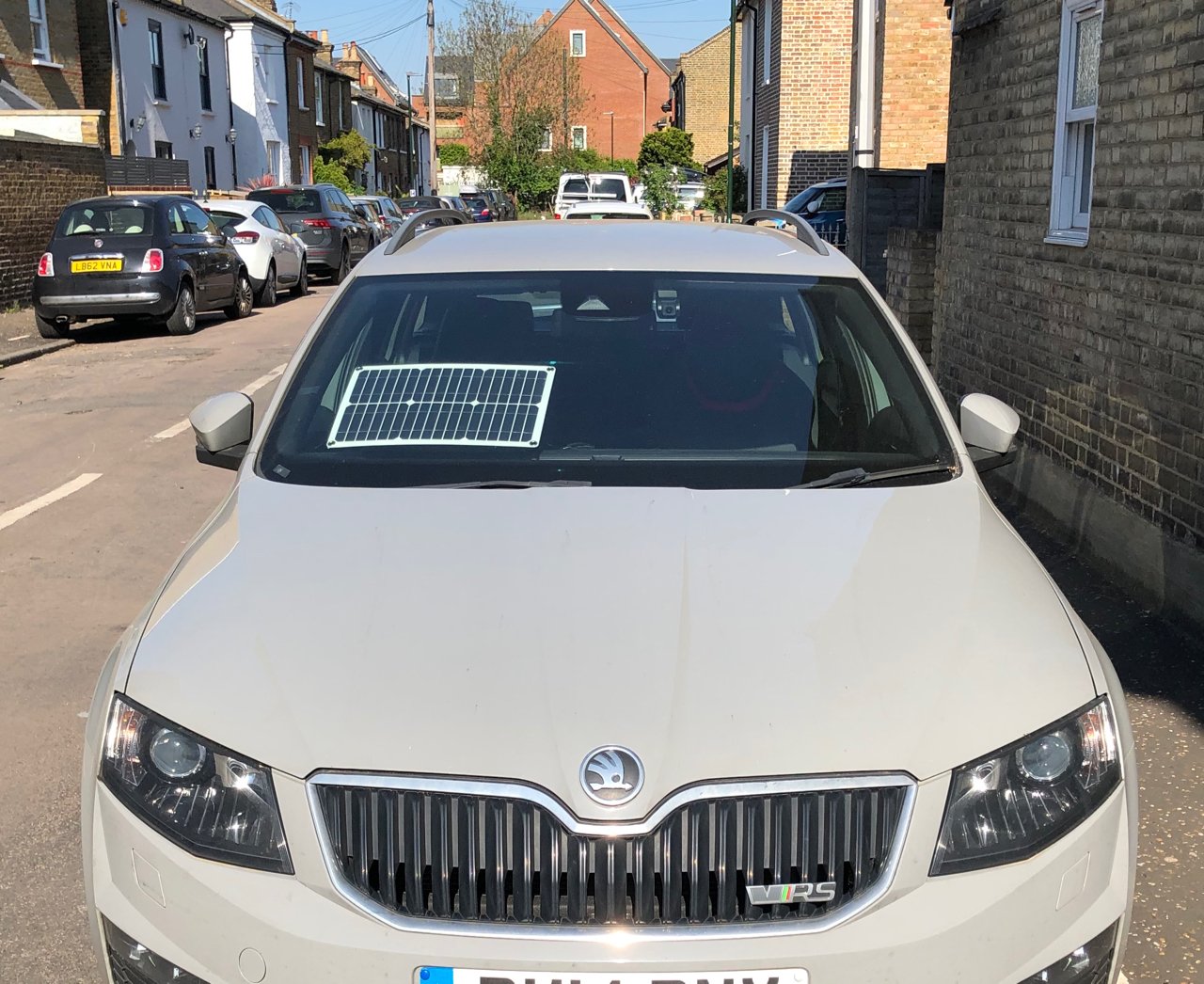

I did buy a "SARONIC 18V 12V 18W Solar Battery Maintaner for Automobile" from Amazon for £34 (I know that's half the price of a decent smart charger, but I don't have mains power by the car). I've set it this afternoon, and with clear skies and 20°C it appears to outputting about half an amp which I think is good enough to trickle/top-up charge a good battery.
I'm not well versed with how car charging system work, but I'm assuming the almost 12.5V I'm seeing at the moment is down to voltage the panel is putting out, so I'll check against once the sun has gone in.
Annoyingly, where the car is parked it's in the shade until about 3pm (never noticed until today), so I may see if it starts over the weekend and if it does, then take it a couple of mile down a fast road, and park it in the sun when I get back.
0.5Amp for 2 hours a day probably isn’t that useful, but better than nothing. If you can get it into the sun for closer to  5 hours a day, that’s probably more than enough to at least stop the battery dying.
in theory that charger can put out 1.5Amp, so maybe play with angles to get it closer to 1 if you can’t move the car?

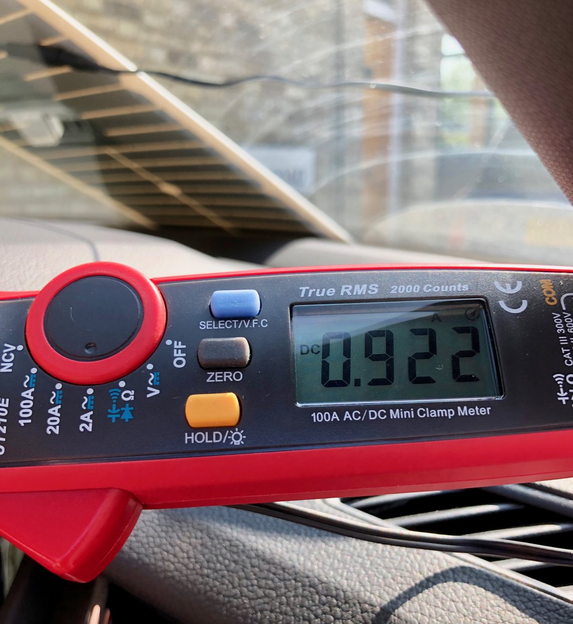

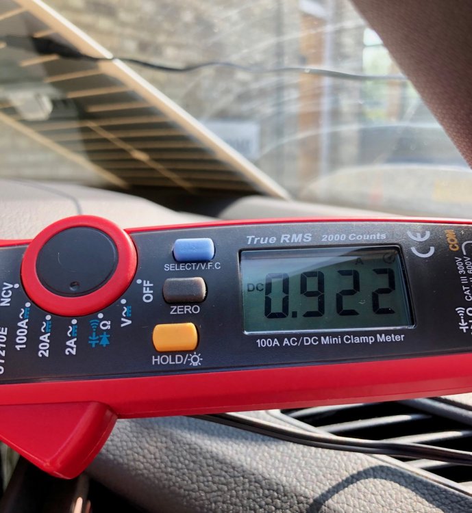

If I put the panel on the outside of the windscreen I get 0.9 amp, when placed inside the screen I get 0.5 amp, and the same 0.5 amp through the side windows (with door open to catch the sun). I'm assuming there's a protective layer in all the windows that's affecting the panel's ability to generate current. Looking at the specs of the panel I think 0.9 amp is pretty close to it's maximum.
The car hasn't moved at all since the 30th of March, and that was just around the corner to MOT testing centre and back, so it's done maybe 2 miles since the 9th of March. I'll try and start it tomorrow, and if it does, I'll take it for a spin down the dual carriageway and back.

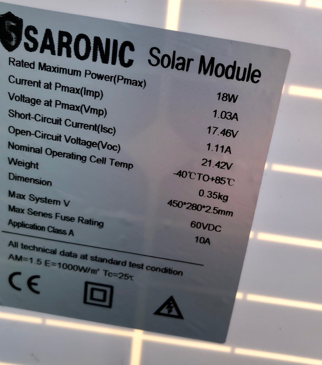

17V is an open circuit voltage similar to what I can measure from my old school battery chargers if not connected across a battery, it will stabilise at 13.3v max.
33 minutes ago, cheezemonkhai said:
17v is a bit concerning...
It actually puts out 19 V, but as J.R. points out below, that's with it not connected to anything (other than the multimeter), it drops once connected to the car.
It lists 21 as open circuit, but if you’re saying it drops on load then all good.
TBH it inside the car at least gives the car an amp a day of power. At the very least it’ll slow the drain and if you can get more hours it’ll probably keep it right.

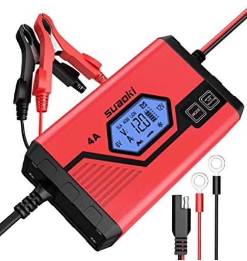

I do have a charger but not had to use it yet.  I've noticed my charger pulses up to 20V so if I do need to charge up the battery I will have to disconnect the terminals in case that voltage is too high for the electrical system.
Mine was a very good value SUAOKI Car Battery Charger:
https://www.amazon.co.uk/gp/product/B07793CK5K/ref=ppx_yo_dt_b_asin_title_o03_s00?ie=UTF8&psc=1

So 5 weeks without moving (and three weeks of not moving prior to that short trip), some probably poor attempts at trickle charging, and it started fine. I have no idea how much of a difference the solar panel made, the car got maybe 12 hours at 0.5 amp, and 3 hours at 0.9 amp, and I definitely some low voltages  (down to 12.1 one morning) , but my gut feeling is that the battery was probably in better shape than I gave it credit for.
