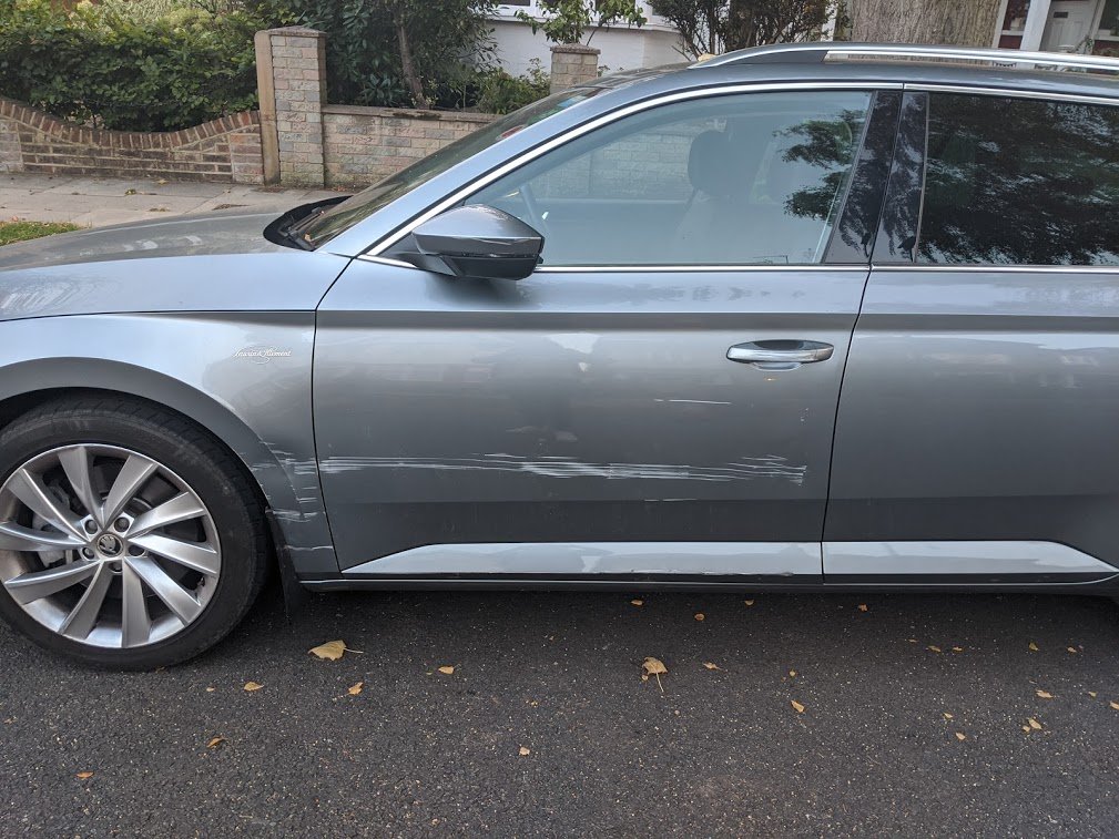

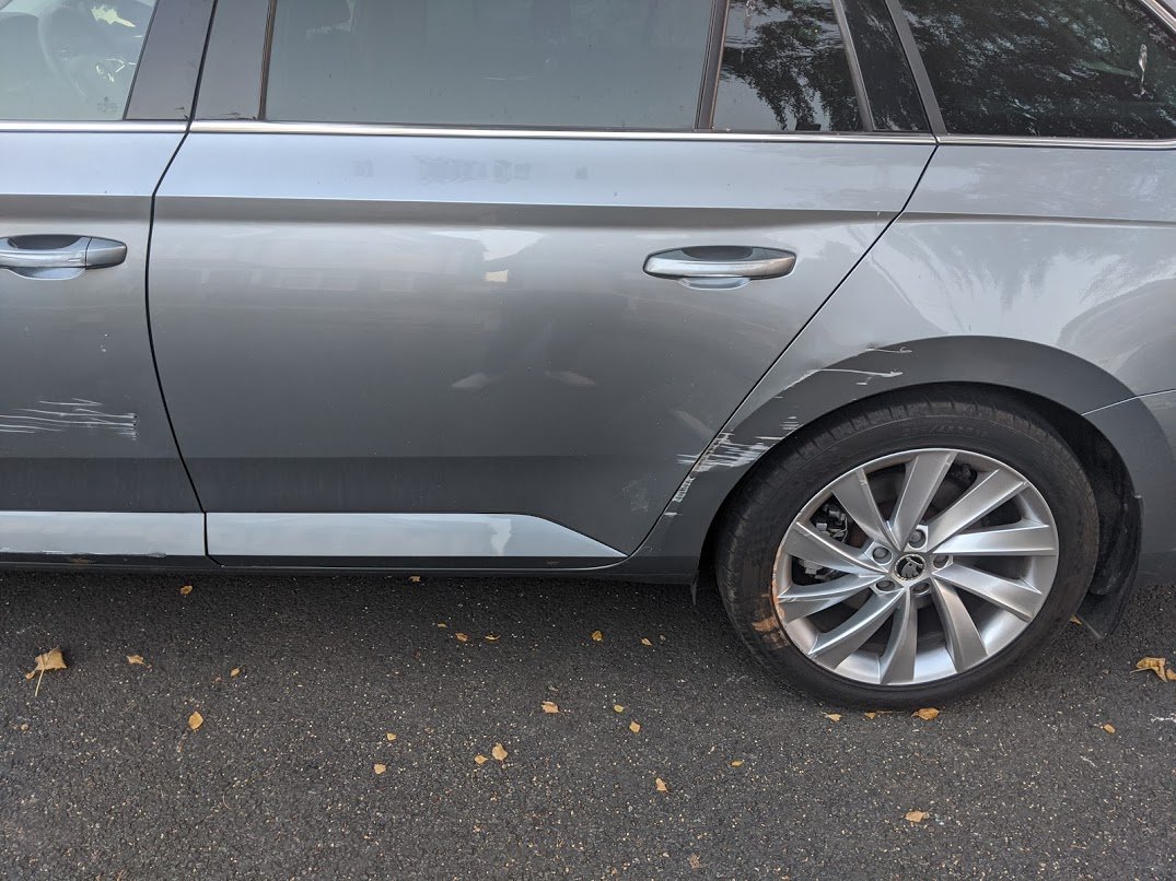

The wife managed to scrape the entire length of the car against a fence post at the weekend. :crying:
It's all fixable, but it's going to have to go to a bodyshop (probably on insurance) I think to get repaired.
Oh s..t
Edited by pab567
Thats unfortunate.
The car just got back from the body shop this morning, looking much better! All of the bodywork has been repaired / repainted by our local ChipsAway who did a great job (cheaper to not involve insurance).

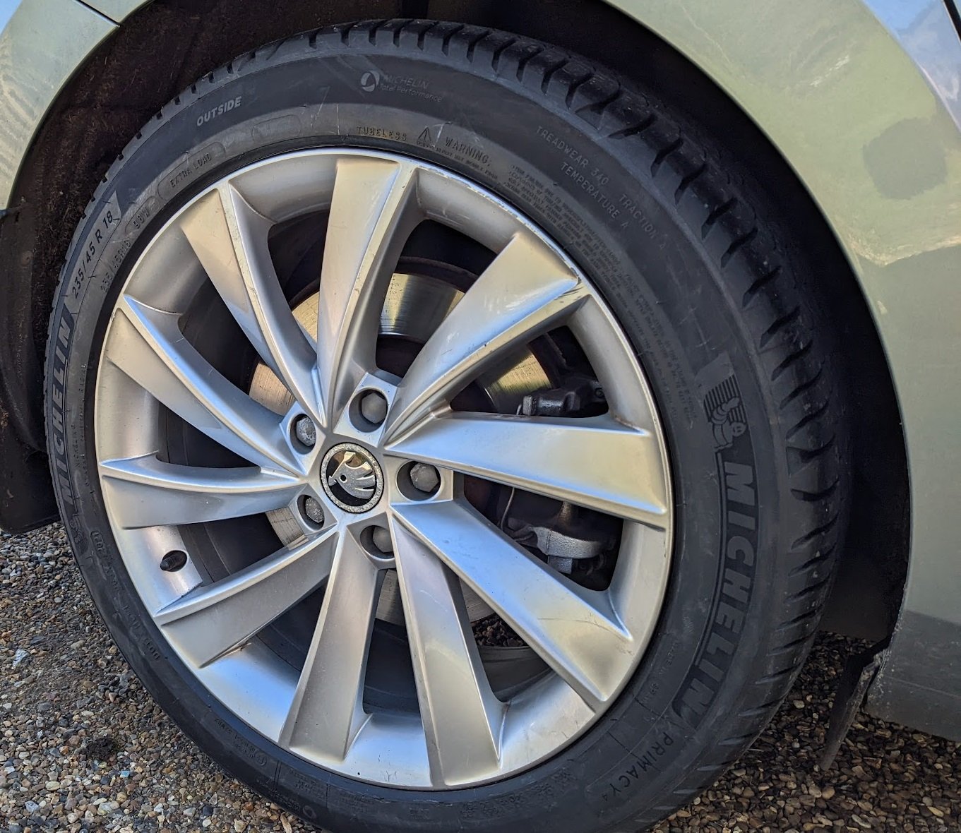

Terrible weather today, so no photos but will update once I've got the all season wheels & tyres on - booked in for this Wednesday. I've gone for Michelin CrossClimate+ (which were on offer) which will go on the 17" wheels (the summer tyres will stay on the 18"). :)
Edited by ChrisCh
FIxed and now with all season tyres!
Hopefully all set for the winter now.

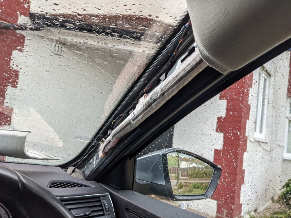

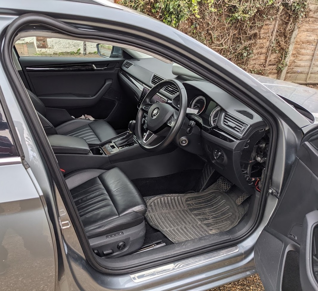

How to replace the inner door rubber seal Skoda Superb 3V 2016:
I finally got around to replacing the broken / worn inner door rubber seal on the right front door (drivers side) - it had been torn by a previous owner.
The first job was to remove the panel on the side of the dashboard using a trim removal tool (photo shows the clips - no screws).
Second job was to remove the existing rubber, which was quite easy to do - but to get the last piece out I had to remove the trim on the A-pillar. This is just clipped in.
At this point I managed to get most of the rubber seal in - but couldn't get the last bit in the top left in as there wasn't enough room / give in the B-pillar trim.
Consequently I had to remove this trim - which was a bit fiddly. Most of it unclips, but there is a Torx screw hidden under the airbag logo at the top - use a screwdriver to pry this plastic cover off (it's very right). The two bits of plastic have to slot together before re-assembly (see photo) - otherwise the seatbelt height adjuster isn't held in place properly.
All done and re-assembled in around an hour and a half.

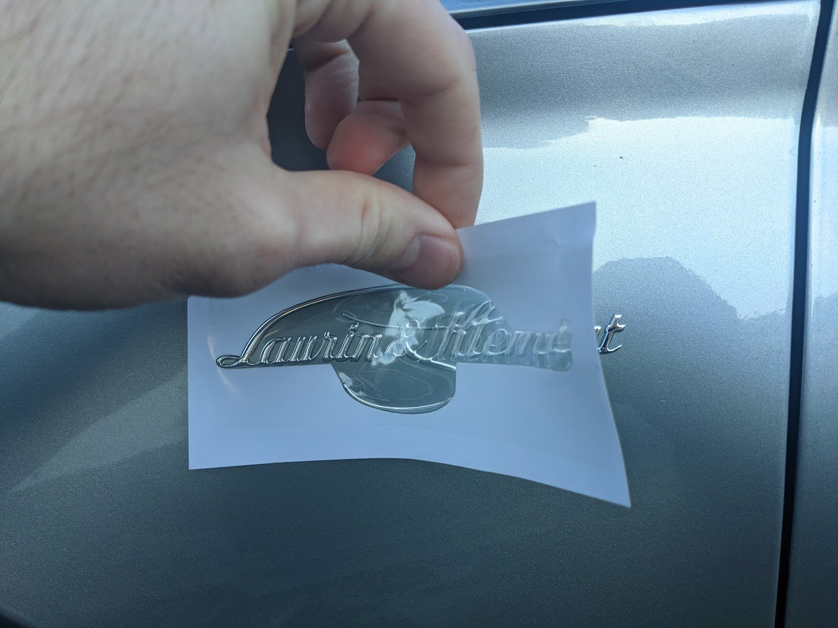

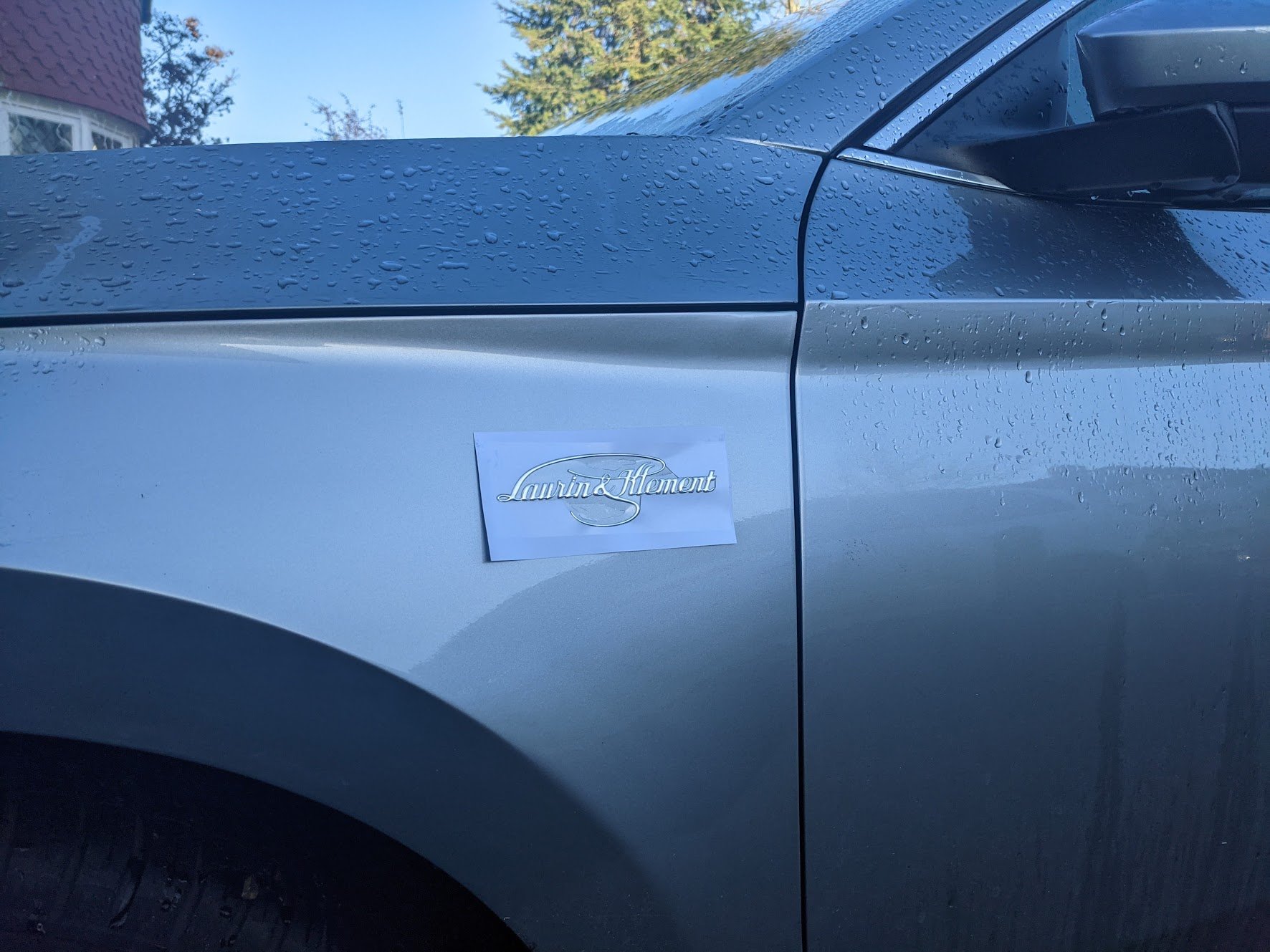

Can't believe it took me a year to notice... after the crash repair there was no L&K emblem / badge on the left hand side of the car.
Carefully aligned using my phone as a measurement point to the bonnet (good enough for me - I can't be bothered to measure it properly!)
Now sorted
