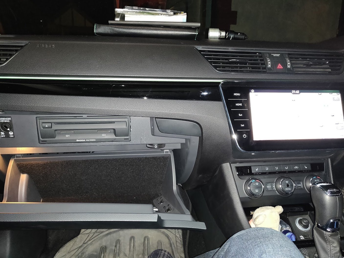

MIB 2 unit removed (to be sent off for re-programming as MIB 2.5):
New Columbus 9.2" screen during testing (hasn't arrived yet - thanks to pab567 )

9.2" Columbus now installed. Very pleased with the end result - definitely a sizeable improvement! 😁
Did you Change both the screen and the glovebox unit for this?
Hi Dan - yes, I removed the glove box unit and sent it away for reprogramming (from MIB2 to 2.5).
Speakto pab567 on this forum.

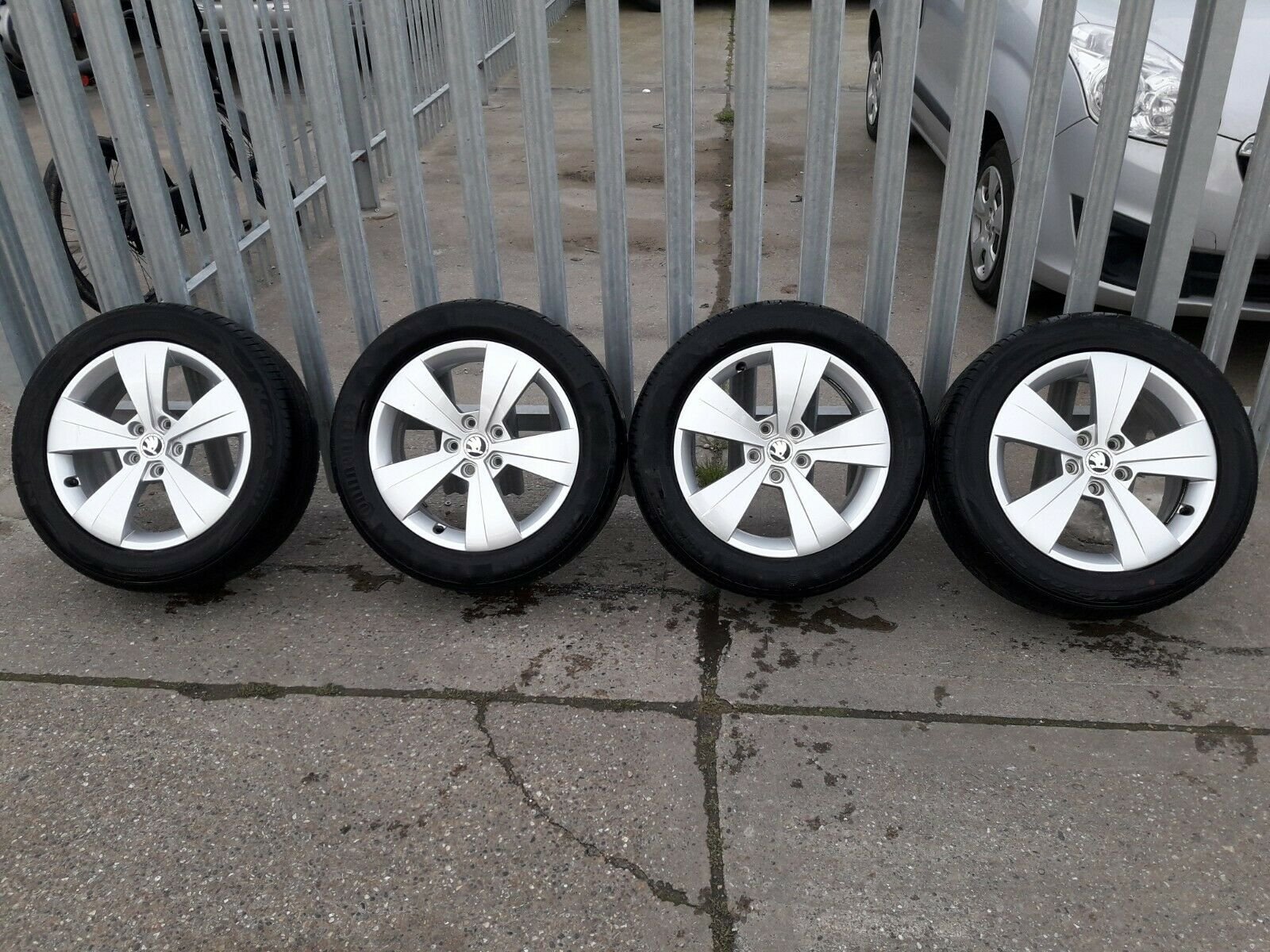

Picked up these wheels and tyres this week (for £300) which will make a great winter set. Very pleased with them as they're in very good condition and will fit😃
Same design as the standard SE alloys 17" from my 2016 Superb. Very easy to clean BTW.:thinking:

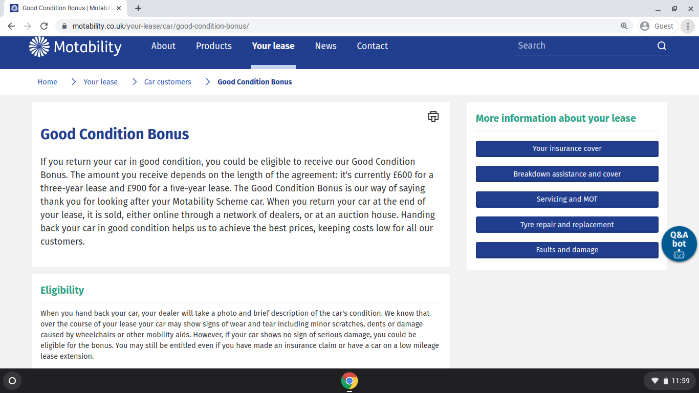

PS
You are allowed 20,000 miles with a Motability Vehicle.  so 60,000 miles with a 3 year lease. (years back it was only 12,000 miles a year.)
If you have done under 15,000 mile in 3 years you can apply to extend the lease for another 2 years.
PPS
You do not get a 'Refund' you get a 'good condition bonus payment' which is £600.  If the Condition is good.
Currently people can apply for that early to help them out financially.

George I'm sure ChrisCh appreciated all that stuff above whether it's a refund or good condition on return medal he got some cash back which made him happy.😃

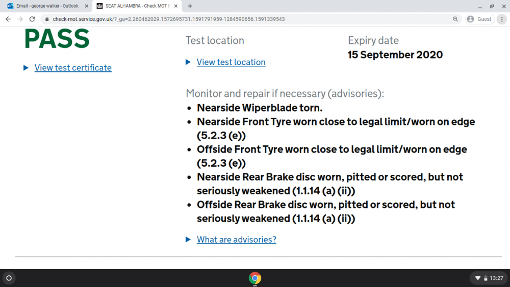

(For 2 months Motability thought i still had their car, and wanted it back, and even when i told them AC had it advertised for sale they would not believe me.)
When my car went back in November i made sure the wiper blade that was not available at the Service & MOT was fitted.
Motability pay well for the Services and MOT, and work is authorised, the only bolshy ones are Kwik Fit about replacing tyre.
(They claim at the tyre centres that it costs them which is nonsense.)
AC must have sold it, as it got a new MOT in May,
and it has no advisories on that.
(As is quite normal when they are MOT a sales vehicle...)  EDIT.  Actually still advertised for sale at AC's.
