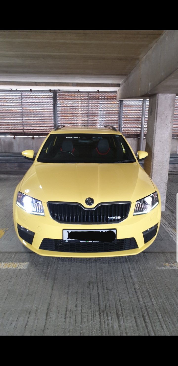

Hello,
Got a warning today asking me to check my left side (passenger side) dipped beam, which low and behold is out.
Does anyone know what replacement I need? I've had a brief look around, but there seems to be many different types.
TIA
Matt
D3S for those and you should replace them as a pair, if one has failed the other might not be far behind. A great excuse to get Osram Nightbreaker Xenarc ones as they are a huge improvement over OEM.
