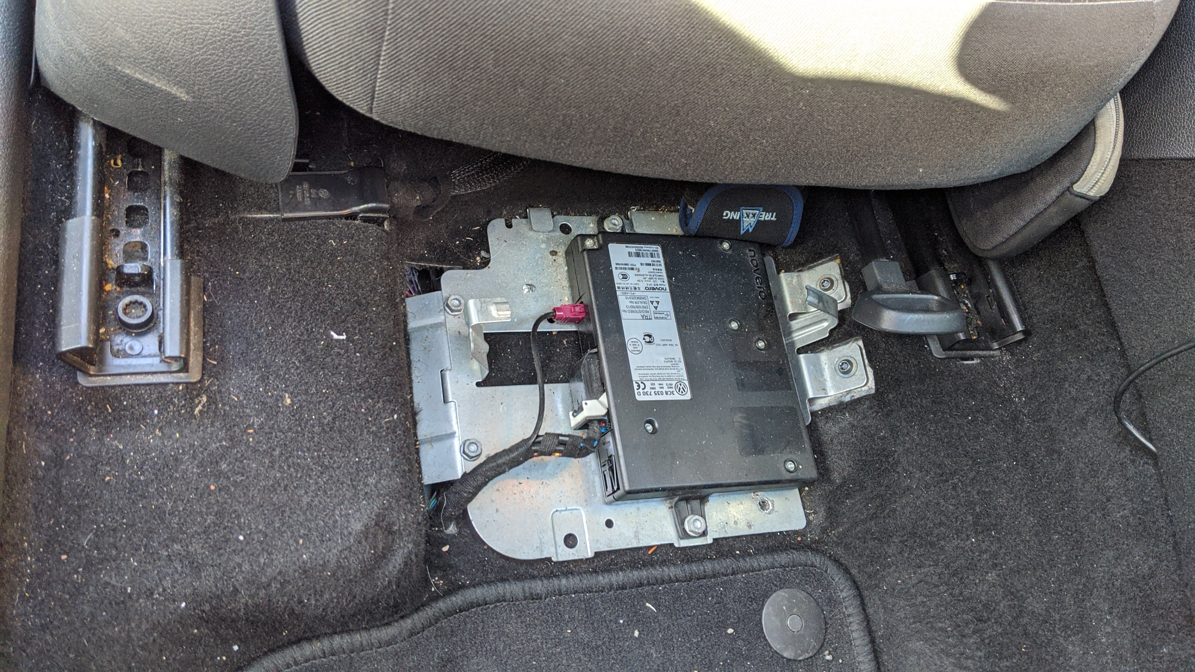

A 2014 should have Bluetooth - it was even fitted to the S model of the time (mine is a 2014 S and has Bluetooth). The module should be in front of the drivers seat under a plastic cover.
Photo with plastic cover removed - note to self Covid lockdown vacuum required!
Edited by bigjohn
Ok I have found this under my seat, so then would you say its broken, if i press the phone button on the stereo all it does is mute the sterio, would it be as simple as buy a new part and replace it or would it need doing at a garage?
Could be broken, there could be a wiring fault or something badly coded if something has been replaced previously.
Idealy, the first stage would be to get a scan done with VCDS or similar to see what, if any, faults are present.
