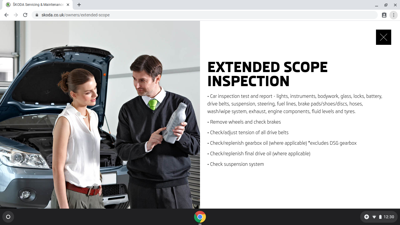

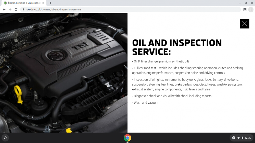

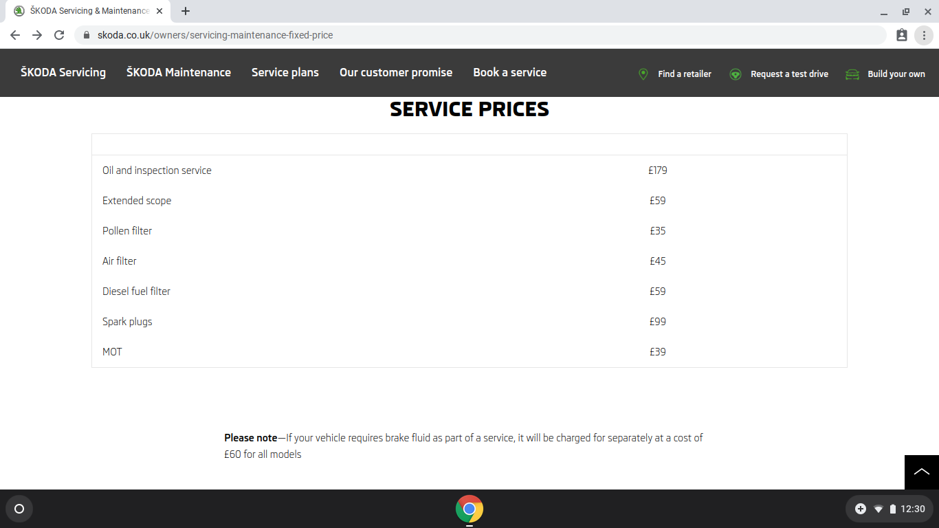

These are the new terms Skoda UK are using.
Oil & Inspection Service, then the 'Extended Scope Inspection'.  & pay extra for parts.
This used to be called Minor or Interim Services and Major Services.
