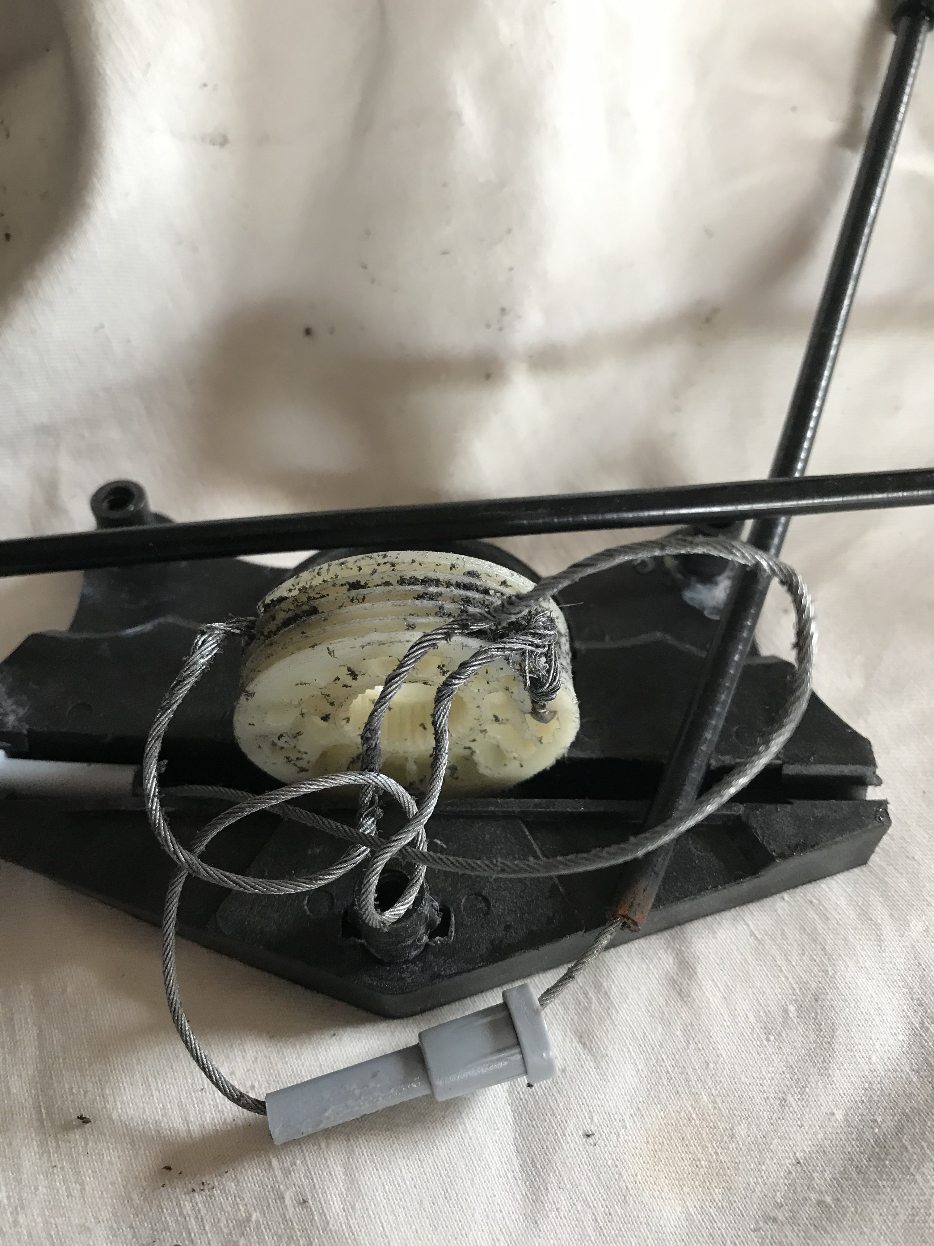

Can anyone tell me why my driver door window regulator keeps chewing up the cable. Am now requiring a third in 6 months. By the way a big hello to everyone I’m new to this site. And would be grateful for the help.

Škoda replaced it the first time it went under warranty.  That one lasted about 6 years. When it failed I got one of eBay made by DPA. I replaced it my self but it only lasted 3 months they reluctantly sent out a replacement and that lasted 12 months   The problem is the same each time as the cable becomes tangled on the circular guide and jams. As on picture. I’m just thinking that the old adage is correct buy cheap buy twice. Both the Skoda ones failed due to the cable rusting through. Cheers.

That looks like rust deposits which suggests water ingress
Hi. It’s a superb estate 2010. 2ltr diesel. Rust was the cause of the first 2 units to fail but it looks as if the cable has slipped of the guide and been chewed up. There is only one way to install the regulator but I was wondering if I had missed anything on installation or if any one else has had problems with cheap regulators. Thanks
Perhaps the answer is to cover the new cable in a very thick grease to prevent rusting?
