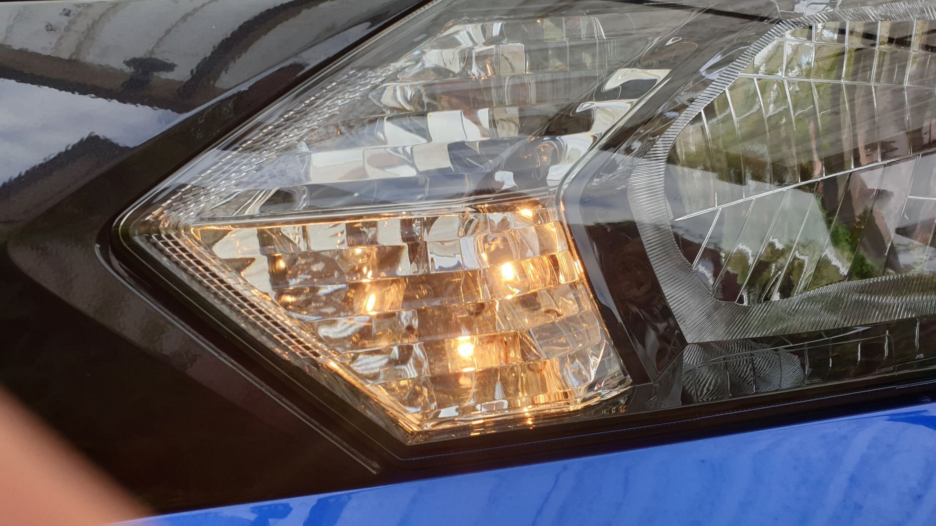

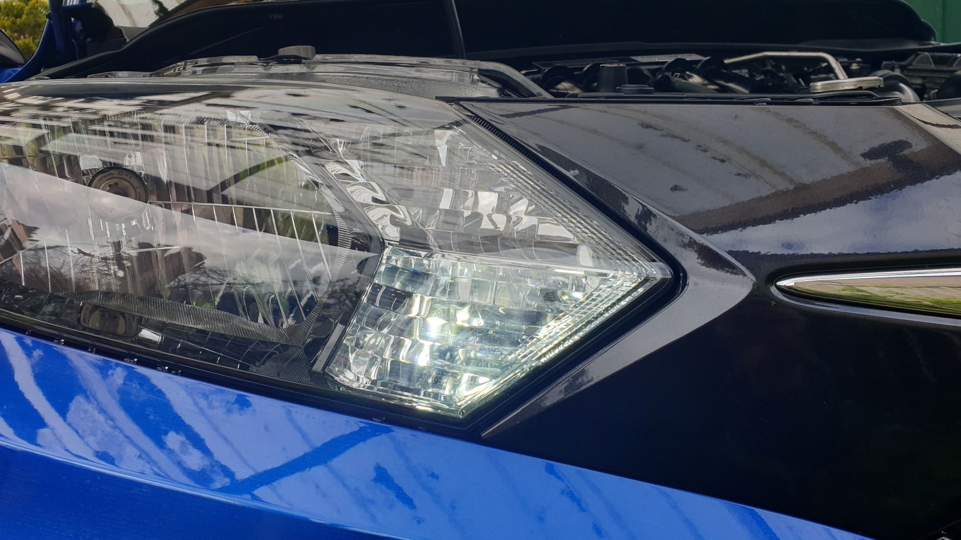

FALS742853754_HondaHR-VLEDLightUpgrade(10)BriskodaLED.thumb.jpg.a46a54d80c02dbf116d7923589664c14.jpg943308255_HondaHR-VLEDLightUpgrade(11)BriskodaHalogen.thumb.jpg.4473fb9bb988260f436845aab657e1d6.jpg

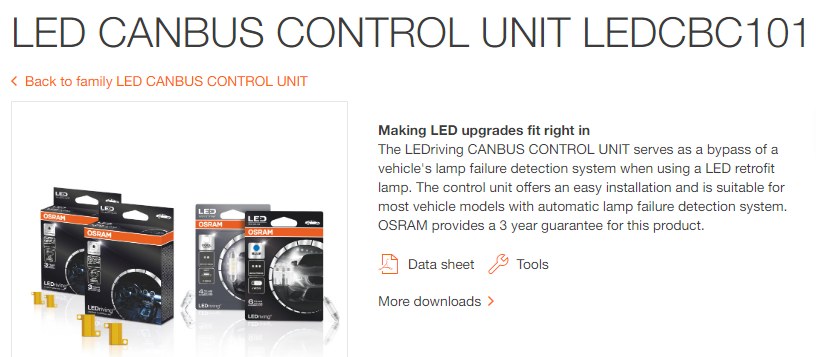

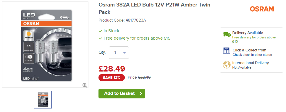

Surprisingly both Osram's P21W LEDriving SL and Premium SL bulbs are not CANBUS-friendly.
They recommend installing the relatively primitive bypass resistors, which understandably would put a lot of people off...
