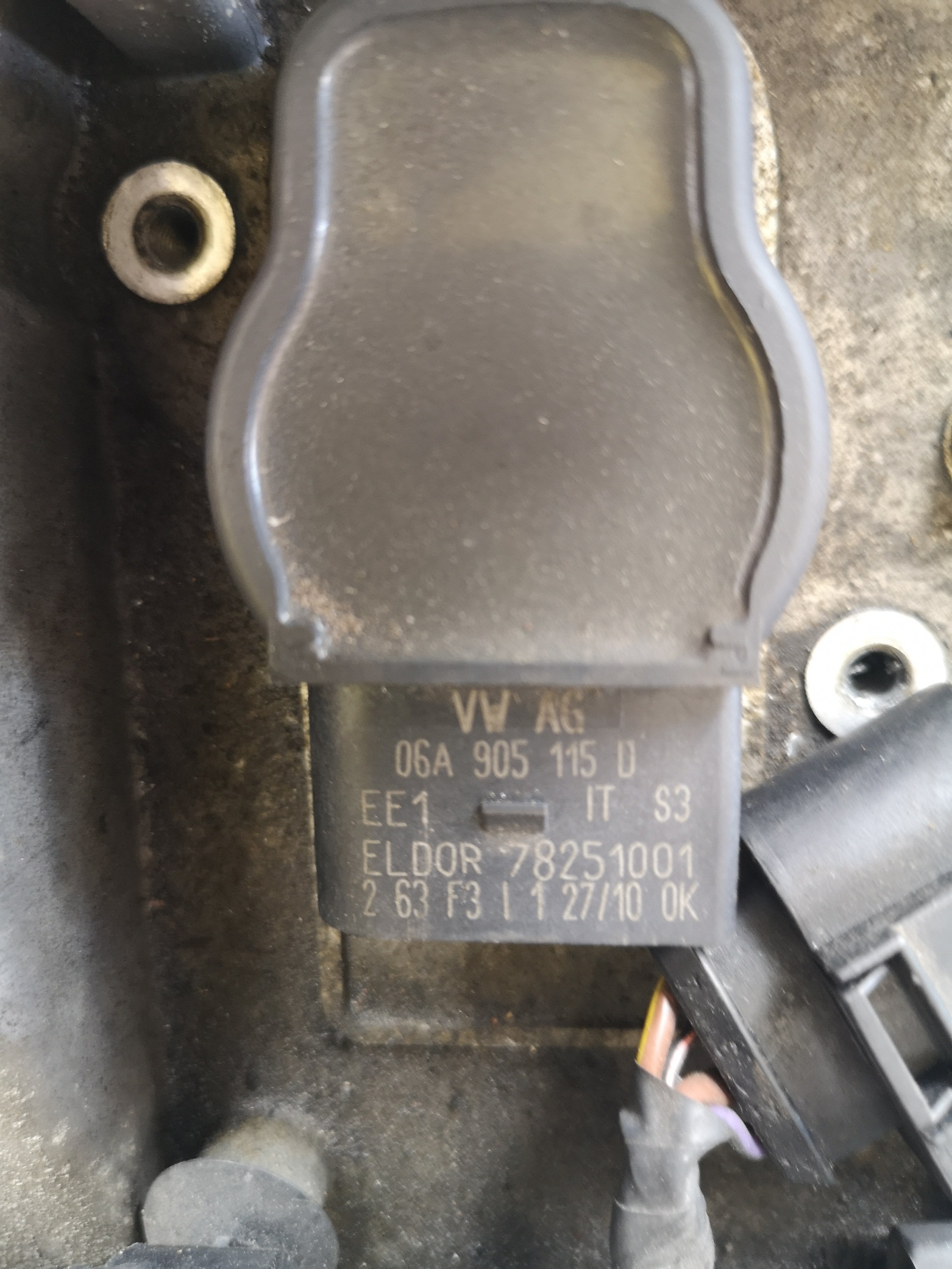

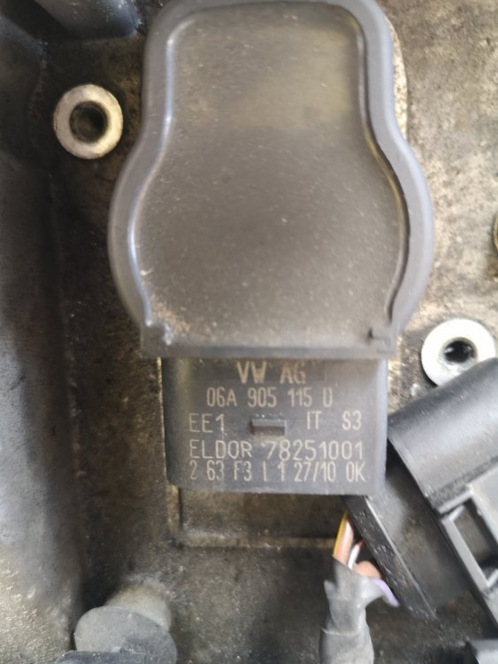

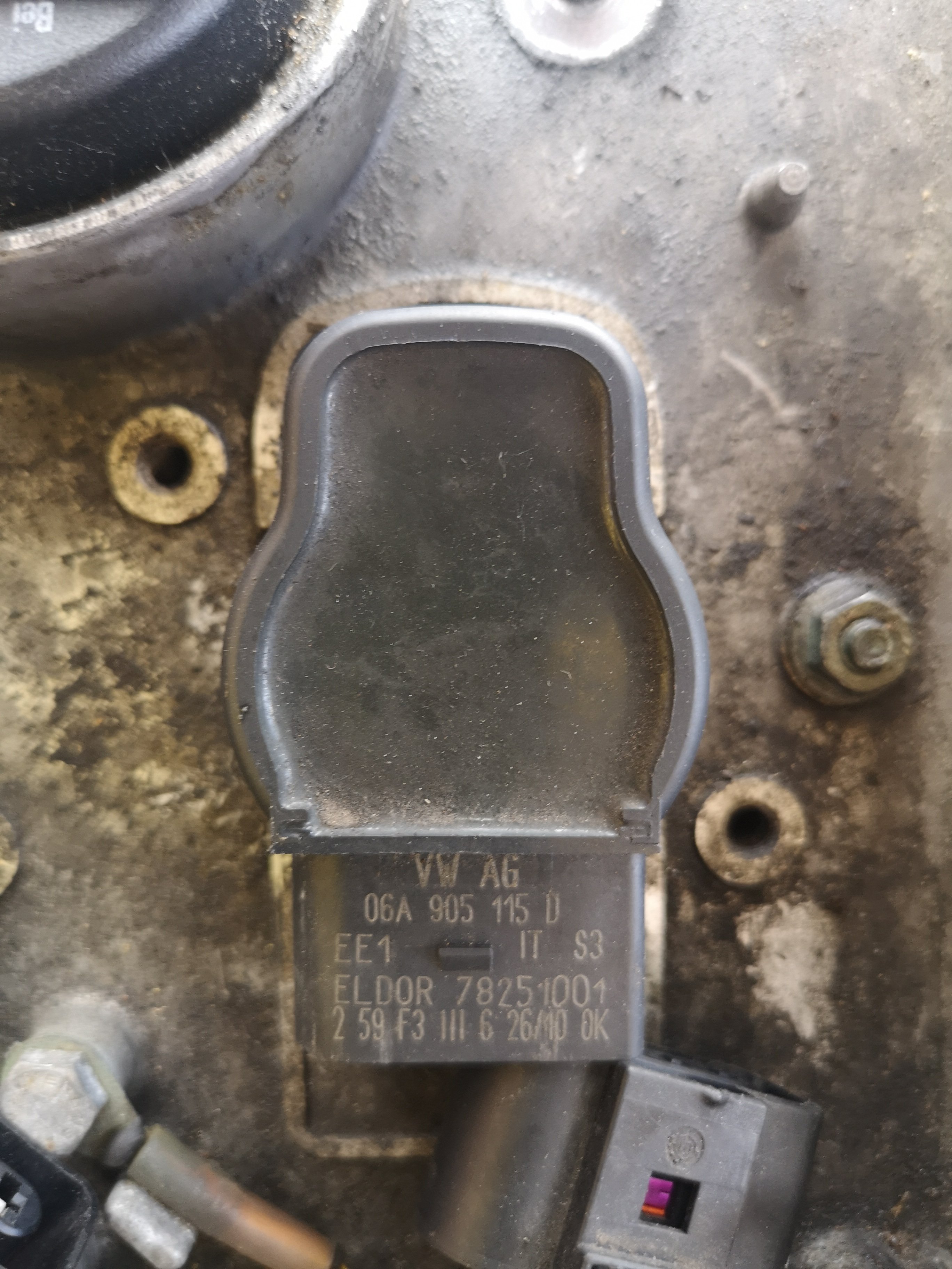

Have had a look at the coil packs and taken pictures of the information on them. Hopefully somebody on here will be able to let me know if they are eligible for the recall. It appears there are two different matching pairs of coil packs. I've uploaded a photo showing each one.
Must say that there are quite a few black cable ties holding on hoses. Surely this isn't normal, I would have thought jubilee clips....
Those are revision D coils, the part number on both is 06A 905 115 D, it is the letter on the end that denotes how recent the coil is.
I agree the coils look different, but they appear to be OEM, so it could be worth a call to your local main agent to see if your car has had the recall carried out yet.
This is the thread with the most info for you on the subject -
In answer to your other question, no cable ties are not the norm, but are we talking large bore hoses or small bore vacuum lines on your car?.
