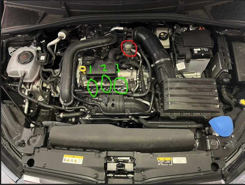

Also hows is the line up for the cylinders ? From left to right 1-2-3  or right to left 3-2-1  :D Because if 1st cylinder is the far left one then fuel rail pressure enough if not we have a problem on fuel pressure.

Do check as I might be wrong and knowing the German the three pot could be arse-about-face to the 4-pot - as you stand with the front of your thighs facing the grille far left is cylinder 1.

If its like in the photo(below) cylinder 3 is the closest one to high fuel pressure pump. I dont think the issue is tank fuel pump or high pressure fuel pum (red circle in photo)

Cylinder numbering is correct.

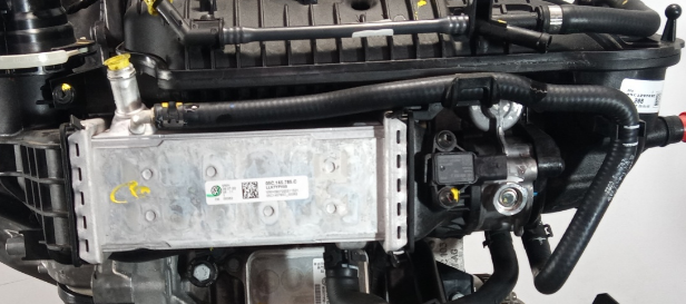

Which located here: (underneath of the intake manifold )

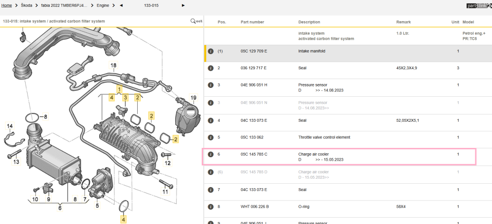

I don't see anything in the parts catalogue to suggest that a DLAC engine has an EGR valve. I think the green ring you've drawn contains a charge air cooler?

In the picture part is not EGR ?

14 minutes ago, Onurek said:
I assume EGR stands for exhaust gas recirculation
Correct. On your engine it will happen internal to the cylinder head, by valve overlap, rather than via an external device and pipes, I think.
No, it's the charge air cooler.
