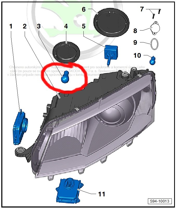

i have octavia 3 and i have problem with led bulb in my headlight. When i use this Led Bulb, car write me fault. I try this (LED sidelight bulb coding for Xenons) in this forum, but its sidelight and i need this bulb (picture). Can coding in VCDS this bulb or no?

its not sidelight its DRl and parking light (picture red ring) and i know need to be coded, but i need what change in VCDS, tutorial, or something ...

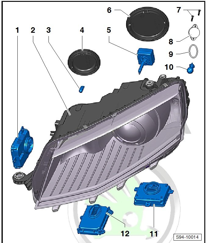

@Pugi if you have xenon headlights, the above diagram isn't for your car
I have headlights on the picture. What u don't understand? ..This is without LED DRL (picture  red ring) THIS IS WITH LED DRL (picture without red ring). IS DIFERENT... and i need coding LED BULB in red ring so car not write fault, coding in VCDS - procedure, what change .... that's all

So if the bulb circled in red is already an LED, you will not have to do any coding. If it is a standard halogen bulb, then you will have to.

I think the OP wants to install a LED bulb in the sidelight instead of a halogen one but is saying that the coding we have here doesn’t work. This coding is for the Xenon lights with LED DRL. Clearly if this doesn’t work the light channel for this bulb is different from the cars with LED DRL. This lamp unit was never available in the UK so the vast majority of us will not have the answer, unfortunately.
Unless you get the answer from someone it’s going to be a case of working out the channels yourself, try looking for one where the bulb type is Lasttyp and change to LED Lichtmodul.

If that’s the DRL then where is the sidelight or is it a dual filament bulb? Not having access to this lamp type makes it hard to work out.

I recognise the w5w and the Xenon, but what the others are, who knows.
Why one would put numbered drawings without the numbered descriptions to go with them, i don't know.
I've checked the circled bulb on the workshop manual and is labelled as Bulb for side light and daytime running light - p21/5w
Cheers........What is number 10 then???????
PWY24W, which is the indicator
