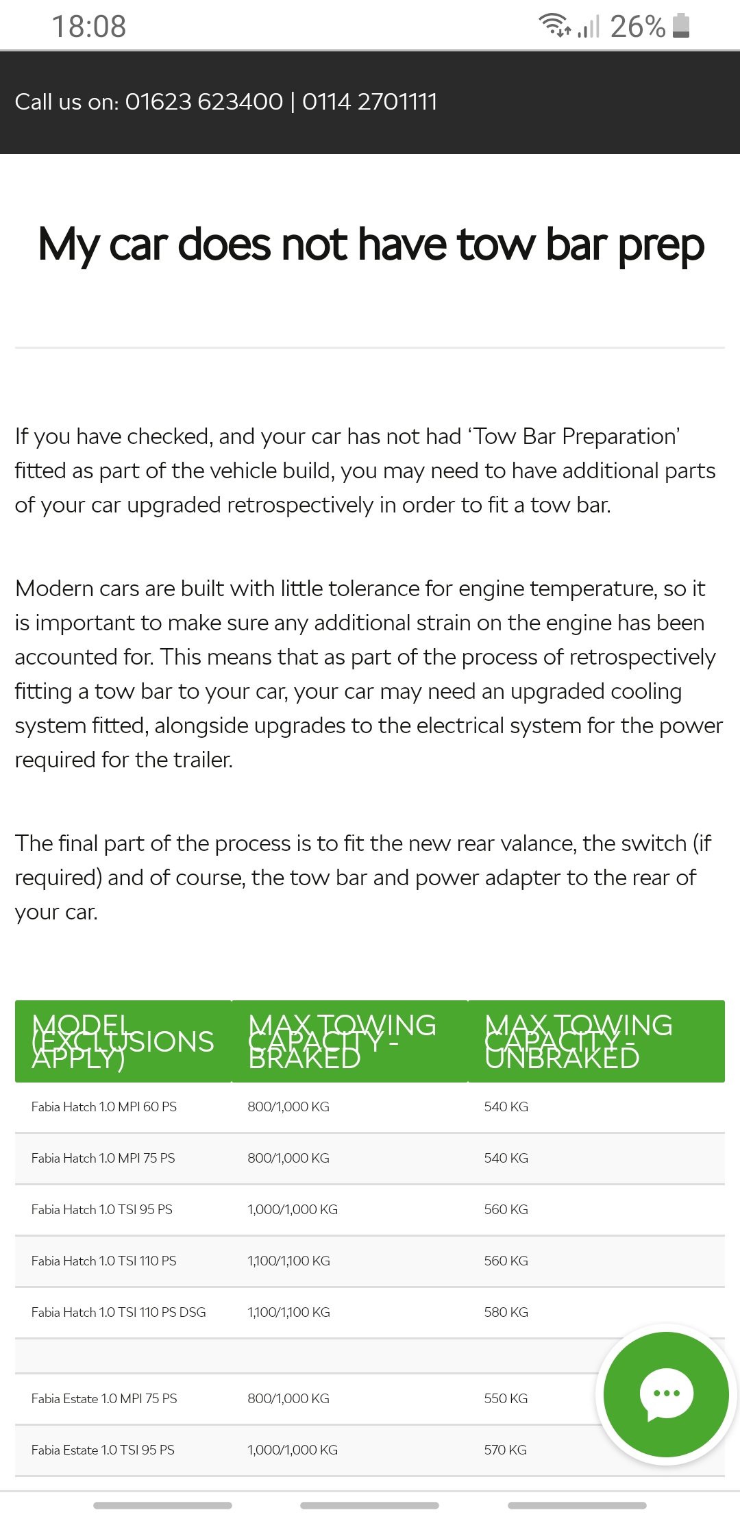

To just add, Have spoke to the Skoda dealer again and their technician has said that the towbar has to be factory fitted on all 190 DSG 4x4 regardless of model due to needing extra cooling upgrades! If it's a 2 wheel drive it's not a problem and they will fit a towbar, I also found a reference to the extra cooling on Skoda's website, Obviously this has completely scuppered my search as a 190 DSG 4x4 was my choice of car for towing reasons. Also spoke to a local towbar fitters who's systems said a towbar could be fitted but after hearing about the cooling upgrades it's just too much of a risk to take especially as I now know! Bugger!!

Tell me about it! Absolutely gutted! If was the right price, right model, right engine power, right drivetrain and I didn't even mind the red. Even had heated front seats which is rare for a Sportline because of the alcantara seats!! Obviously too good to be true which is normally is the warning sign something will go wrong!!
My SE Business has the factory fitted tow bar and prep. The factory fitted one increases the engine cooling and alternator capacity for charging your caravan.
It also links into the alarm and disables the rear parking sensors.
