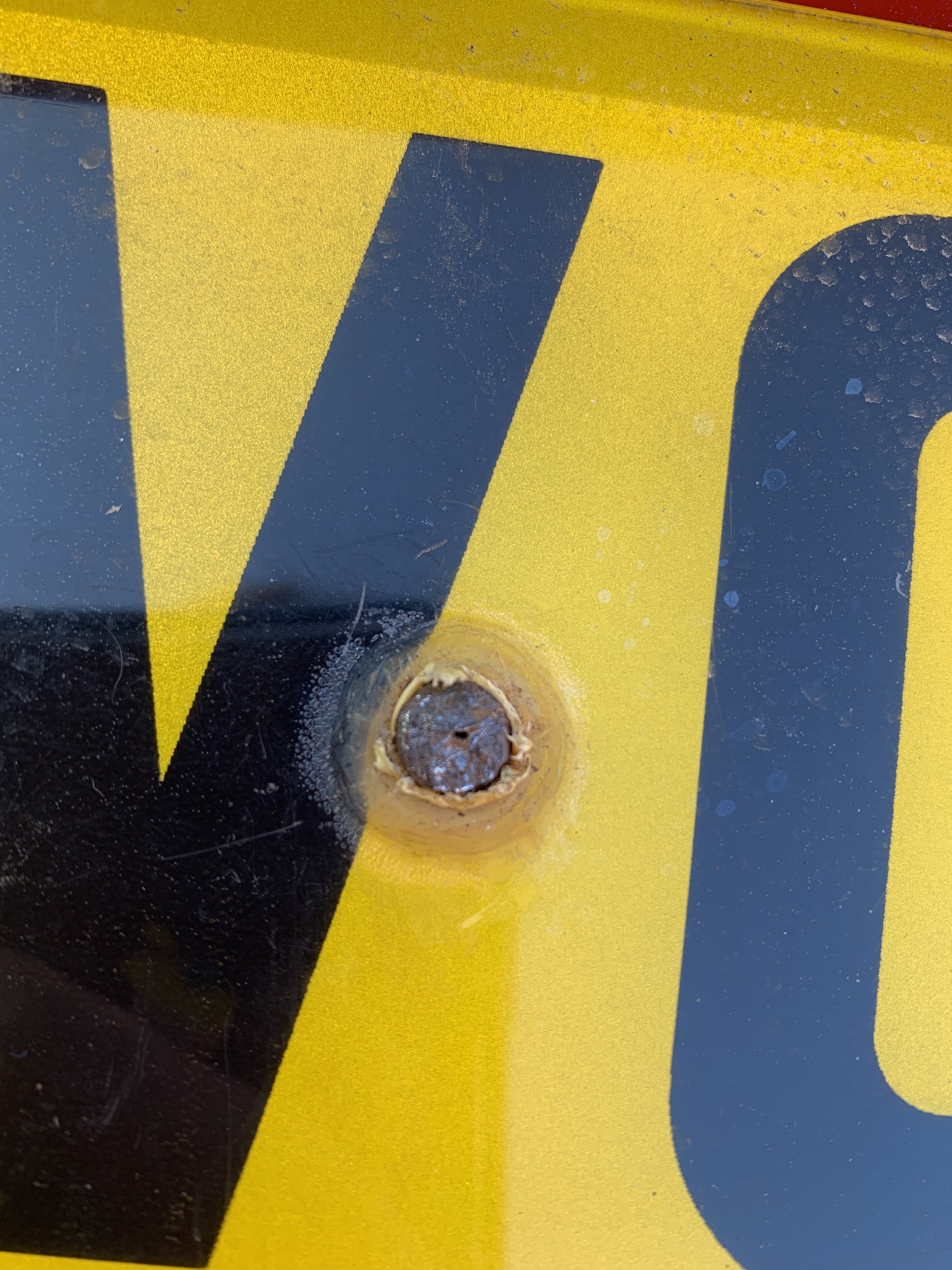

I’m trying to change the registration plate screws on my 2012 Fabia but I’m having a nightmare. They are so rusted the things are crumbling apart and I just can’t get them out.

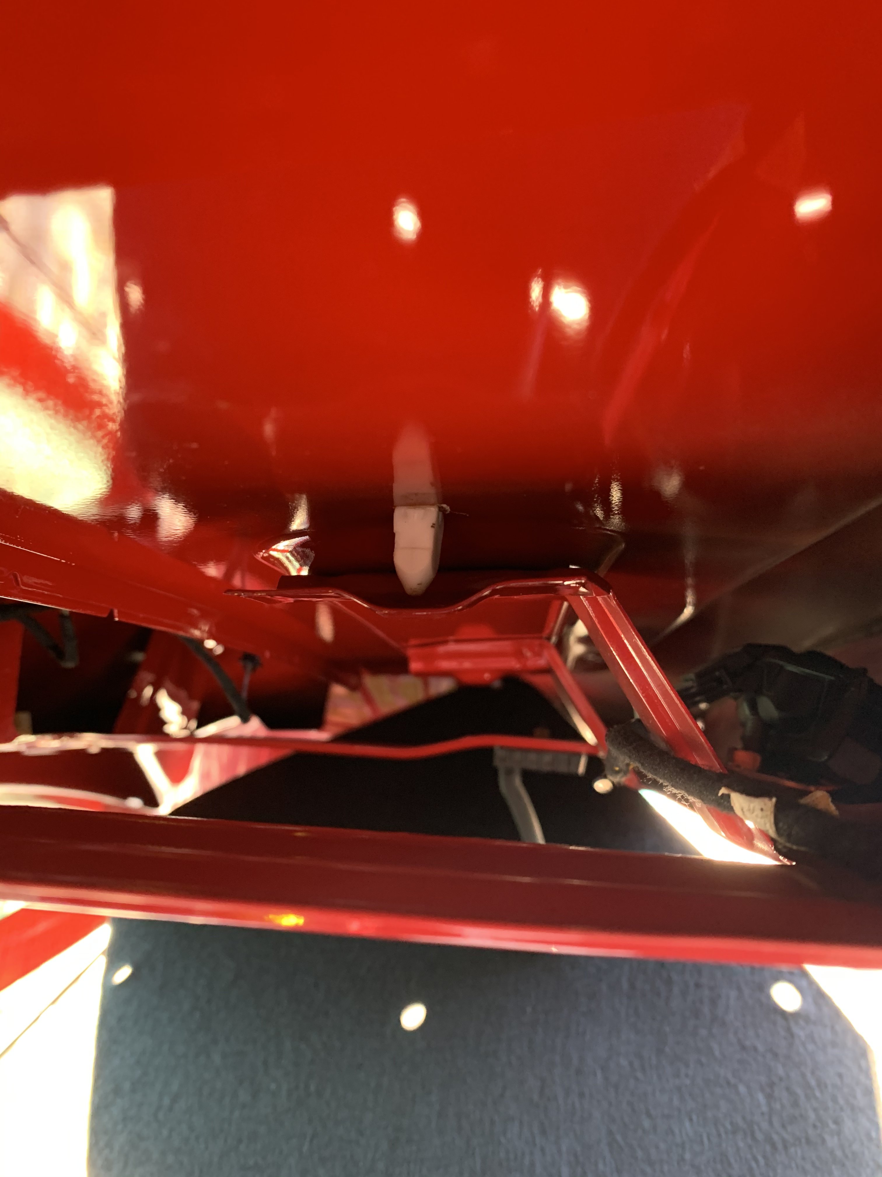

They don’t really have any cross or a slot so I’m wondering if they are some kind of pop rivet fitting?  They won’t budge and won’t turn even if I grip with pliers! Looking from the the other side of the boot they seem to be attached to a plastic piece that is locked in place.
Anyone got any ideas? I reckon if I drill it out ill
make a big mess of it.
Will these not just tap out into boot if you use a small screw driver and hammer .
Drill the remaining head with a left hand flute cobalt drill & they will back out when they get warm.
Or a standard drill bit but larger than the head, this will blunten due to the hardened head & rust and generate a lot of heat without drilling off the screw head, this is exactly what you want, the heat will soften the plastic & you will be able to pull the plate off leaving access to get a good grip on the screw head.
The new screw cap retaining washer will be big enough to cover the enlarged hole in the number plate allowing you to re-use it.
The dealers use unplated mild steel screws when they PDI the cars & fit the plates, the cover caps ensure they live their life in a bath of water & road salt, those on my 5 year old Yeti were far worse than yours, I removed them with the above procedure and used stainless screws to replace them.

Possibly but the plastic on the other side felt solid so I can’t tell how they’d pop out. I’ve googled and can’t see anything similar.

Thanks for the reply, I haven’t got any fancy drill bits so I’m most likely going to have to go for the 2nd option of drilling the head off first.
So these are a pain. I’ve been able to get a better grip of the “screw” head but if I turn it the white plastic bit turns as well.
if I grip the plastic bit the screw won’t turn. Wish I’d never started messing with it.
It’s ok. I finally just got my act together gripped both bits and it unscrewed. What an idiot.
