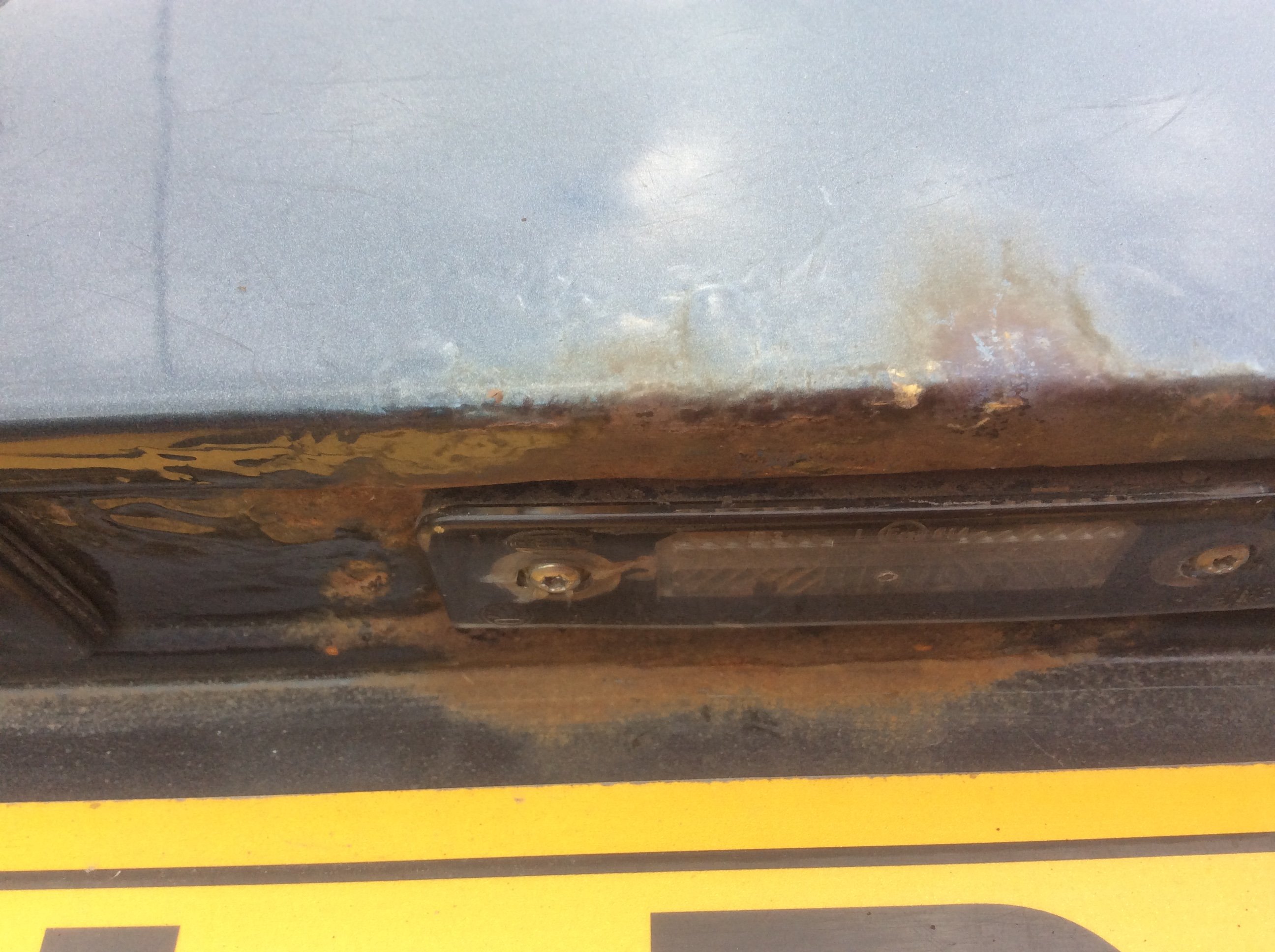

Check the tail gate for rust ! Mines pictured there wasn’t any sign of the rust back in November last year and a thumbnail size on the lip below the window mid March !!
Thats something I looked at when picking it up, after stumbling across your post. Thankfully mine is rust free for now!

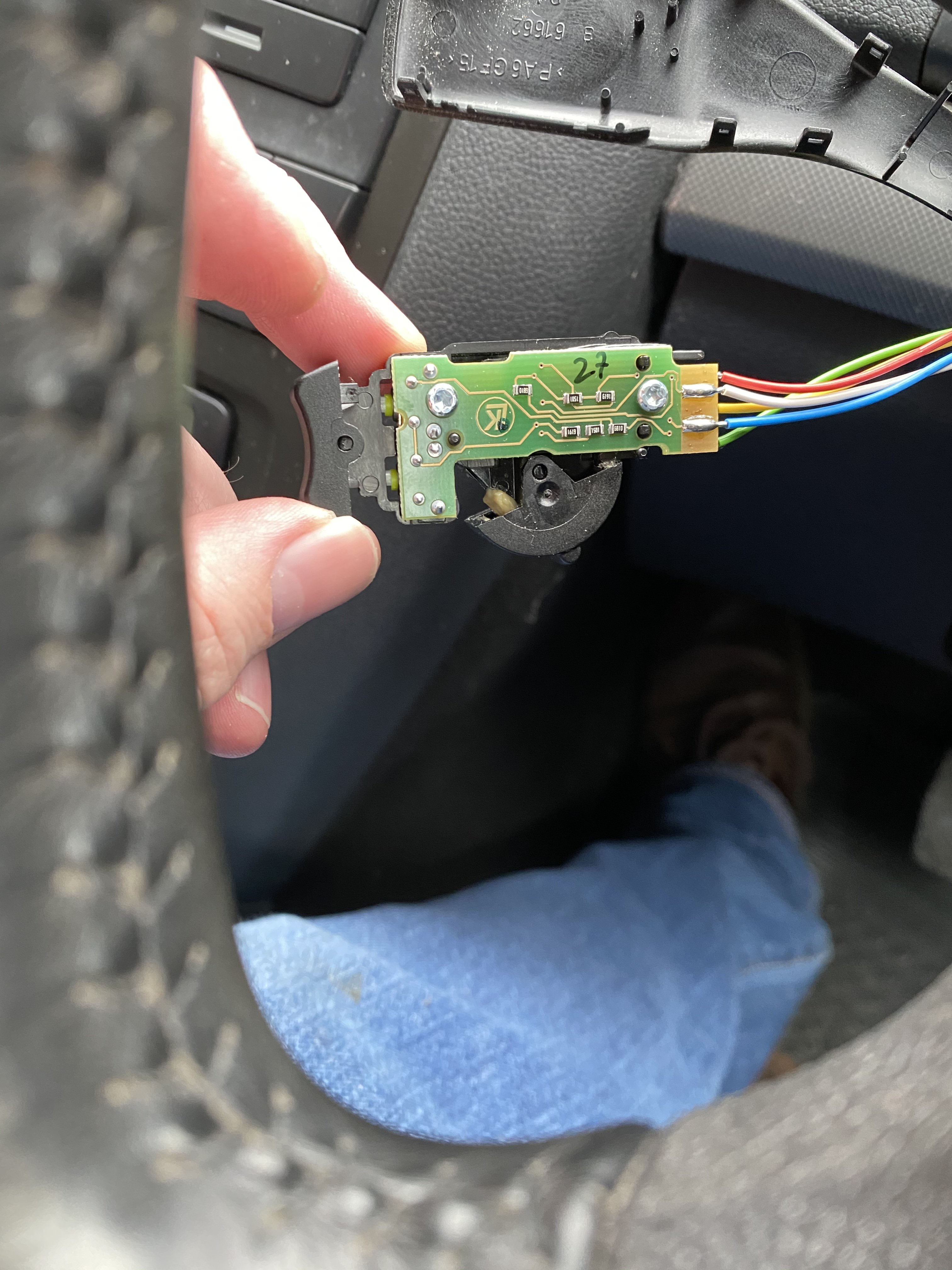

Cruise inoperable is usually an easy fix as common stalk / switch / pcb connection issues well known.
Might even work if you just wiggle the pcb / connector block if it has one.
If not, you could try cleaning the contacts of the switch. Most say this is the issue but on mine placing extra solder on the mini pcb contacts, inside the stalk, so that there is a better connection here, has cured mine.

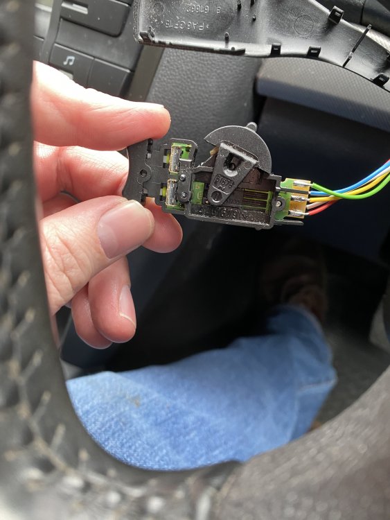

So my cruise switch doesn’t appear to have a ‘connector’ as such.
is there supposed to be some indication on the dash that cruise is ‘armed’?
@bigyorkshire I cannot remember if there is a dash light.................If there is, it is tiny, but i do not think there is on my Octavia.
Yours is slightly different to mine as your wires are soldered directly. Mine had a little plastic connector.
Just clean the contacts on the switches with Isopropyl alcohol and try it next time you go for a run.
If still not working then I would suggest clutch switch maybe faulty. My A4 one was and a replacement switch sorted the cruise on that.
Good luck with it.

Thanks @Tilt I’ll give the contacts a clean.
Clutch switch won’t be there.. it’s a DSG, could the brake switch be an issue? (Brake lights work fine...)
Could be........I knew what I meant as I have DSG too. Still a clutch switch imo so clutch / brake switch, yeah.
Most likely clean the contacts though in stalk and it will work...........hopefully.
Both switches / rocker and slide switch.
Edited by Tilt
Cheers muchly @Tilt I’ll let you know how I get on 👍🏻
