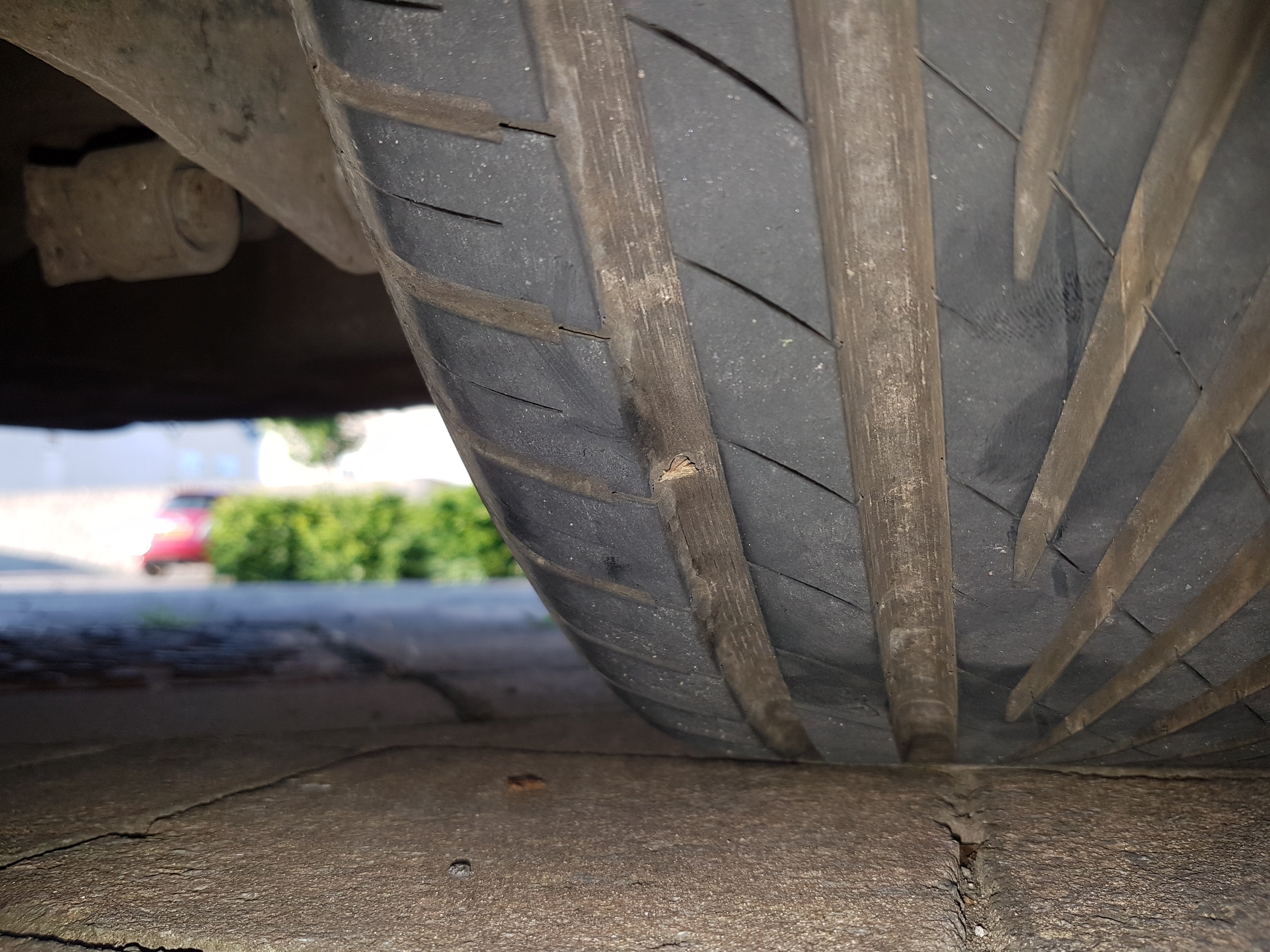

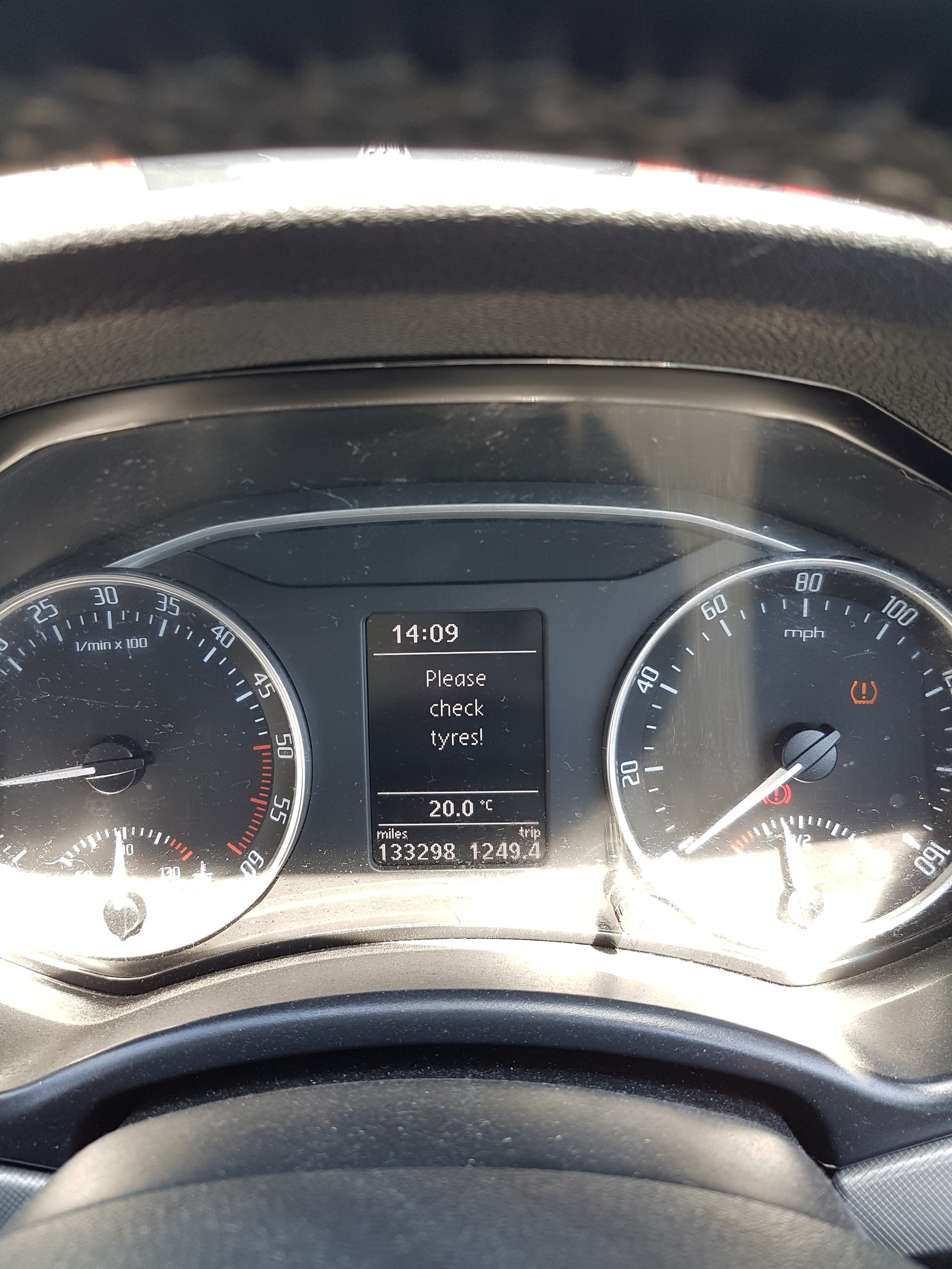

I have indirect TPMS in my car and one of my tyres recently picked up a slow puncture thanks to a nail. I have no idea when the puncture happened but when I checked the pressures the affected tyre was at 1.8 bar (a 15% drop from the normal 2.1 bar) and that was after I had driven 20 miles with the pressure warning on the dash. Even with that tyre 15% lower than normal I could not tell by eye which tyre was deflating without putting a pressure gauge on all four. At first I thought it was a false warning from the TPMS but alas it was not.

Cheers. Was a nail in the end.

The thing is you never mentioned in the OP that you had a warning.
So how much had the pressure dropped from the pressure when you set the TPMS to when you got a warning?
I would estimate that the tyre lost app 10 psi before the TPMS activated. Certainly a good safety measure
