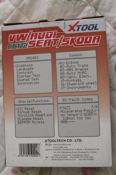

I am attaching a pic of the VAG401 Box the gadget of which has saved me some time and expense in the past. A recent update of the software and another check in the ODP port produced a fault on the Air-con which read "Recirculating air flap motor false positive" sorry but I should have written down the fault code before clearing it! Anyhow it hasn't made any difference the A/C light still refuses to come on and the system understanderbly isn't working.
