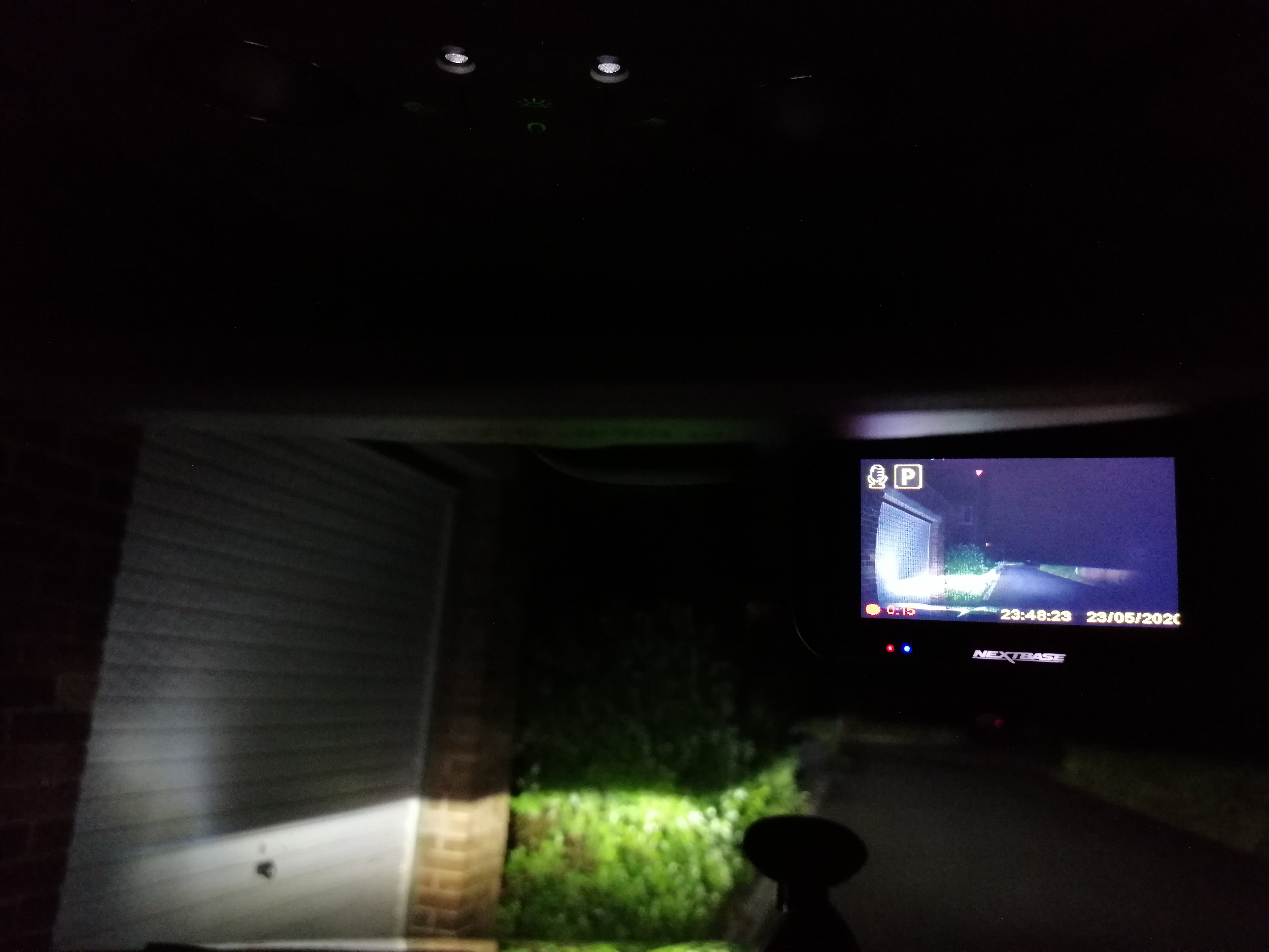

Fitted, quite a straight forward job, it works fine, thank you all for your comments.
