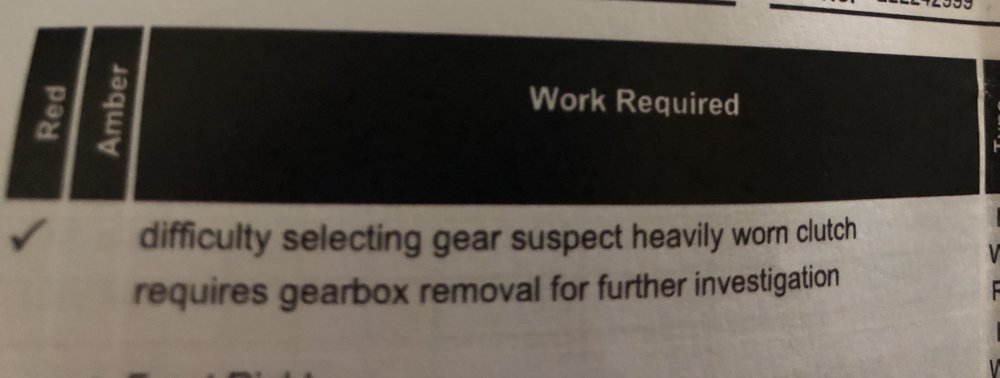

Latest is the Yeti has been in for its service and brake fluid change and they saying that it sounds like the clutch is worn from heavy use
£324 to strip the gearbox down, + cost of parts (unknown how much or what’s needed so couldn’t give me a ball park figure) + the cost of putting everything back together probably another £324
now not sure whether to get them to do it seeing as the earliest they can get me booked in is July 12th and no courtesy car as their are none available until 27th July  or take it somewhere else
If they say its caused by the clutch being worn why are they quoting to strip the gearbox down?
Sorry Urrell .. got mixed up the £324 was just to remove the gearbox not strip it down
Edited by Davemc67
Why itemise £324 to remove the gearbox when its a clutch change?
Did they not quote for clutch replacement, or is that their way of breaking the job down to maximise profits.
Edited by Urrell
What they said was that’s how much it would cost to remove the gearbox to find out what’s wrong, then the cost of parts and then the cost to put it all back together again.
like you say breaking it down to maximise profits
ive decided to take it else where, and get them to take a look
