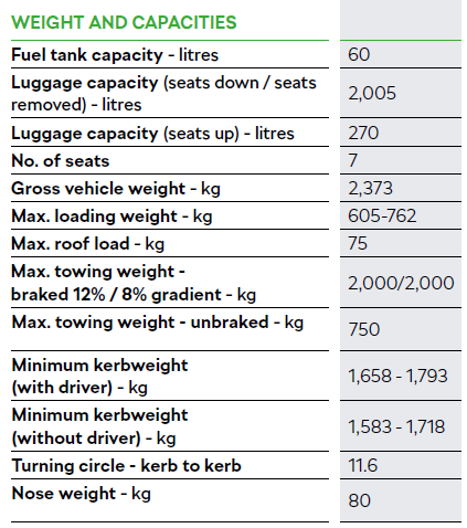

For many years this included the driver, and for many manufacturers it still does, but at some point Skoda changed to not include the driver.
Skoda provide two kerbweights, with and without the driver...
My Kodiaq has a kerbweight (with driver) of 1,793kg.
I tow a single axle Bailey Pursuit with a MTPLM of 1,374kg, this puts me at 77%
With its relatively small 1.4 TSI engine, manual gearbox and 250Nm of torque it tows really well...

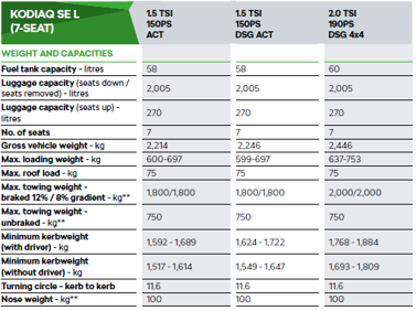

Where does 1793kg come from? The 1.5 manual on your attachment has a max of 1689kg.

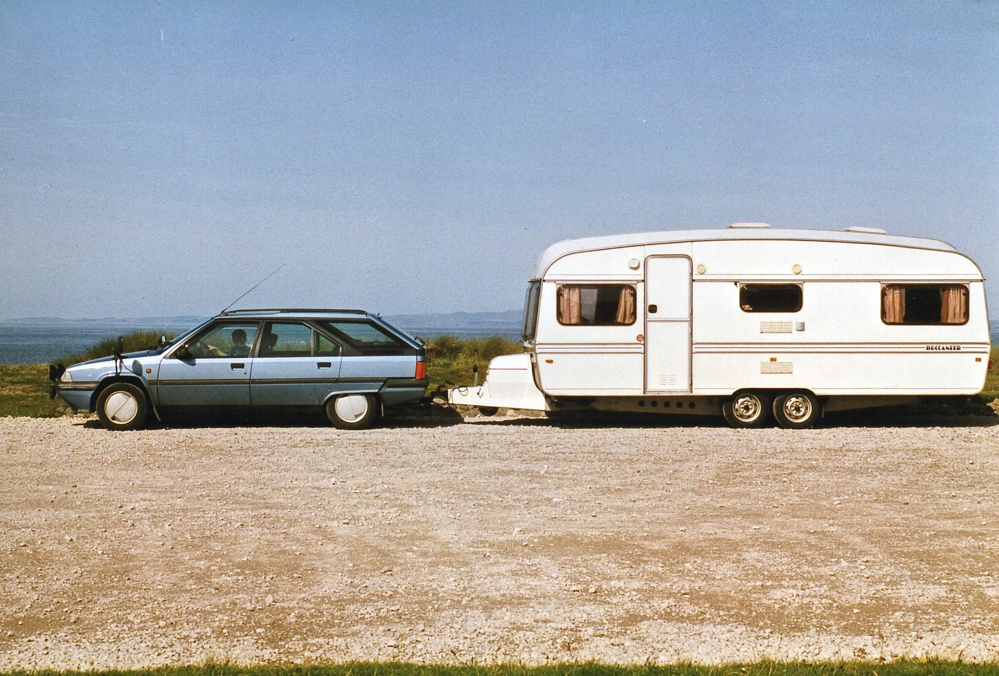

In the early 90's, I borrowed this caravan for a week and took my two kids to the Lake District.
The BX sailed up Lakeland passes with this on the back on only 90 bhp and 133 lbs-ft.
I did get some incredulous looks in caravan sites, though.  😀

The minimum kerb weight (with driver) for my Kodiaq (1,658kg - 1,793kg) was taken from Skoda's Pricing & Specifications brochure (which annoyingly they stopped producing in 2020) dated from when my Kodiaq was delivered (2nd quarter of 2018)...
My wife's Beetle has the same 1.4 TSI engine and it is nippy enough. I find it astonishing you're using it to move all that lot!
My earlier attachment was to illustrate that Skoda provide kerb weights both including and excluding the weight of the driver, it was for the SE L and was from a relatively new brochure so not related to my car, apologies if this caused confusion.
My Kodiaq is a 1.4 TSI Scout, the specs (including the kerb weights) highlighted above.
The 1.4 TSI has 150PS, the same as the most common 2.0 TDI diesel engine fitted to the Kodiaq, albeit it has only 250Nm compared to 320Nm of torque, which arguably is more important (or at least as equally) as horsepower for when towing. Whilst steep motorway inclines do require some forward planning and a gear down change I am a steady driver, especially with a caravan on the back, and so the 1.4 TSI is more than ample to pull the caravan around at speeds under 60mph, but even more so at the more common speeds of around 40mph to 50mph.
