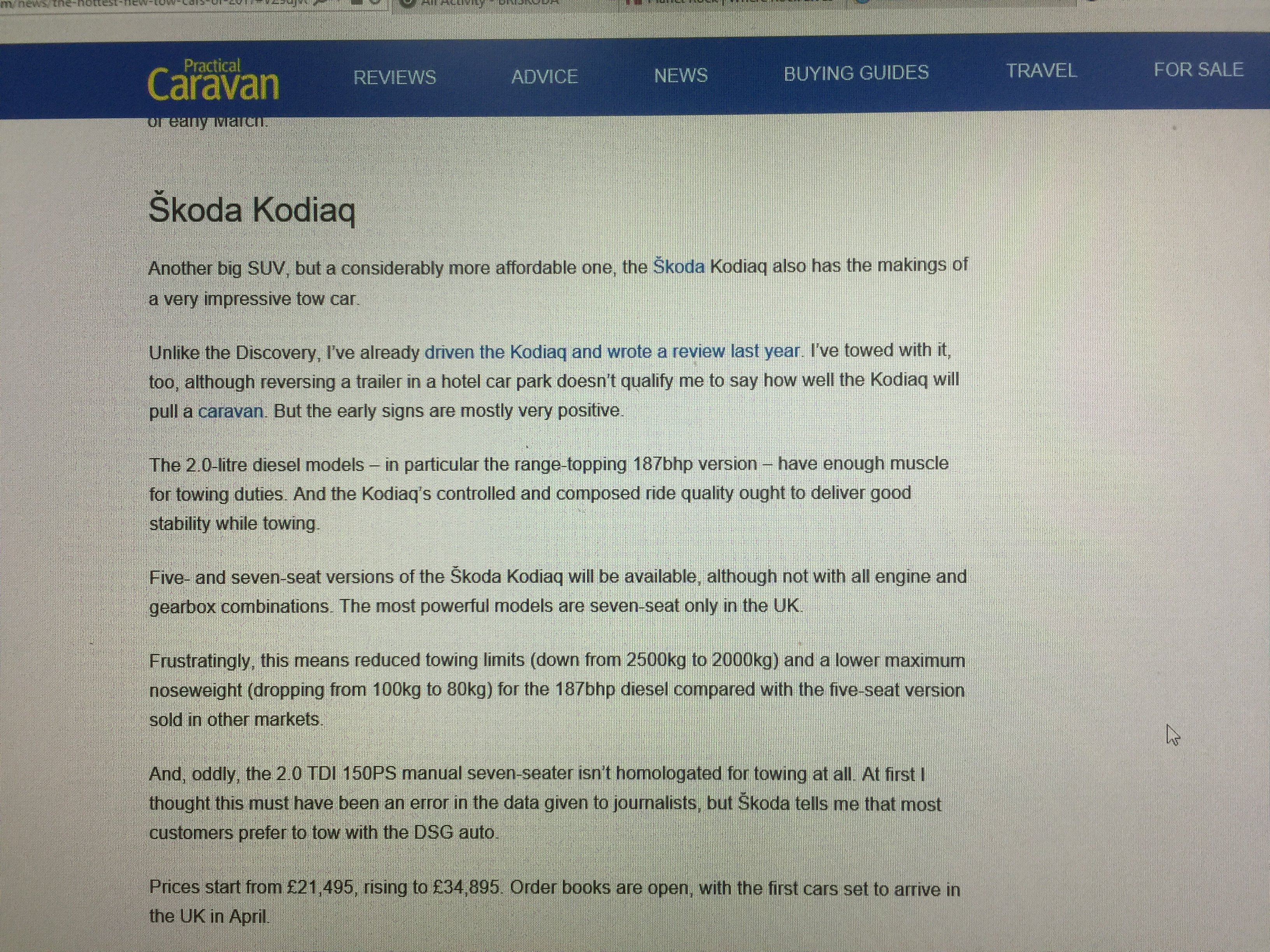

Practical Caravan suggest the 5 seater Kodiaqs can tow 2,500kg with a 100kg noseweight however 7 seaters are limited to 2,000kg with a reduced 80kg noseweight.:thinking:

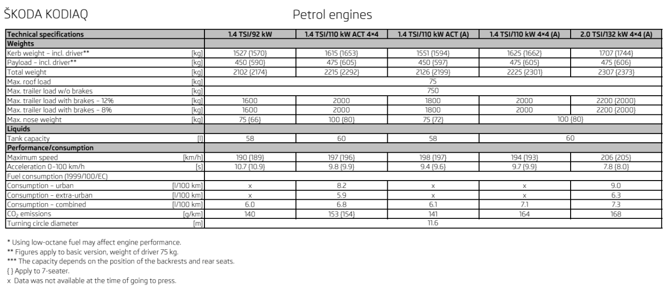

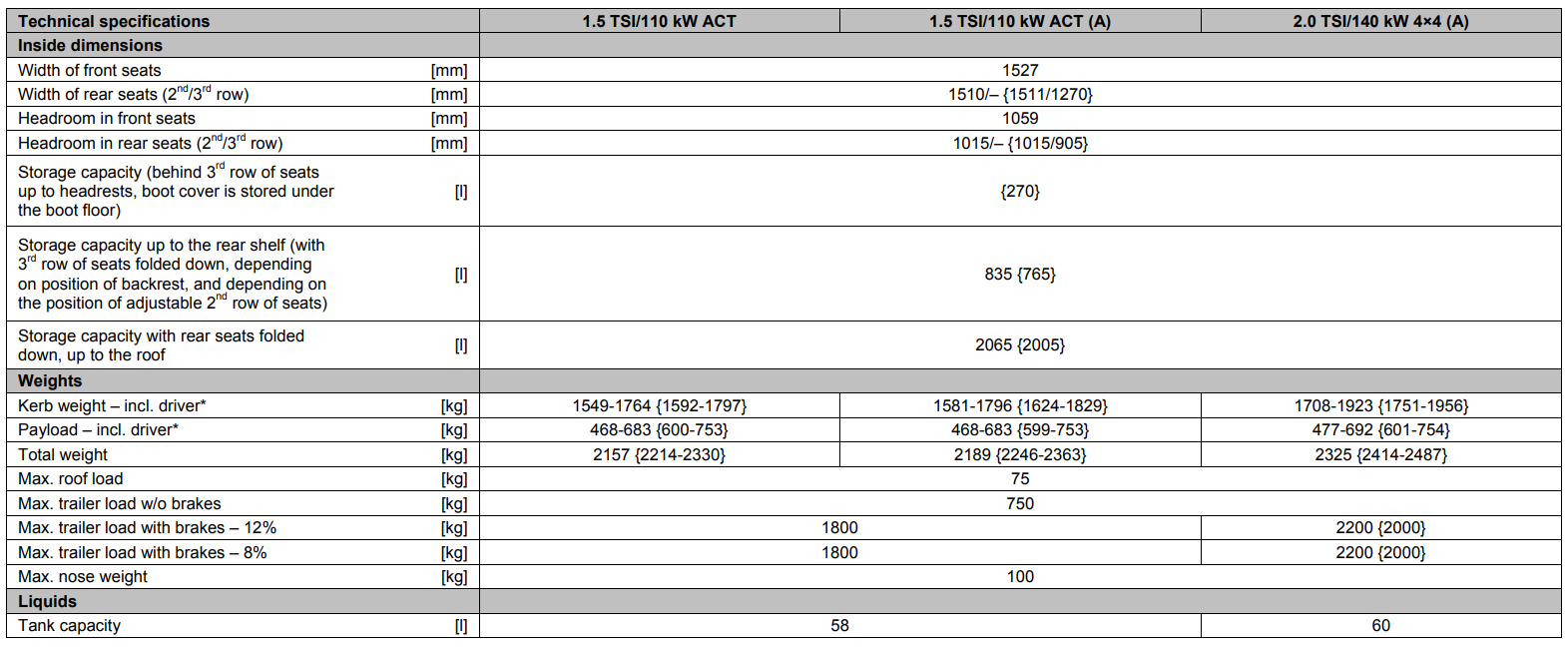

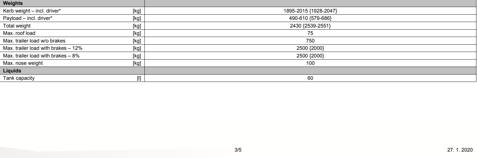

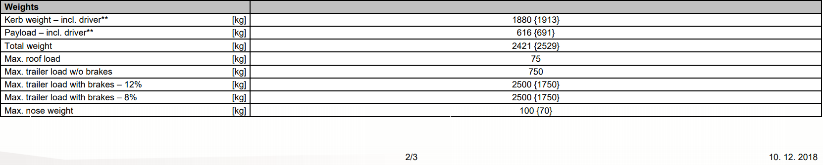

Petrol range from 2016 & 2020:

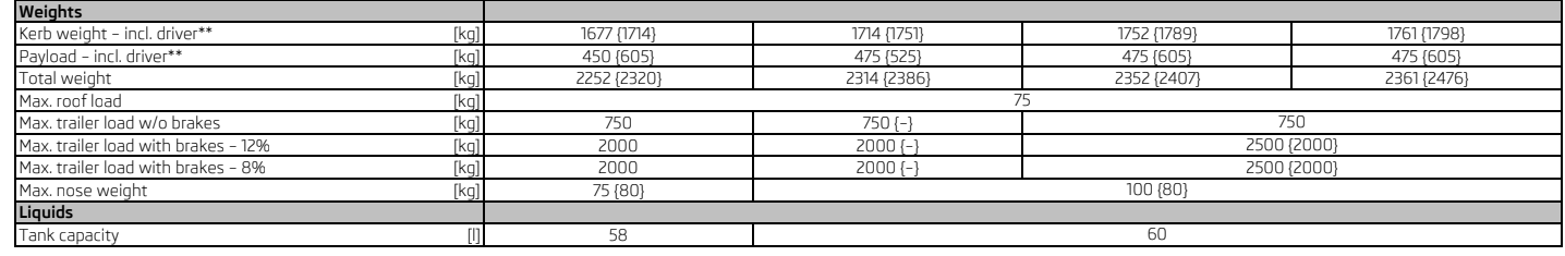

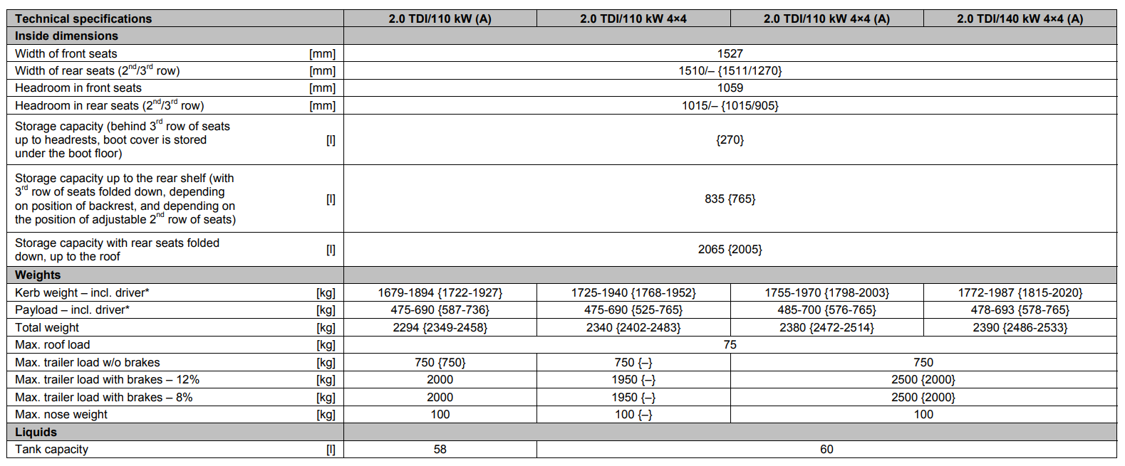

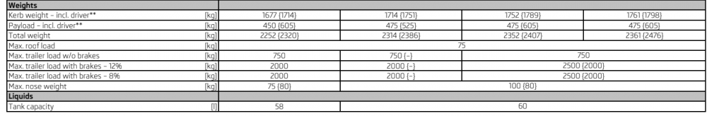

Diesel range from 2016 (150PS manual, 150PS 4x4, 150PS DSG 4x4, 190PS DSG 4x4) & 2020:
Kodiaq RS from 2020 & 2018
image.thumb.png.291a86eef74ea3fc835a67f2d145b248.pngimage.thumb.png.8f60beb79f90711353c1a870291b2d70.png
Kodiaq RS technical details said 2300kg @ 12% for the 5 seaters (1575kg @ 12% for the 7 seater if equipped with sunroof!) around mid-2019, as I asked Skoda NZ about official towing weights as they listed 2000kg for both 5 and 7 seaters when I was ordering. Annoyingly I don't have a screenshot of it.
Otherwise for standard Kodiaq, Practical Caravan’s figures are mostly correct apart from 7 seater tongue load capactity which is all 100kg now according to Skoda technical details. I also don't know why Skoda UK say the max braked capacity of the SE 150PS DSG 4x4 is 2300kg when technical details show 2500kg - is this due to local rules?

The article I read.
@shyVRS245
Is that article from 2016 before they arrived in the UK in 2017?

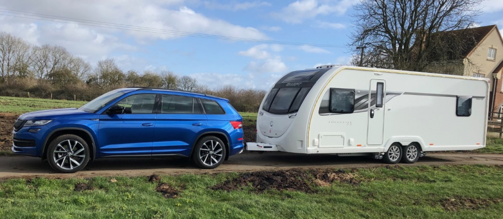

We got our Kodiaq at the start of the year its the 190 DSG same as yours and it pulls out Swift twin eb really well, we had a Tiguan 150 DSG before which was good but the extra power is noticeable on hills etc.
