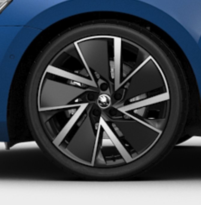

Has anyone got any suggestions for which wheels look good and hide the hubs/discs?
Skoda's Vega Aero Anthracite from the Superb?

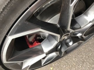

A shot of this...
Delivers this...
Much cheaper than new wheels too 😂
