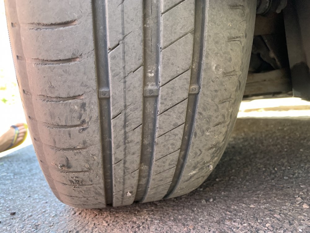

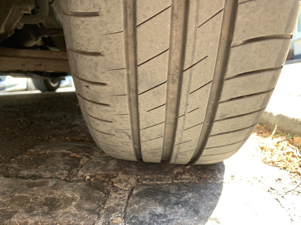

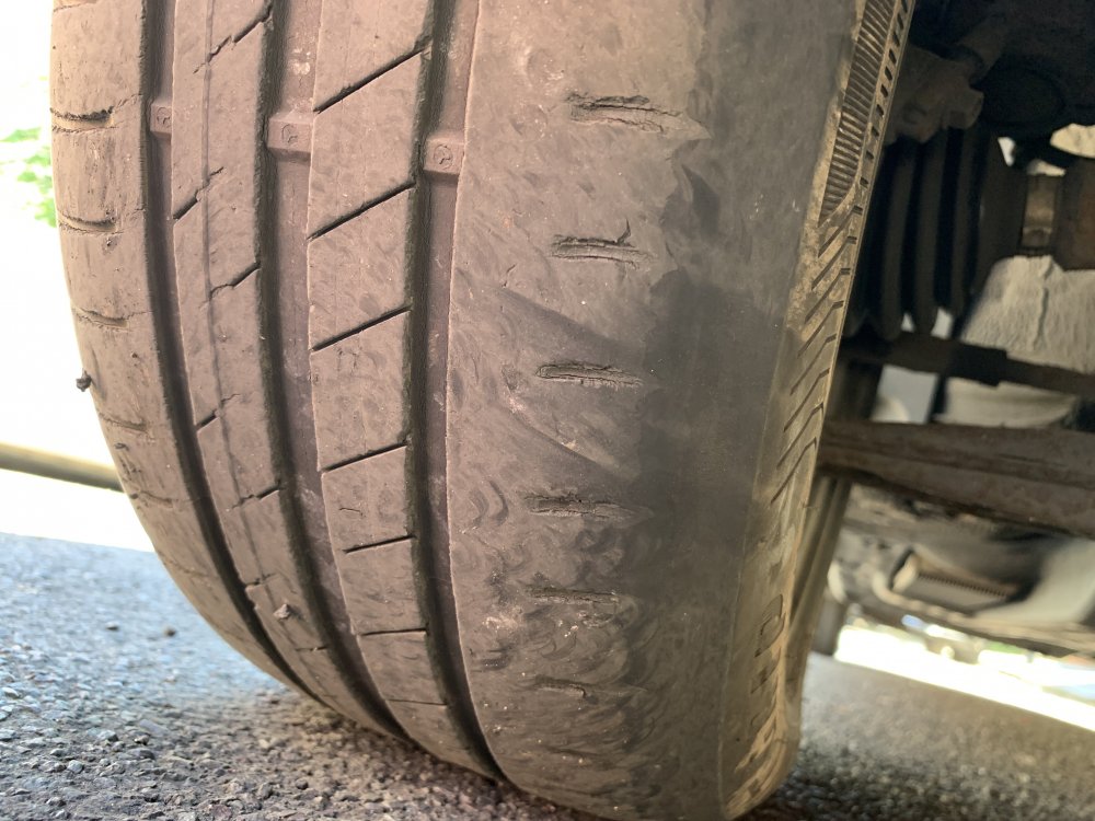

Apologies - I just went back and double checked! It is definitely the INSIDE edge that is particularly worn on the OSF.
OSF:
And the NSF looks fine:
Both are Goodyear efficientGrip.
Edited by Oli3000
Option 2 is the correct course of action.
The same position tyre on my car wore like that; there was no indication of anything wrong with the steering but having the tracking checked and adjusted sorted the problem.
