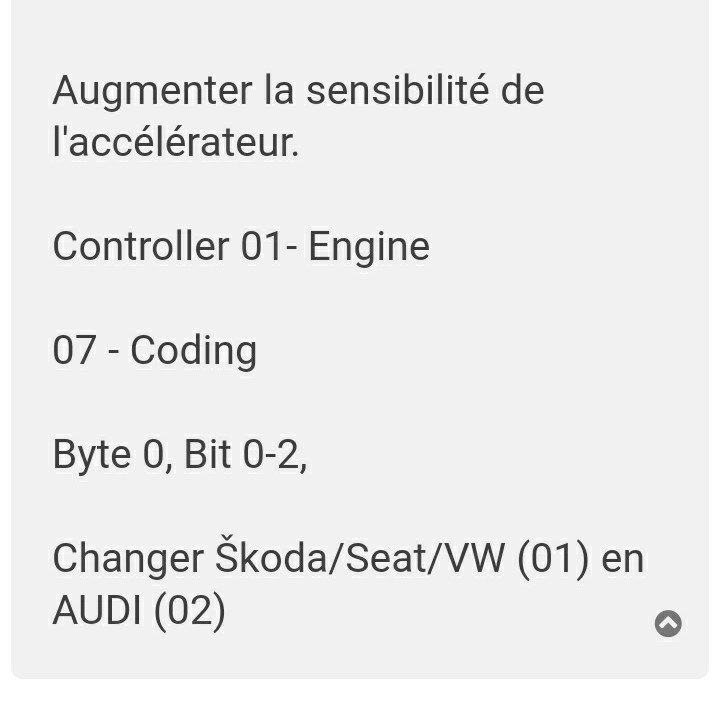

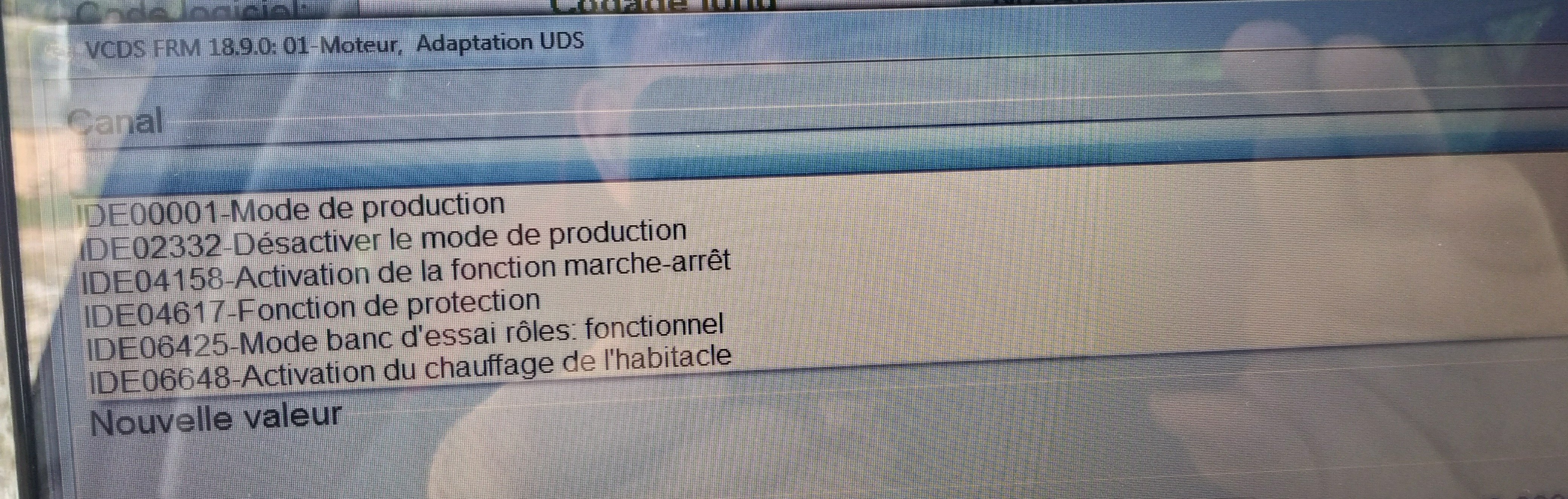

I found the engine access code but apparently I don't have the option, I have to do it in another way, but I don't know how to do it, I saw for golf 7 but not for skoda  (with long coding)
I found this other way to change the sensitivity of the accelerator, but I do not know if it is the right method for skoda ???
