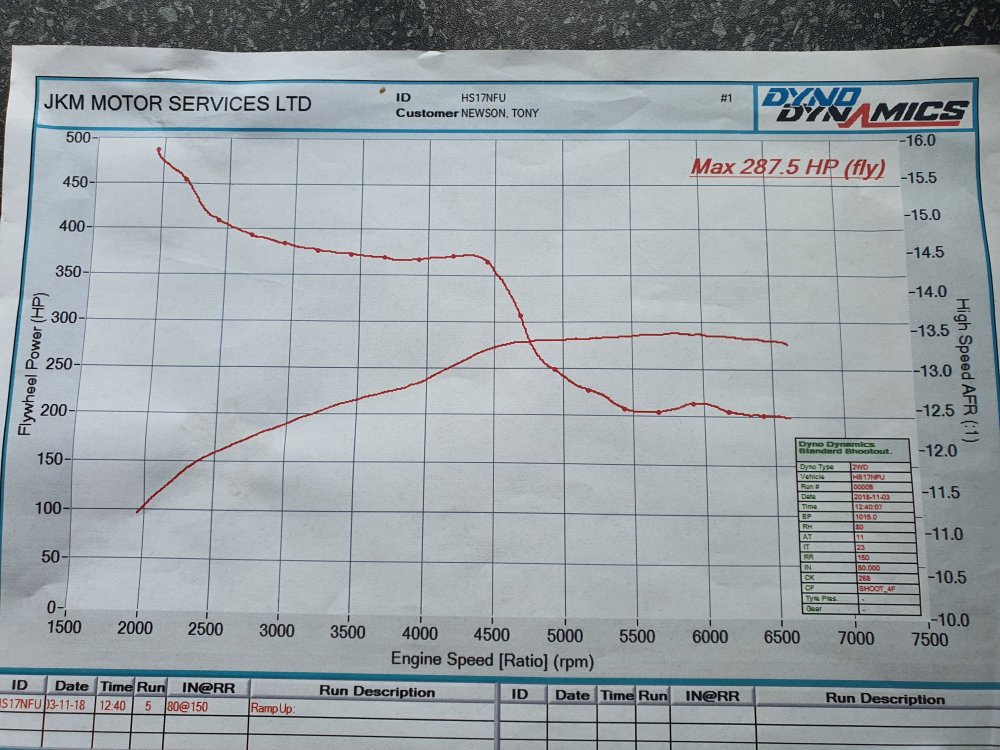

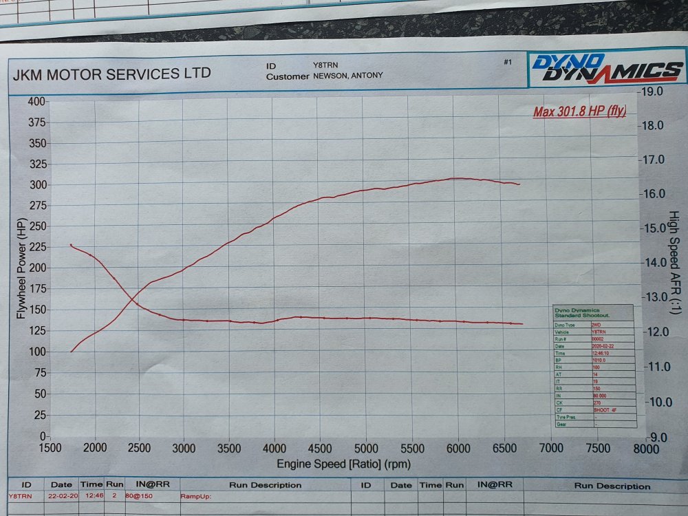

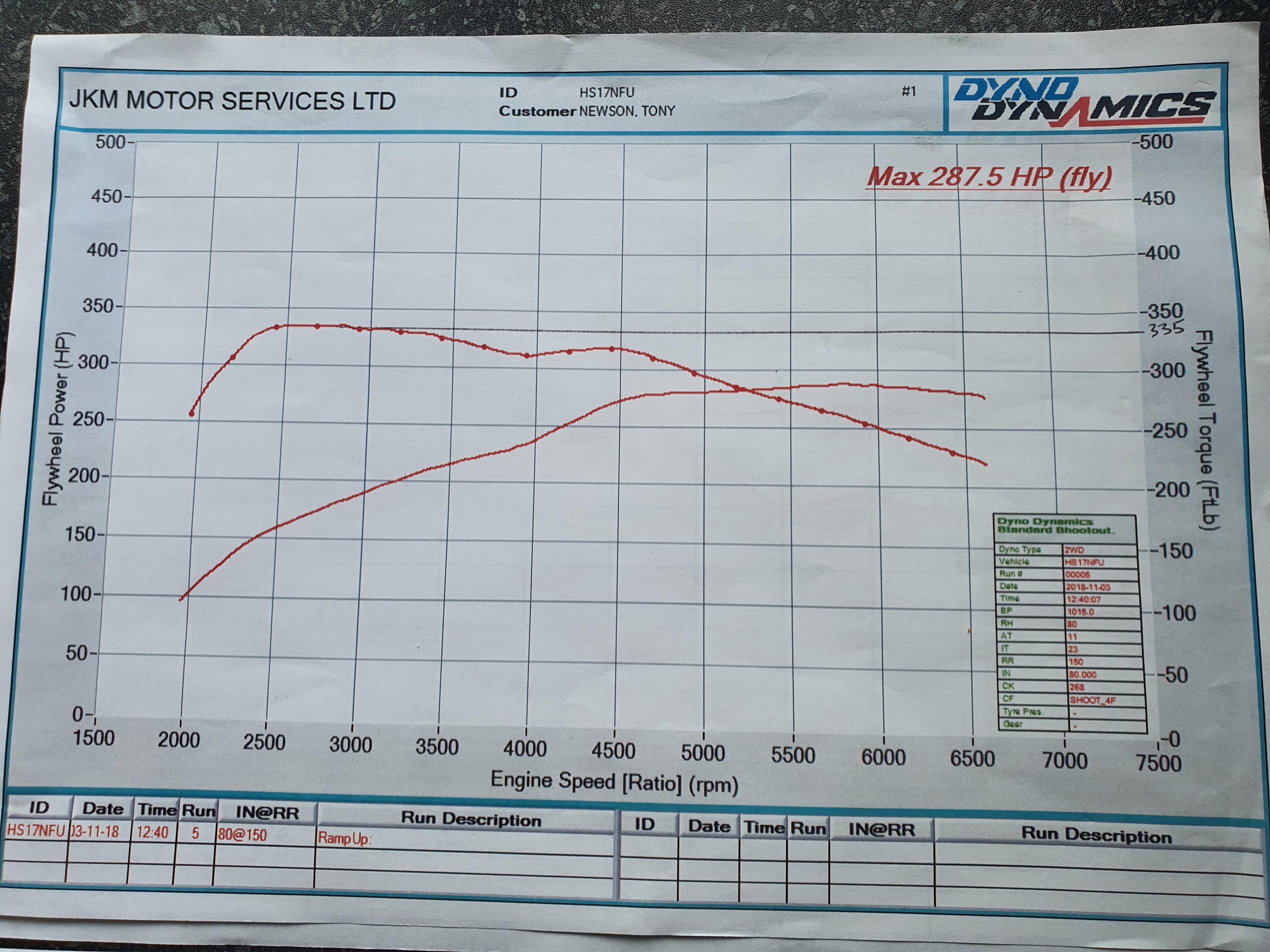

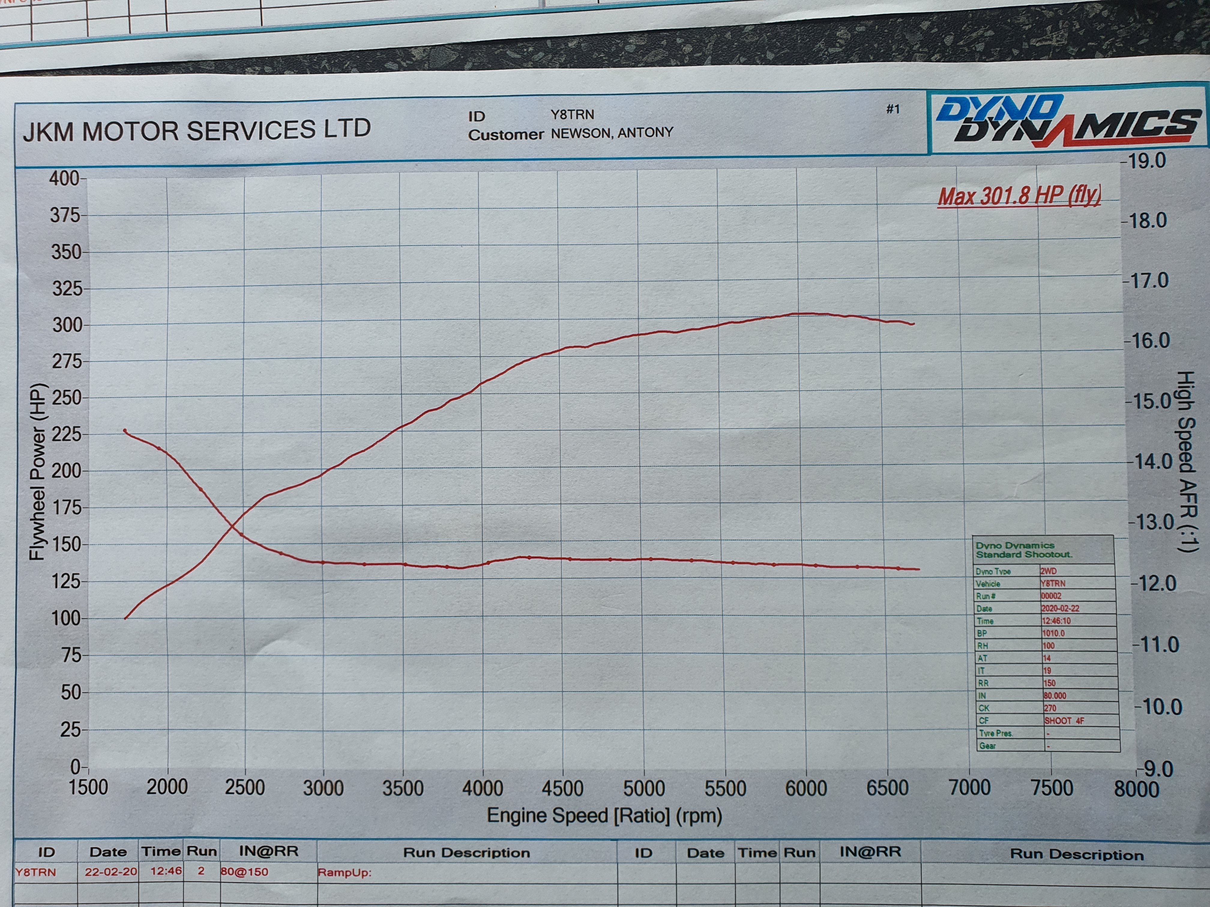

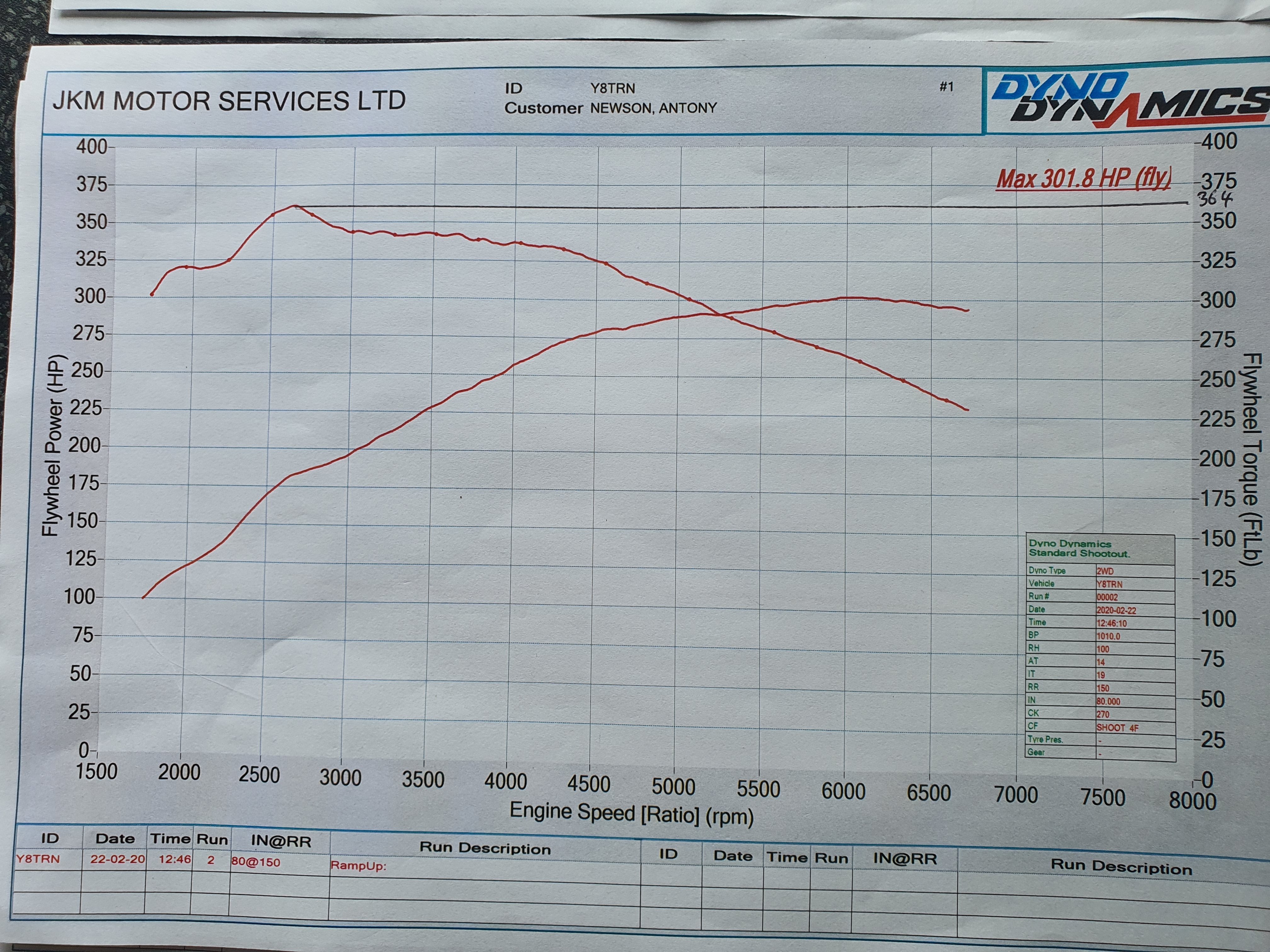

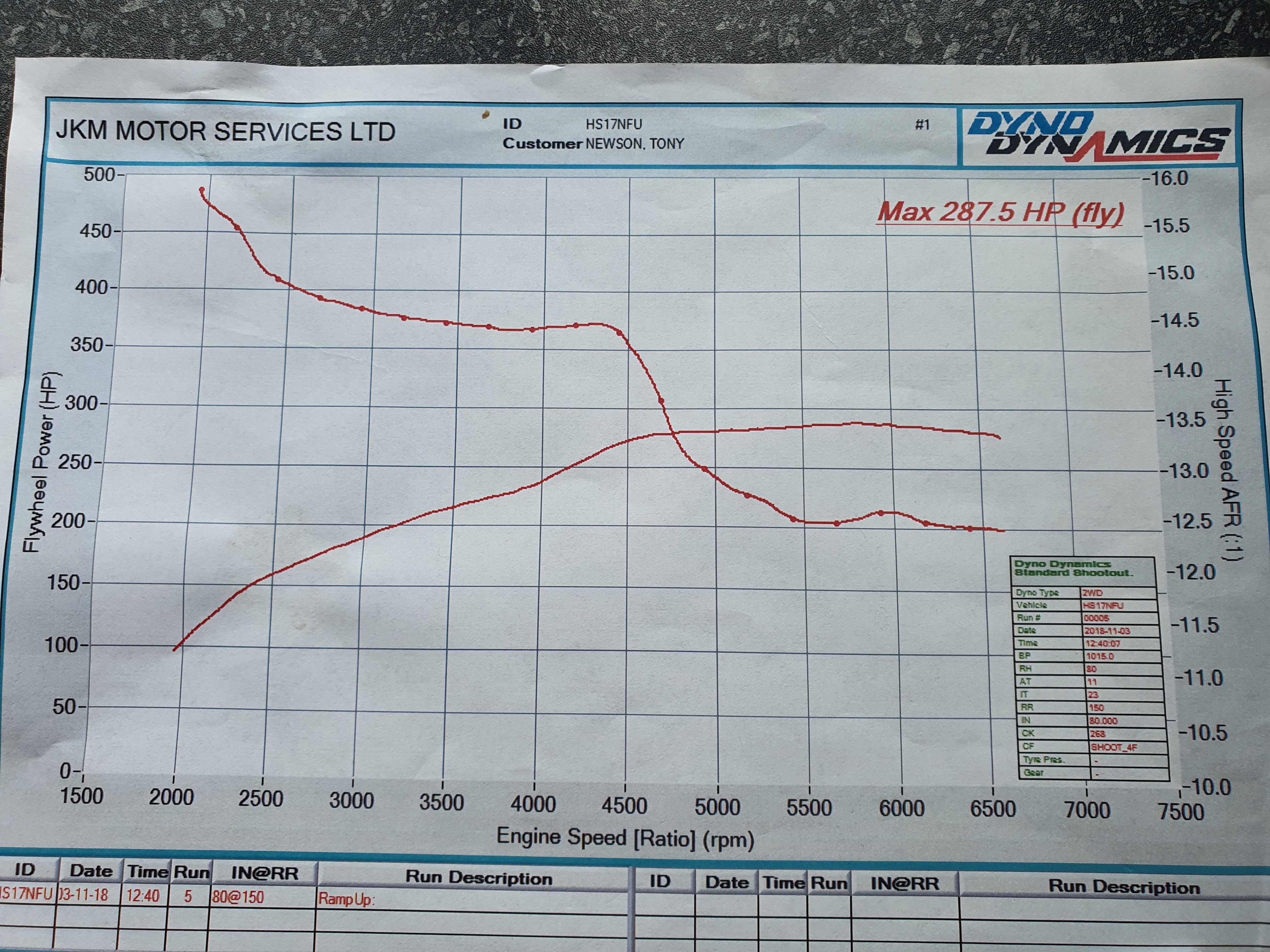

Below are the JKM Portsmouth dyno printouts for both the DTUK tuningbox & the Revo Stage 1 map. Both produced smooth power delivery with the air fuel ratio being the only noticeable difference between the 2 approaches to tuning, the tuningbox runs the engine a lot leaner & therefore, the engine will run hotter. Long term, this could create issues but, for a shorter period of time it shouldn't be a problem, my tuningbox was on the car for 2 year & about 22k miles.
Kinda depends how safe you wanna be with warranty compared to how quick you wanna be, its a balance & only you can make that decision

Yeah DSG but, i've remapped that too & use the paddles for spirited driving, dunno about the standard torque & power, tuningbox was 287.5bhp & 335ft/lbs, remap was 301.8bhp & 364 ft/lbs so, nicer but not amazing
