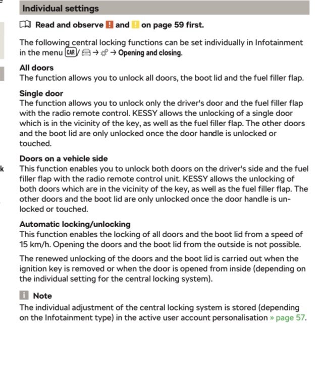

Or if you read the manual, you can change to all doors unlocking or various combinations.
