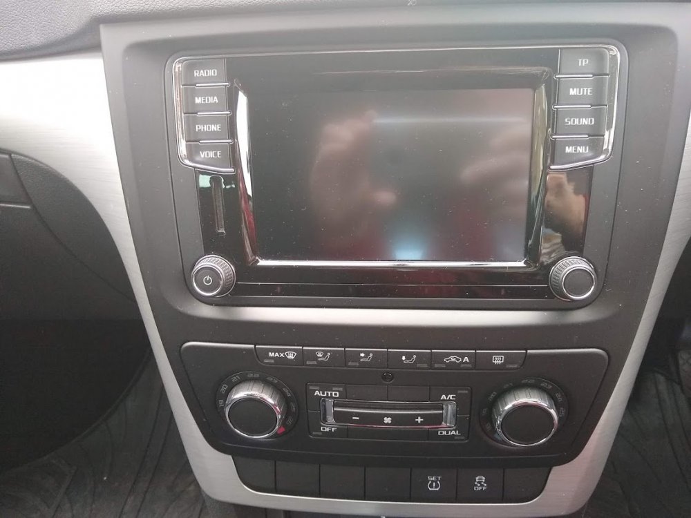

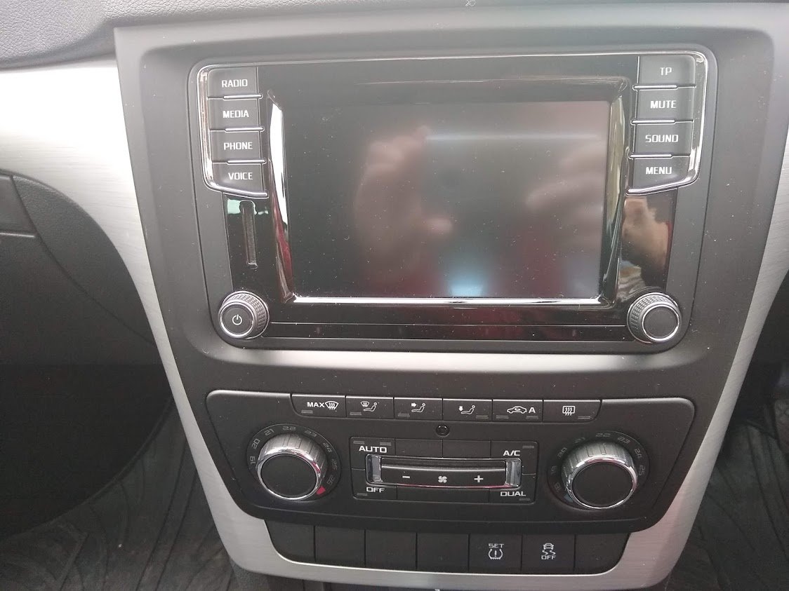

Do you have this RCD style Bolero:
Or this MIB style Bolero:
Yes, I created a second topic in a correct section for Yeti.
This is my Bolero as I can see MIB style. I was not aware that there are two styles. OK more question to Uncle Google.
