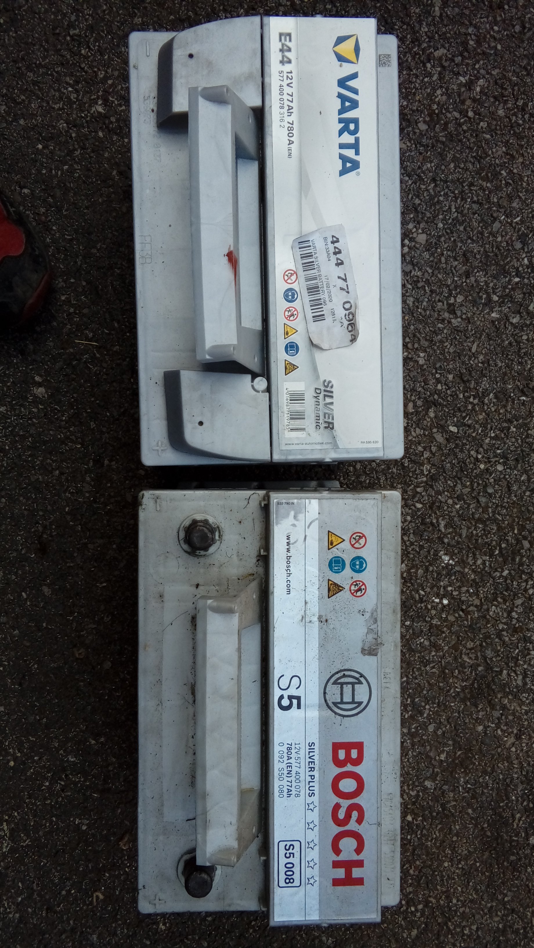

Pic added
Just fitted varta as it was £100 and £40 cheaper than the Bosch s5 previously fitted.
Bigger CCA than needed compared to original
