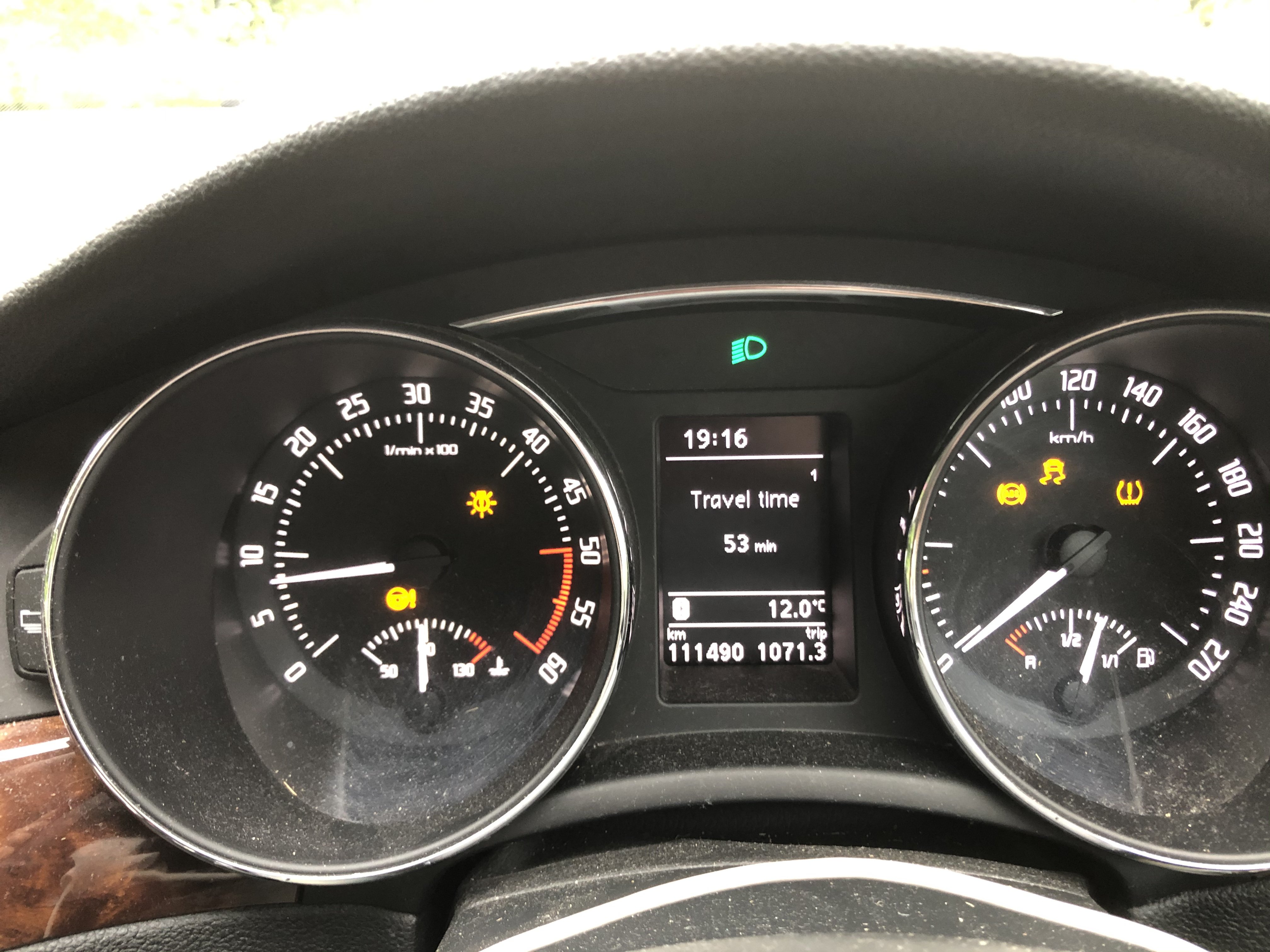

Hi guys,
I've a 2014 skoda superb L&k.  Driving on the motorway a week ago. Bunch of Amber lights appeared on the dash. See pic attached... On the MFD '' ERROR /ABS STABILISATION CONTROL (ESC) ''.  Followed shortly by no park assist and adaptive headlight errors 😬
It dissappeared on restarting.. But returned a day later and is now a continuous fault.
Can anyone shed any light on how to troubleshoot? Checked relays and all seem OK. Also engine running fine.
Appreciate your time

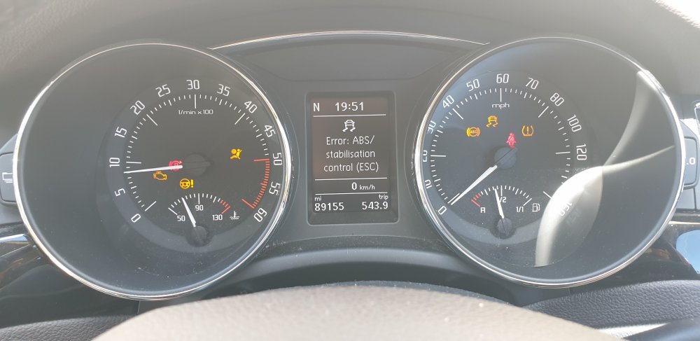

Hi,
I have a similar problem. The car was parked in the driveway for a number of months during lockdown. I went for a short drive about a week ago and a the following indicator lights came on
Electronic Stability Programme
Tyre Pressure Monitoring
Power Steering System
Bulb Monitoring
Anti-Lock Brake System
A message came up to say there is also a problem with the stop start system and the cornering lights. The car also appears to be in limp mode as it won’t rev above 2,500rpm. I tried a cheap error code reader that I bought in Aldi, but it is showing “No Codes”. I also tried a volt meter on the battery and it appears to be fine but the voltage does not increase when I rev the engine. I suspect a problem with the alternator. Anyone got any additional suggestions as to what might have failed  or what might be wrong with the alternator? Thanks in advance.

Thanks J.R.,
I went for another short drive today and it did Rev beyond 2.5k, but the dash is still lit up like a Christmas tree.
