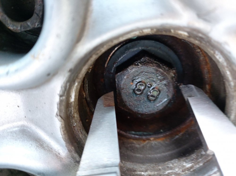

Mk2 octavia is the same as Mk5 golf mechanically,i believe the jetta is the same platform but as micmac said there could be differences with a US spec model. I've removed the hub bolts a few times and they are definitely 27mm if they are a regular 6 sided bolt head, some are 12 point head but I can't remember the size of those, I'm sure someone here will know.
Don't quote me on this but I think the 12 point bolt is either a 30 or 32mm, my car has one of each 6 & 12 point bolts!
I do recall using a 1"/something socket until I bought larger metric sockets.
Another angle you could try is borrowing the socket(s) from a local garage, pay and return type deal.
Edited by MicMac
Thought I'd go out and check on my Skoda its a 27mm 6 sided all around so I bought a 30mm socket for nothing lol
is there a lot of 12 point bolts on the Skoda Octavia Scout MK2 2007  2.0 TDI Estate Engine BMM 103kw 140hp?
Why didn't you do this to begin with!!!?
I suspect most 12 pointers will be engine related, you will need some 12 point triple square keys for the suspension bolts.
No offence intended, I would strongly urge a mechanical savvy friend, preferably with tools & experience assist you.
cuz it was ****ing down here and i had my family pop round I did soon as I left,
I took my 1st engine out when I was 16 years old micmac 56 now so yea i,d say I have been at this a few years now just not with this car, i'am mechanical savvy but as you know most cars these days are different and it cant do no harm to get advice when working on new cars you've not worked on before

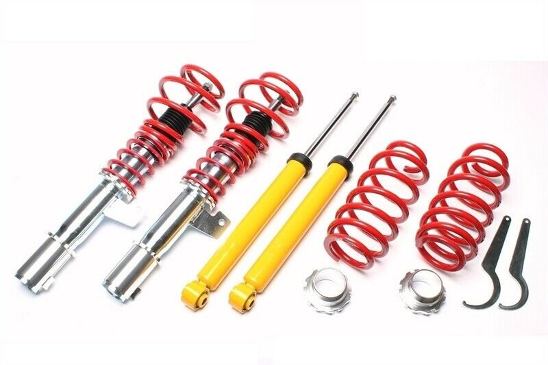

Hi guys well I went and bought a kit and had them fitted but never knew they were more sporty than the original ones and now the ride is a bit lower and though it does handle well bumps seem quite hard.
not sure what to do now keep them on or redo them as am not to keen on it being lower.
Coilovers kit TA-Technix - Skoda Octavia Scout 1Z - Ø55 Adjustable suspensions
EVOGWVW14/55-10
TA-Technix coilovers Skoda Octavia Scout 1Z – Ø55
Coilovers kit for Skoda Octavia
TA-Technix Coilover kit for Skoda Octavia are manufactured using the latest techniques with the highest quality materials and combined with aggressive pricing strategy, taking the performance accessories market by storm.
Skoda Octavia Scout type 1Z year 04- 13
front load: 1190 kg
rear load: 1220 kg
This product is for vehicle with 55mm suspension strut
FEATURES:
Collars Collars and upper mounts made from 6061 aluminum with T6 for increased hardness
Our spring perches, locking collars, top mounts and some lower mounts are made from high quality 6061 aluminum. Benefits include excellent strength and aluminum helps reduce weight.
Monotube coilovers Monotube high pressure design reduces oil leakage
All of our coilovers use Monotube shocks which dissipate heat better, allows finer damping adjustment and requires a more expensive design process compared to twin tube shocks.
Monotube coilovers Adjustable spring perch for height adjustment
Some vehicles have a separate rear shock and spring. In the coilover industry we call this a “hi-low kit”. In this case you will have height adjustment via the spring perch and the lower mount of the shock. Vehicles with this type of set up can still go as low or lower than true coilovers.
Dustboot Dust boot to protect damper seal
Dust boots are standard on all coilovers. We also integrate the bump stop inside the dust boot. This is more efficient and is less likely to crumble to pieces and deteriorate like other company’s designs.s-l1600.jpg.f7ea7a21c1426388b655f93d947e416f.jpg
Just swap them out for normal shock and springs if you don't like them as I won't have too high expectations with a budget coilover kit.
thats what am doing bought some standard ones
