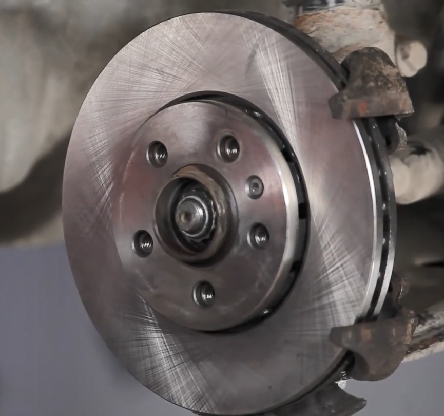

First you post a photo showing a brake disc from an unfamiliar vehicle.

All I can say is I've done the job 6 times on my Octavia, twice I struggled to remove the struts resorting to using spring compressors in situ then I saved time and trouble by removing the driveshaft from the hub as every proper guide shows.
The video depicts a Mk5 Golf as that is what the Mk2 Octavia is based on and Mk2 Octavia videos are limited, I don't know about the Jetta especially a US spec model.
yea your probably right and the fact the video I posted looked like a band new car lol think I will ring the main agents as the main thing I need to know is the size of the hub socket
