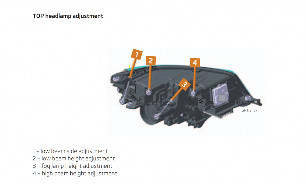

Hi everyone.
Realise a few threads on here about low distance dipped beam headlights prior.  I can't see any that stipulate which of the 4 white adjusters on the back of the LED headlights move the dipped beam vertically and which way to turn it. Anybody done a slight tweak that worked and how please? Realise there is a OBD11 part too but I'm just after the actual physical adjustment for height.

From the Kodiaq General Presentation document:
Excellent thanks. Thought it was number 2 by location on unit so given it 1.5 turns anti clock wise and sorted.
Interesting as has a very large adjuster on outer edge of light units, shown above too as purple also, and no referance to what that does.
