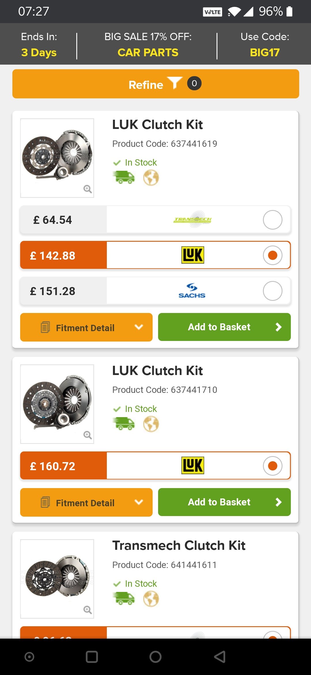

Looking on carparteforless and they have 4 different listings but the description looks the same for all, the searching on here has come back with either a lix or a Sachs kit.
Does anyone know with one I need? Thanks

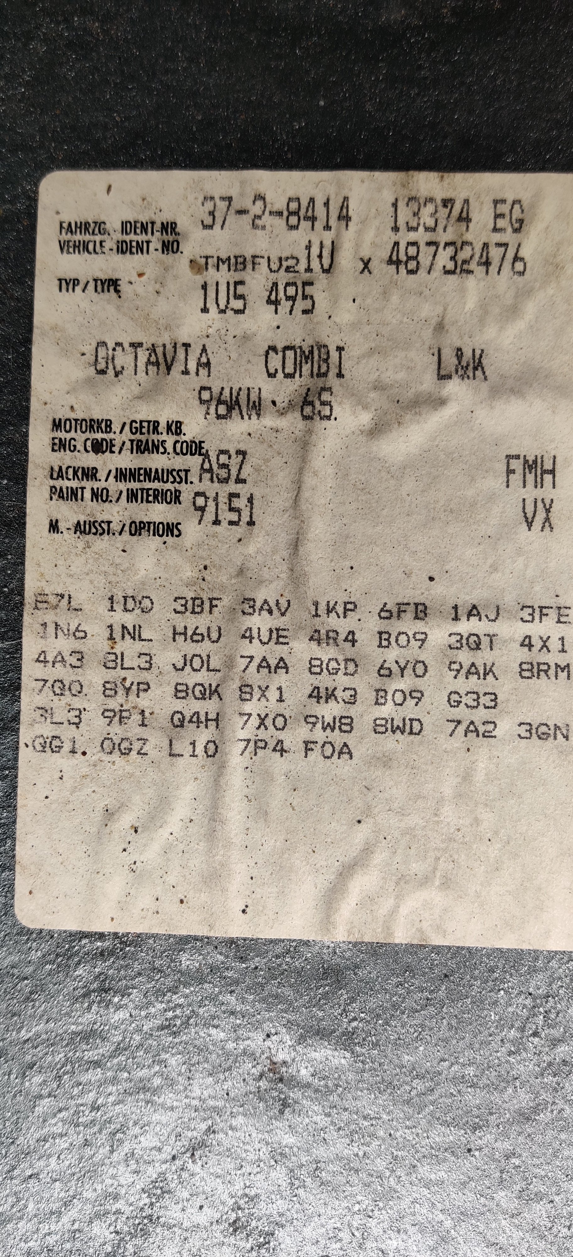

morning,
whats your engine and gearbox code?
Where would I find them?
engine code is on the chassis sticker in the service book and also under the boot carpet. itl be near the top, AGR or ASV something along those lines.
gearbox is too, but i cant remember where.

Looks to be ASZ

Anyone know which one of these I need to order for my car? Thanks
As mentioned before, you'll need your engine and gearbox code to ascertain which clutch kit you need.   From my experience of websites like that, they are all suitable for your car, it's just a question of which manufacturer you choose.  LUK or Sachs are the two main ones for OE quality I'm lead to believe.
Edited by CrazyL
sorry, i never came back this!
gearbox code is FMH - 02m series gearbox
engine code ASZ
