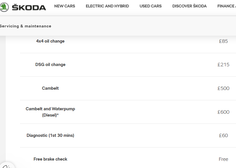

I've been quoted
  • Cambelt Kit & Water Pump - £491.09 inc VAT, Parts & Labour.
Is that reasonable? Skoda want £549

For an extra £50 I would go main dealer unless you totally trust your garage as people have been known to do them wrong.

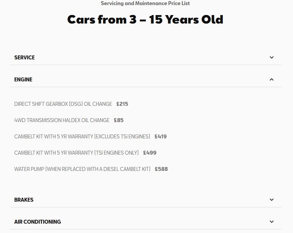

Not relevant for this forum but interestingly SEAT UK recently announced a 5yr parts and labour warranty for cambelt service. I wonder if that'll only applies when fitted to SEAT badged cars? :thinking:
If anyone is after a cambelt change then it's always worthwhile quoting this SEAT offer - will Skoda match both price AND warranty match?

The reason I suggested the dealer for £50 extra is the 2 years warranty from a dealer when fitting genuine parts.
On a can belt I would say that’s rather useful for such a small cost.
