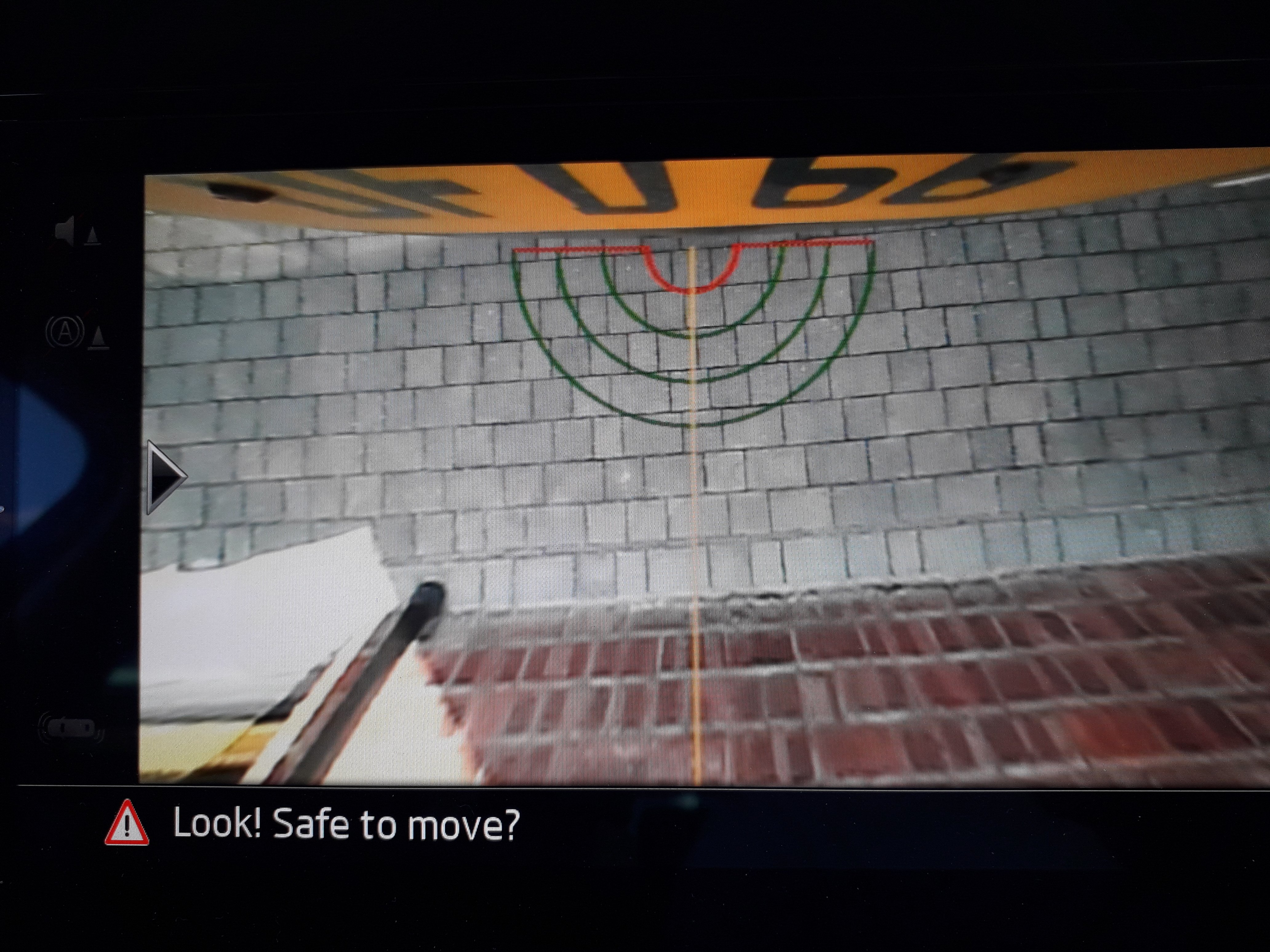

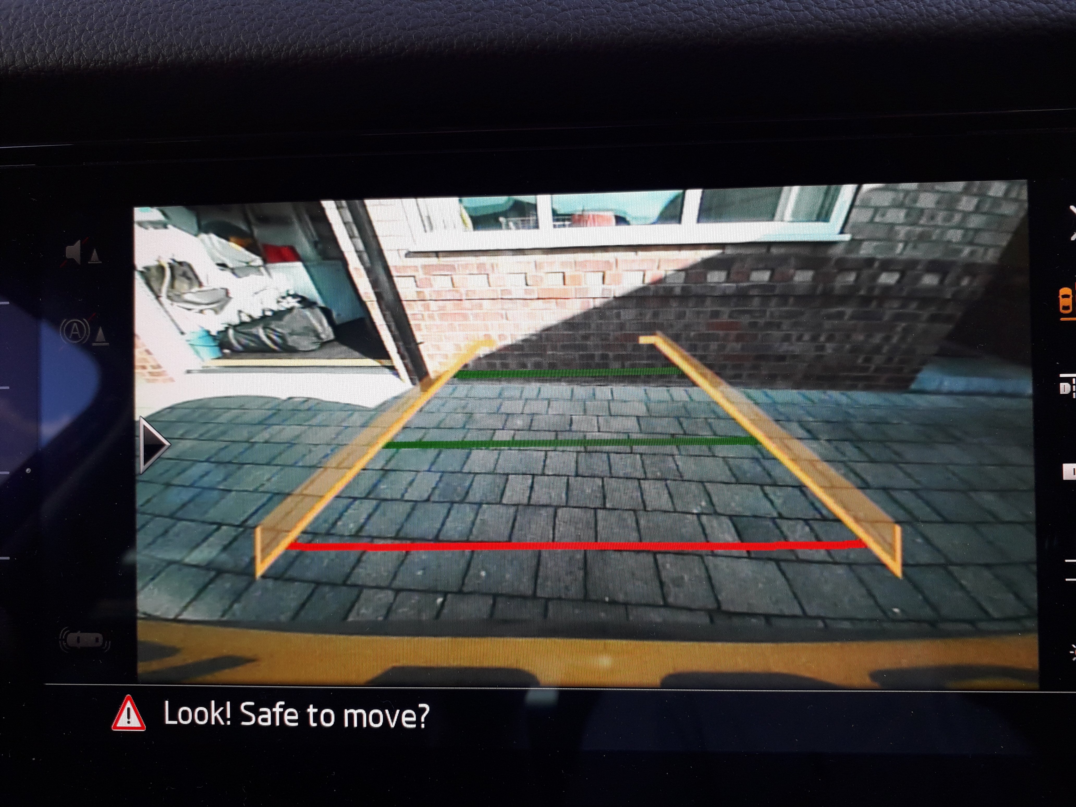

  • That sounds like the parallel parking view. Top button, reversing into space view Second button, parallel parking view. Third , button, towbar view. Fourth button, wide angle view

    The “boxes” are part of the parallel-parking assistance.  The car won’t steer itself, as it would with the full version of parking assistance, but the screen will show YOU when and which way to turn.

I actually towed with it just today, but in the excitement of realising how easy it now makes hooking up I forgot to take any photos, screaming at the wife out the window is now a thing of the past! The birds-eye view (with the tow bar released) is simply brilliant, the yellow line turns with the steering wheel so it literally guides you right to the towing hitch on the caravan, no exaggerating it's centimetre accurate. The tow bar is stowed in this picture but with it out it is easily visible on the screen...
When the steering wheel is turned the yellow line bends with the wheels.
Resolution good too, I like the way you can turn it on in slow moving traffic to see what's going on behind.

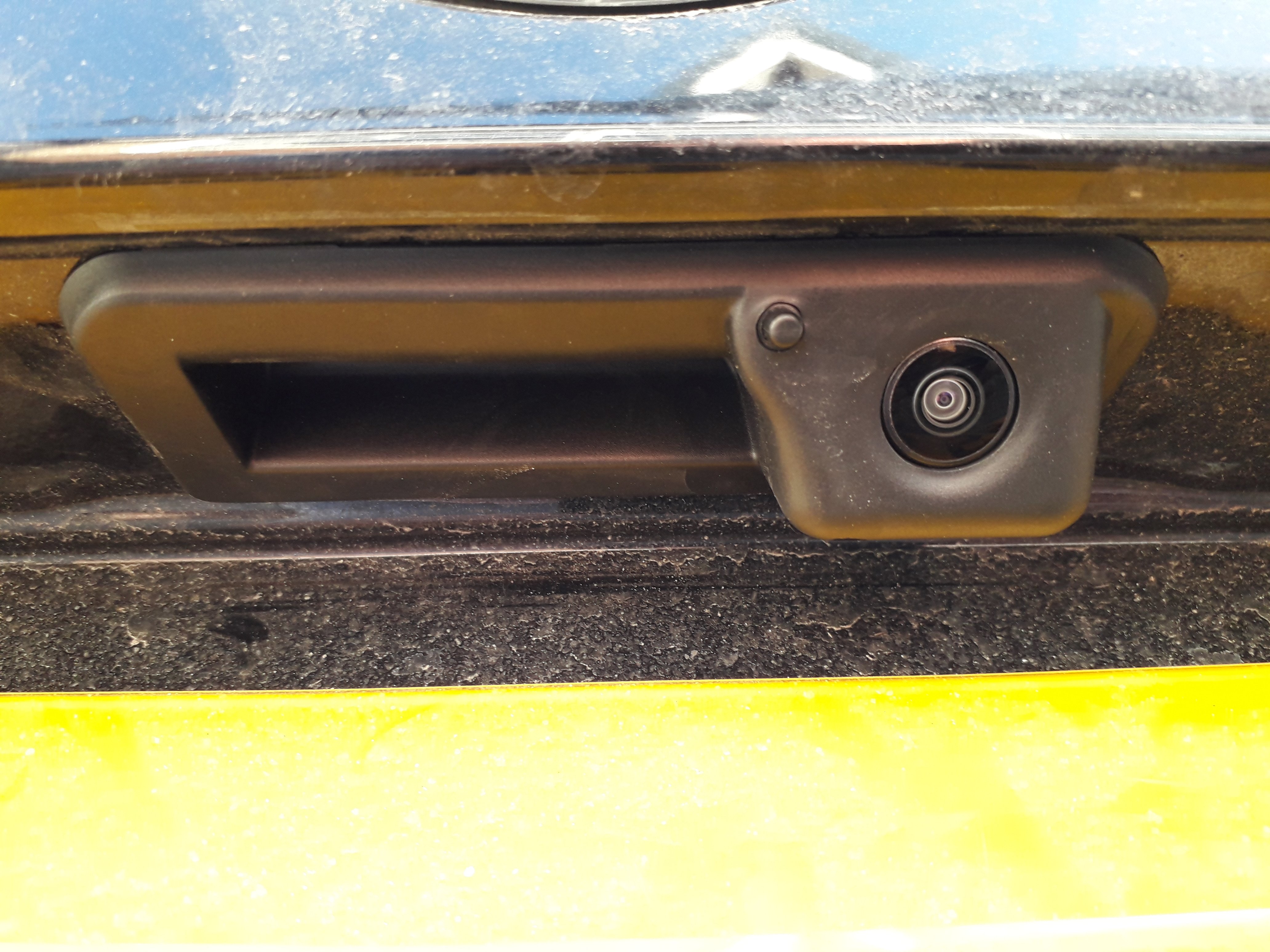

A nice surprise was the fact it also has the built-in washer nozzle, I wasn't expecting this, I just assumed that the retrofit version did without...
Apologies, the car is filthy at the moment!
