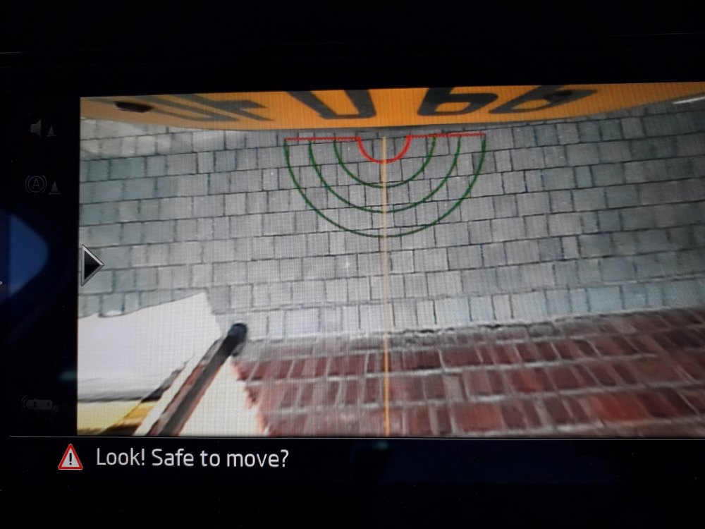

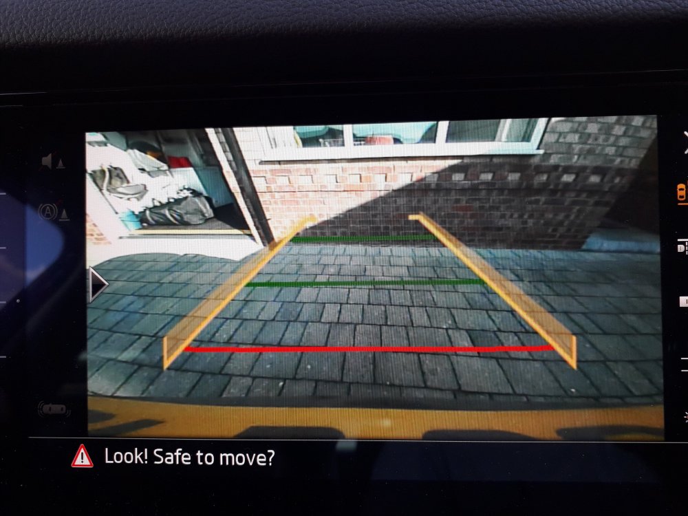

  • That sounds like the parallel parking view. Top button, reversing into space view Second button, parallel parking view. Third , button, towbar view. Fourth button, wide angle view
  • DaveMiller
    DaveMiller
    The “boxes” are part of the parallel-parking assistance.  The car won’t steer itself, as it would with the full version of parking assistance, but the screen will show YOU when and which way to turn.

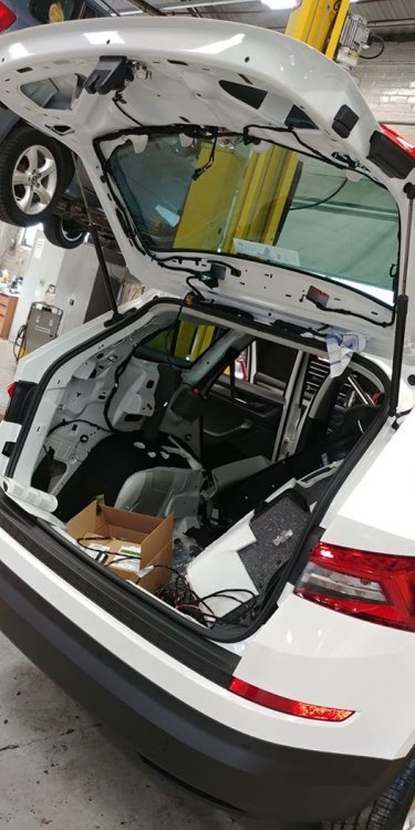

It is all down to the wiring harnesses. The modern MPV skoda cars already have the harnesses installed. It is part of the VW group ease of installation programme that allows for upgrades (and more money for Skoda/VW) long term. They have seen the whole retrofitting thing and want a piece of the action.
The Scout needs the wiring harnesses installed, hence the extra cost. The Kodiaq/Krurock/Kameak range already have the wiring built in, so it is plug and play.
The Kodiaq is certainly not plug and play and requires quite a lot of interior trim removal looking at previous posts in this thread.
Maybe quantifying my last post, most of the loom is in...but it really depends on the spec and wiring harnesses installed.
