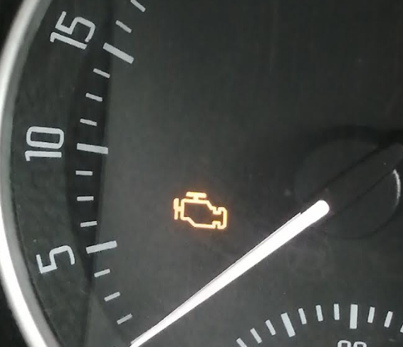

Emissions control warning symbol illuminated
I have an 59 Plate Laurin & Klement 2.0 PD TDi Auto DSG saloon with 150k miles and on a recent trip towing a braked trailer at 50mph all of a sudden the car kicked into limp home mode and would not exceed 40mp at 3000rpm in 3rd.  I made it home no problem.  Unhooked the trailer.  Took the car for a good run (it resets itself out of limp mode when you restart it) and it seems to have stopped happening and has returned to normal.  I am presuming it was the DPF that needed regenerated as my wife does a lot of small trips in this car and think that it was perhaps clogged a bit and needed burnt off.   The warning symbol stays on and was wondering if there was a hack to get the warning light to go off.
Thanks in advance.

That is not the DPF warning light and the engine would not go into limp mode if it simply needed a regen (which is unlikely if you were towing at 50mph as the engine would be lovely and hot).
Are you able to do a VCDS scan, there is probably a fault code stored. In the first month I had my car it went into limp mode 3 times randomly, each time it would clear when I cycled the ignition, I bought a code scanner and there was something about EGR fault which I cleared, and the car has driven perfectly ever since.

could be turbo overboost from sticky vanes
the light on your dash is the engine management if you plug a scanner in it'll tell you the code and then you can work out the fix from there.
I agree that it shouldn't be DPF related.
Must be scanned. Otherwise it will be just a guess.
