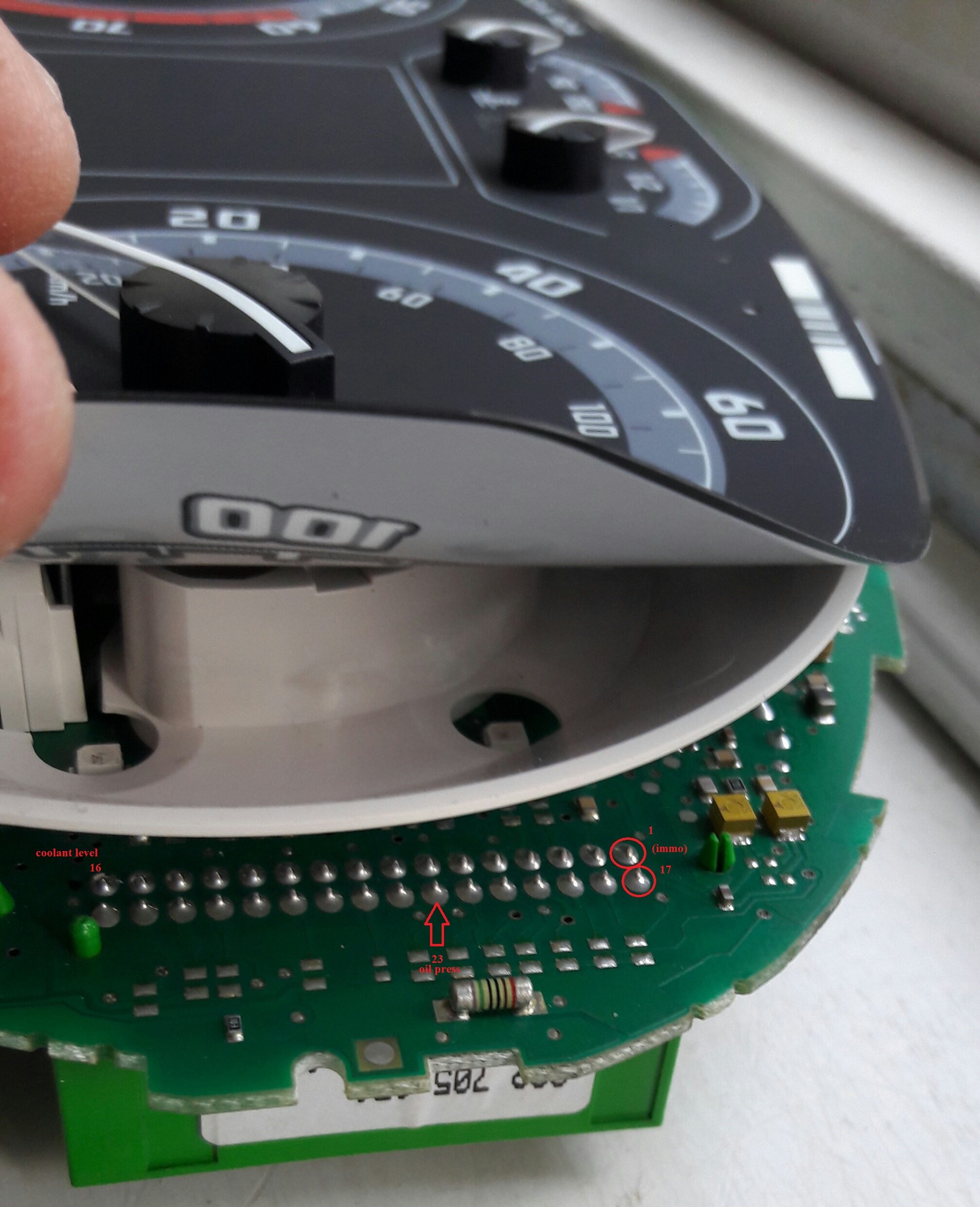

The car had  cracked joints in the cluster which stopped the car starting the top two were redone just taken dash out bottom four look cracked the weren't before so have redone them now will see how it goes thanks everyone
  • Sponsor
Yeah pretty sure the coolant shortage connection is one of the bottom few; hang on, I'll dig out a pic where it's marked.
  • Sponsor
Pin 16?
  • Sponsor
24 minutes ago, adamyt said:
RoHS directives came out in 2002 limiting the use of lead in electronics (Solder namely), have you ever seen a pre-2002 Fabia have cracked joints in the cluster?
Less to do with lead/unleaded solder, more to do with number of years of vibration, I suspect; and design that doesn't take into account the waggle of the pins that results from the loom flapping.
Modern designs tend to have press-fit pins that aren't actually soldered at all, relying on mechanical fit to keep connector in permanent good interference contact with gold-plated through holes.
The bottom four including number 16 as Wino said were cracked so i re-flowed them thanks all  :)
