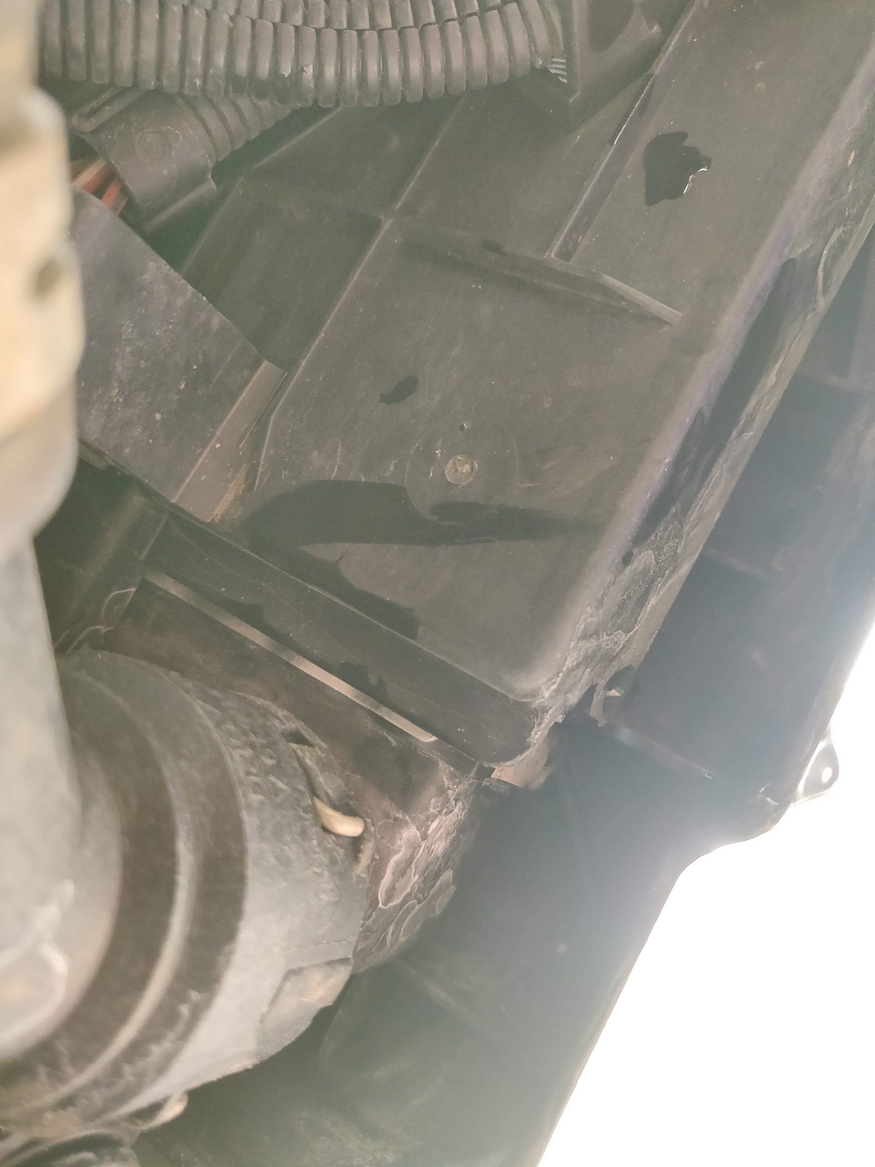

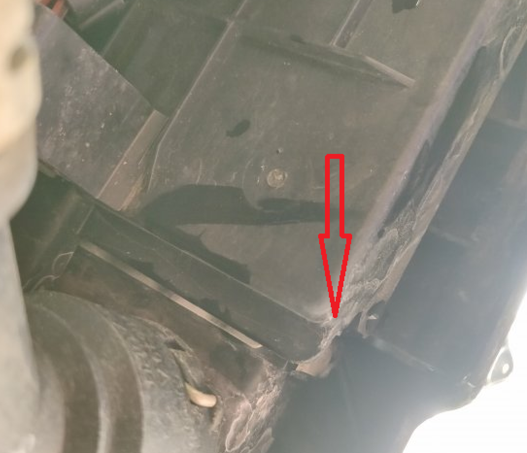

Just whipped it back on the ramps, looking at the diagram It's just above the drain tap, it doesn't seem to be leaking at all, from the attached picture it looks as if it's coming from within the metal casing of the radiator unit, anywhere obvious I should check next?
I'm considering putting some sealant into it until I do the headgasket as I'm concerned about reskimming and cracks in the head.

Thermoswitch is about 100mm above bottom hose connection, totally invisible in that pic.
Hi mate, that's of where the leak is coming from I did take some pics of the sensor but it was completely dry

New rad cheap enough if you look around.
The head won't be cracked but will need skimming, not much point putting radseal in it if the HG needs replacing, its a cheap and easy job to DIY and replacing the radiator while the head's away being skimmed will be much easier, replace the thermostat at the same time.
