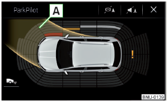

I have an august 2019 SEL ......
Purely from memory (as I am not near the car) but in forward mode I have the bendy lines like this:

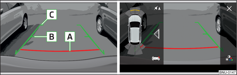

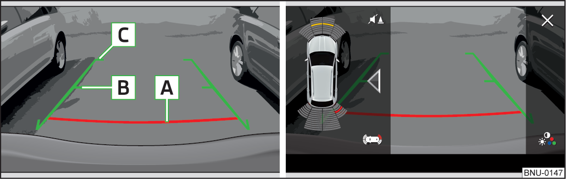

In reverse camera mode I have the fixed Green and red lines like the picture from the manual below:
These dont bend at all to show the trajectory but I do have the camera washer system so confused a little as folk are saying "High" has the bendy lines in the camera and washer system but low has the fixed lines and no washer system.
Thanks
Paul
Thanks for that.
It does seem confusing that there seems to be several variants and no real way to determine who gets which one.

Exactly the same as mine Paul, I too have the camera washer.

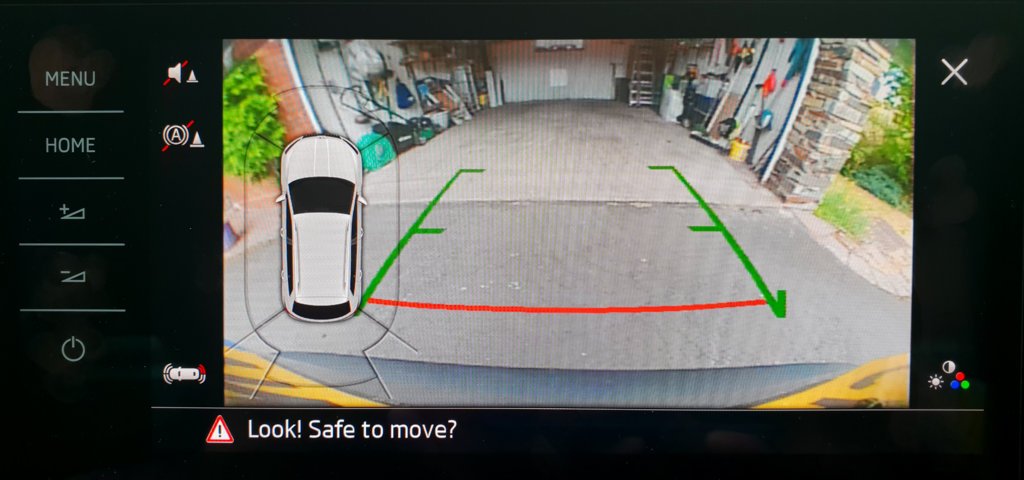

I have a 2019 SEL with auto park assist, the reversing camera has the washer built in and it has static reversing lines.
As shown above, the infotainment screen shows dynamic lines when manoeuvring but since there is no 360 degree camera option, this is somewhat redundant because there is no reference point for scale and positional context.
