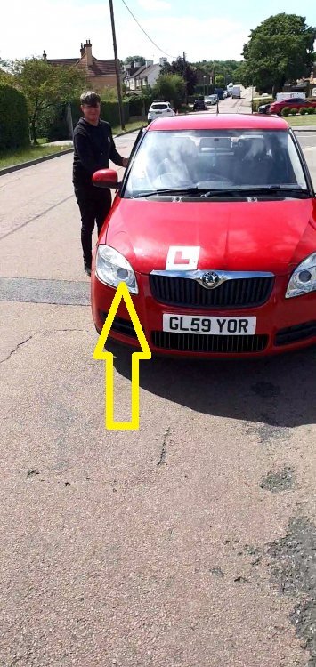

As it happens I've checked the fuse, (no 36 ) it seemed fine. I also changed the h7 , which still work fine in the full beam flash mode. There is another significant bulb that I didn't manage to get out, or turn on for that matter,  from the front is looks like nothing I've ever encountered before, a three inch circular lens , it'son the furthest outer side of the assembly, I will definatly need a to have another go at that one tomorrow, will post back . Again thanks for your insight

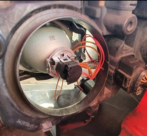

The 3" bulb you are mentioning is not a bulb.............thats the lens of the projector headlamp. (see image)
