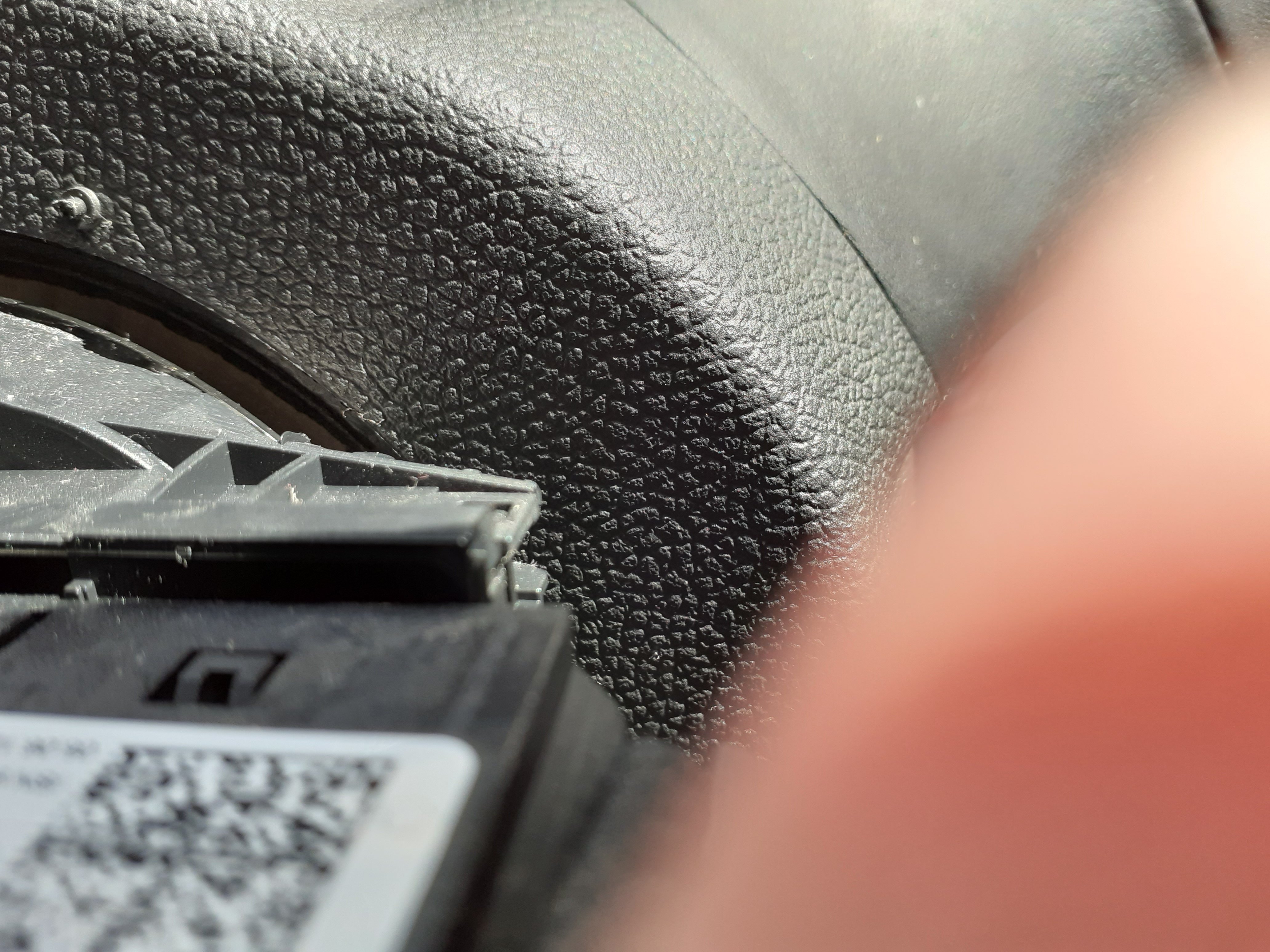

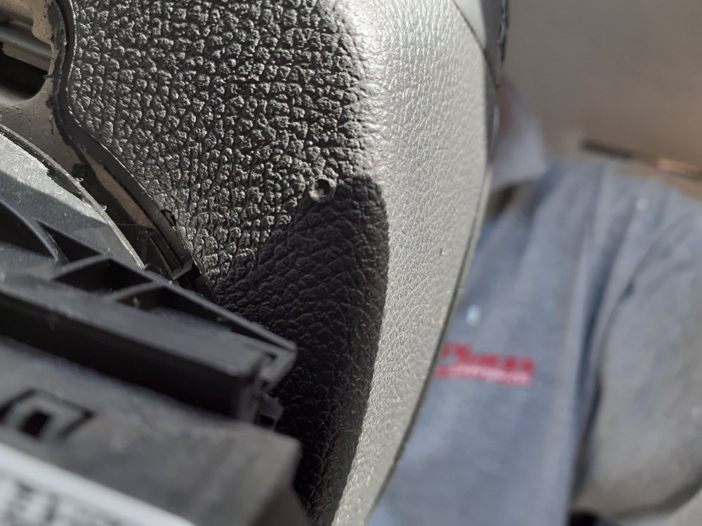

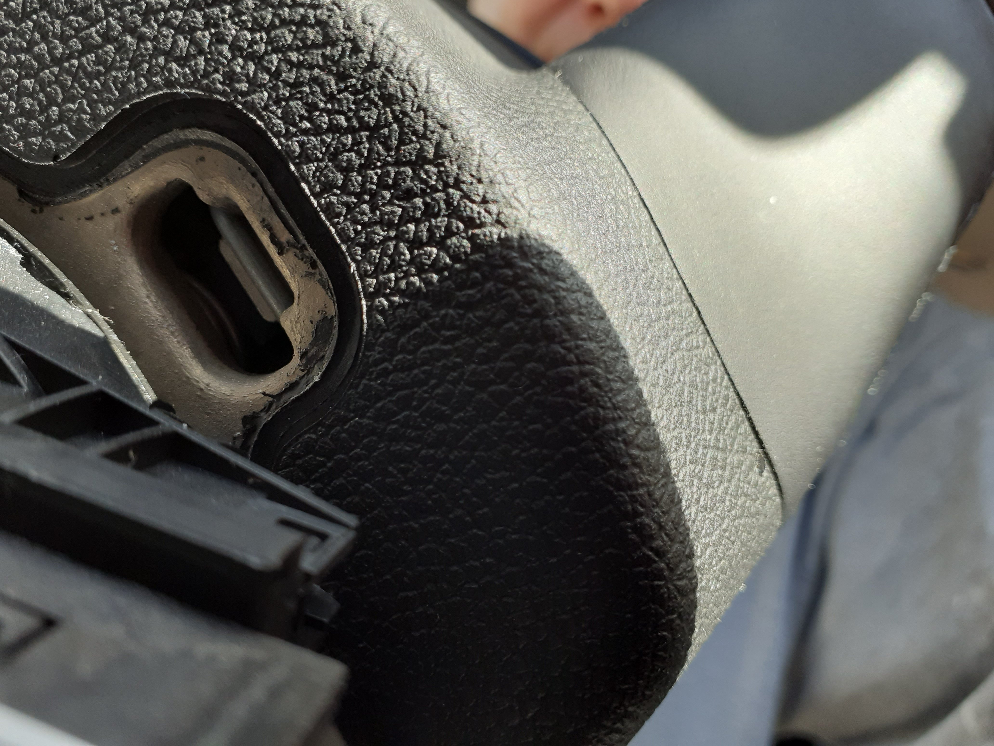

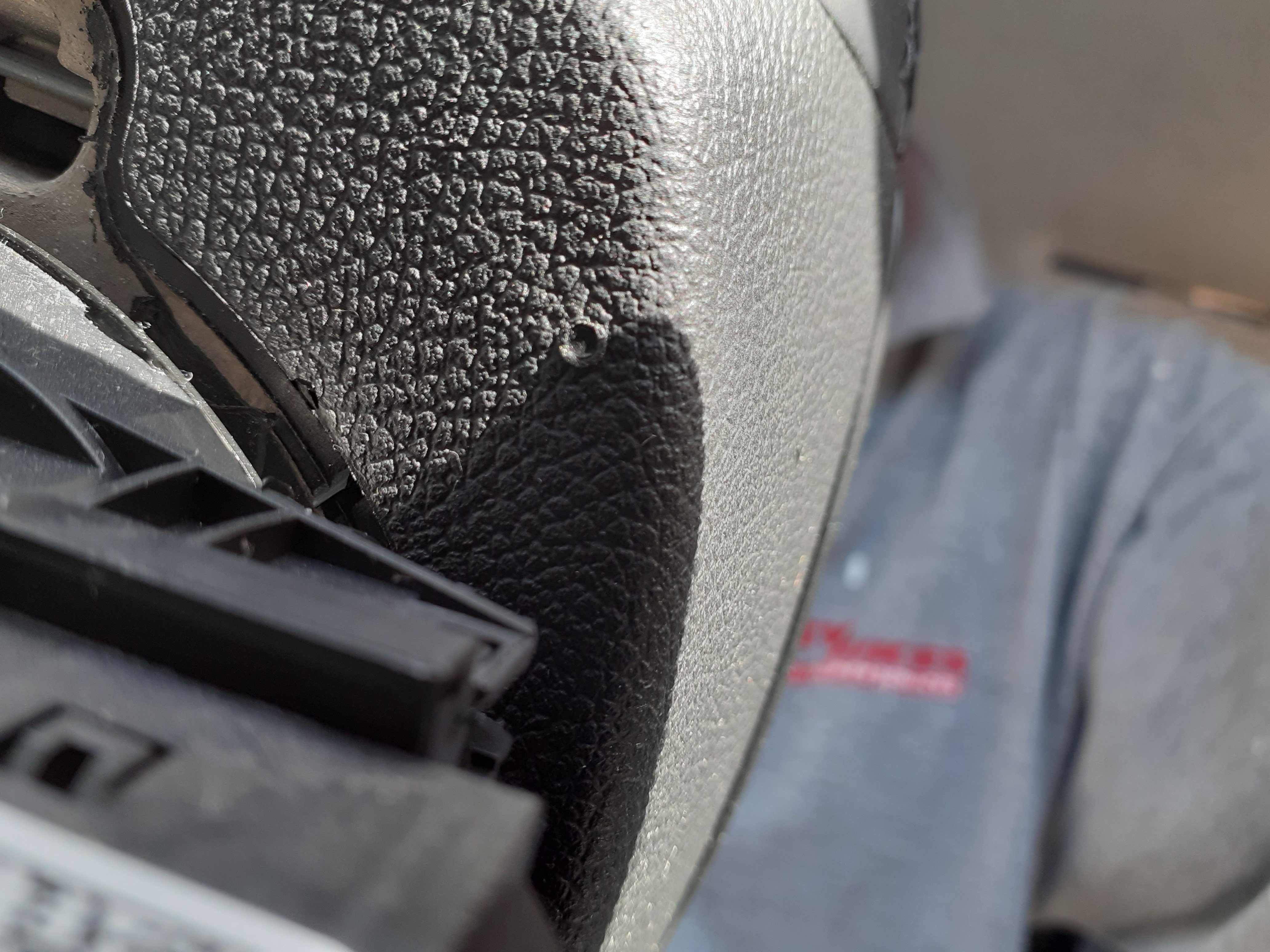

Some pics from @Fred66 relating to steering wheel removal:
Thanks wino ,
The first photo has what looks like a plastic rivet will I need to do anything with that ?
I was wondering if the second pic is what i need for removing air bag, there is a tab and what looks like a spring attached to it.
Presumably Press the tab toward the spring? Any insight would be appreciated.
you just need a small 4-5 inch long flat screwdriver, you turn the wheel 90° each way then insert the screw driver and lever the spring, it does not need much, if you put a small pulling force on the side of the airbag you are attacking
you will feel it release, then rotate the other way and repeat.
Unplug carefully the electrical plugs and put the airbag to one side, just lay it face "UP".
The steering wheel is just a nut, just ensure your wheels are straight ahead before removing, may need a small "wack" from both palms from behind to pop it off the splines.
The stalk / switch assy is held by a metal clip with one allen key bolt, you just loosen the bolt and it slides of the column. The switch connector is one huge multi-plug with an integral lever to remove, you have to ensure the lever is fully up before the plug will release.
