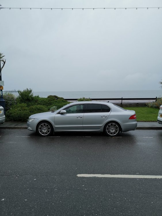

Hi guys. How big could be a wheel spacer on Superb 2012?
Would you recommend brand?
Thanks!
It is hatchback on 18" alloys

The wheels are too skinny at 7.5". Personally i would look for a set of audi wheels at 8-8.5" wide.
The back of a superb is fairly wide and 225s on a 7.5" rim looks slim anyway. Just my opinion of course. I see what you mean by using spacers but i don't think you will like the end result anyway
