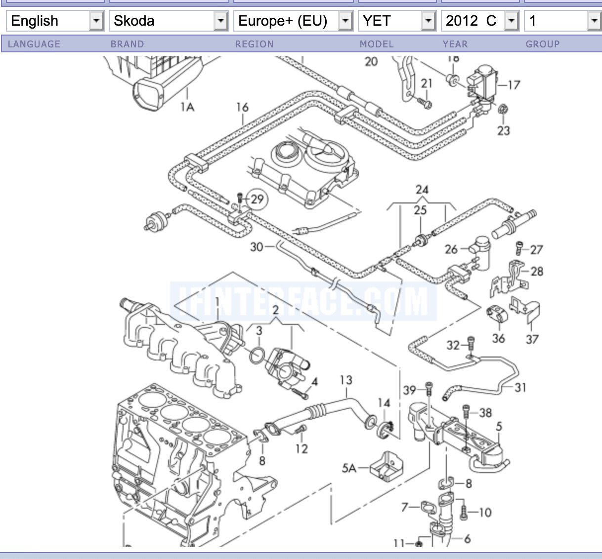

And the actuator must have something to do with opening and closing a valve either to the intake or through the cooler, not sure as the EGR has a direct impact on the DPF. #complicateds-l1600.jpg

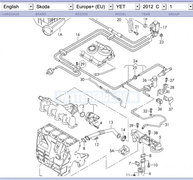

Bertie90, the actuator diaphragm that's failed is the one that sends the recirculated gases either through the cooler, or the 'uncooled' pipe. Not sure what the default position is, cooled or uncooked, so I'll run it for a bit and keep an eye on temperature and mpg. Hopefully it's stuck on the cooling side 🙂

Default position is the 'uncooled' side. The actuator isn't sold separately, it's only a complete EGR cooler. Next step is to pull the actuator rod so the gases are going through the 'cooling' side. Preference is to have the recirculated gas 500 to 1000 degrees cooler, hopefully there's less chance of any residual damage...
