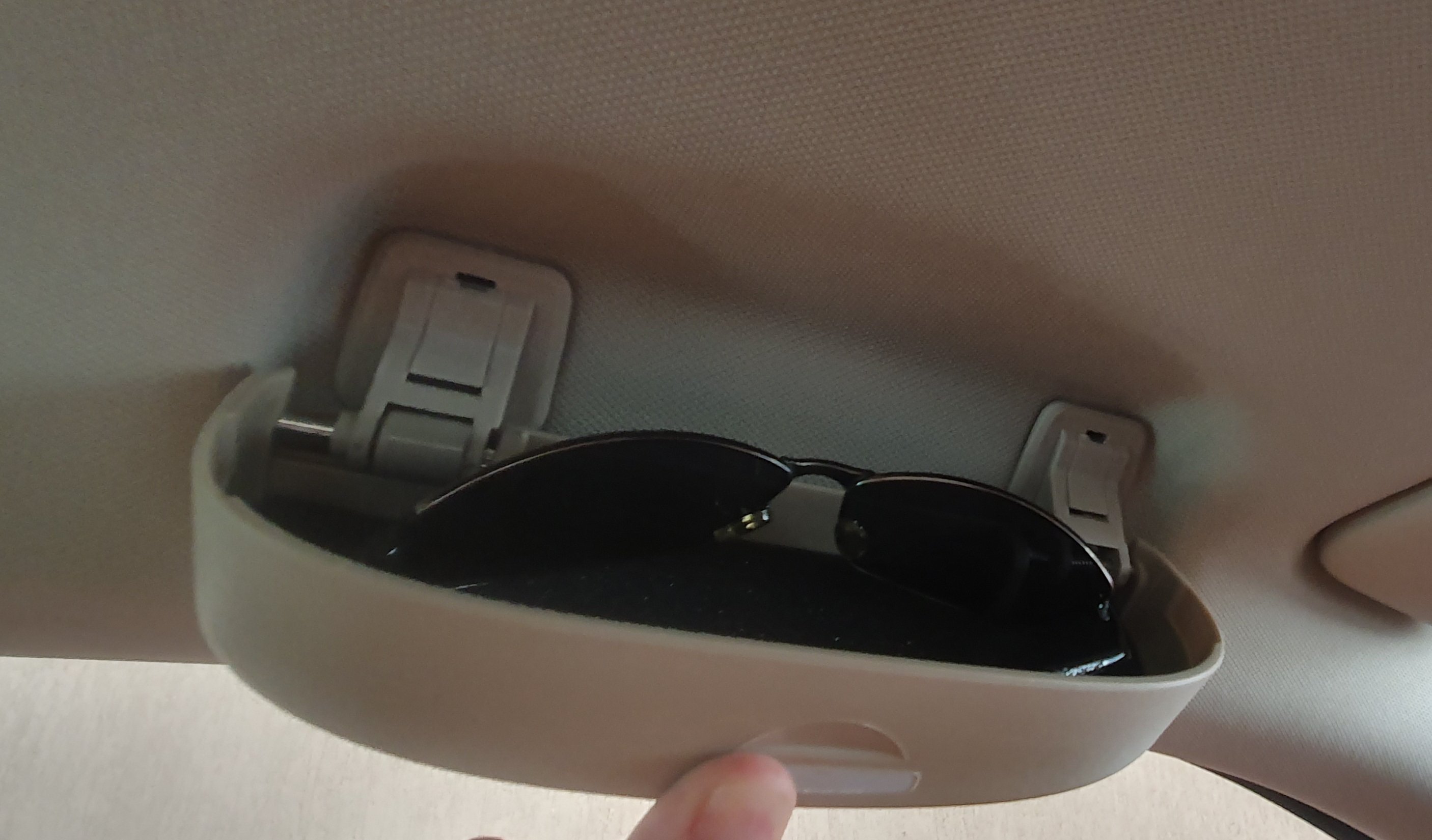

There is a spring-coupling, as well as soft foam rubber inside.

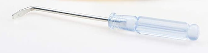

There were no problems with the installation - in general, the instructions very accurately convey what to do. The only comment is that you need very small (but sturdy) screwdrivers to remove the native handle. I took the usual flat ones first, and they were too "thick". Small screwdrivers from the phone repair kit came in handy. It took me about 20 minutes to get it done.
Instructions. The hardest part is taking out the original handle (step 3).
Small but strong screwdrivers.

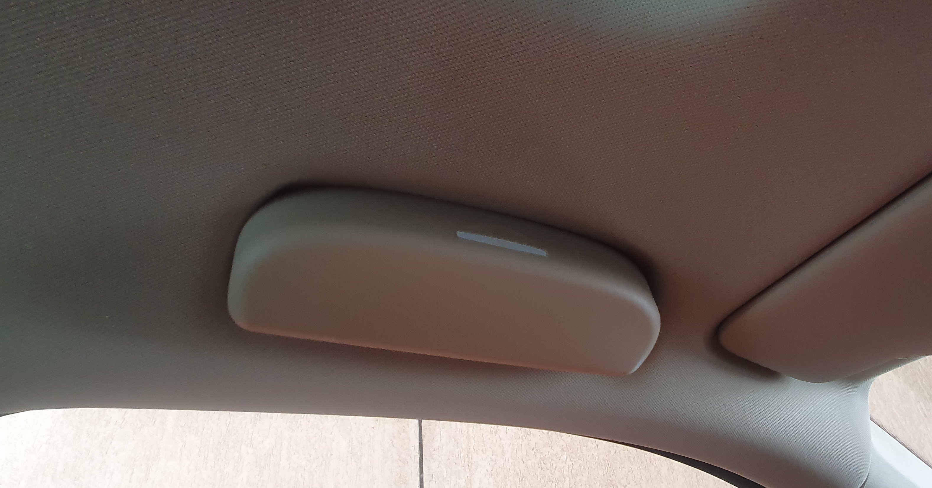

The result wasn't bad. In general, the quality is a solid 4/5 - held firmly, not dangling, glasses are placed inside confidently.
In the closed state.
With glasses inside.

This is the one which was shipped together with the holder. Used it for step 1-2, but it's not usable for the step 3 due to the curve. Also, you need 2 at the same time

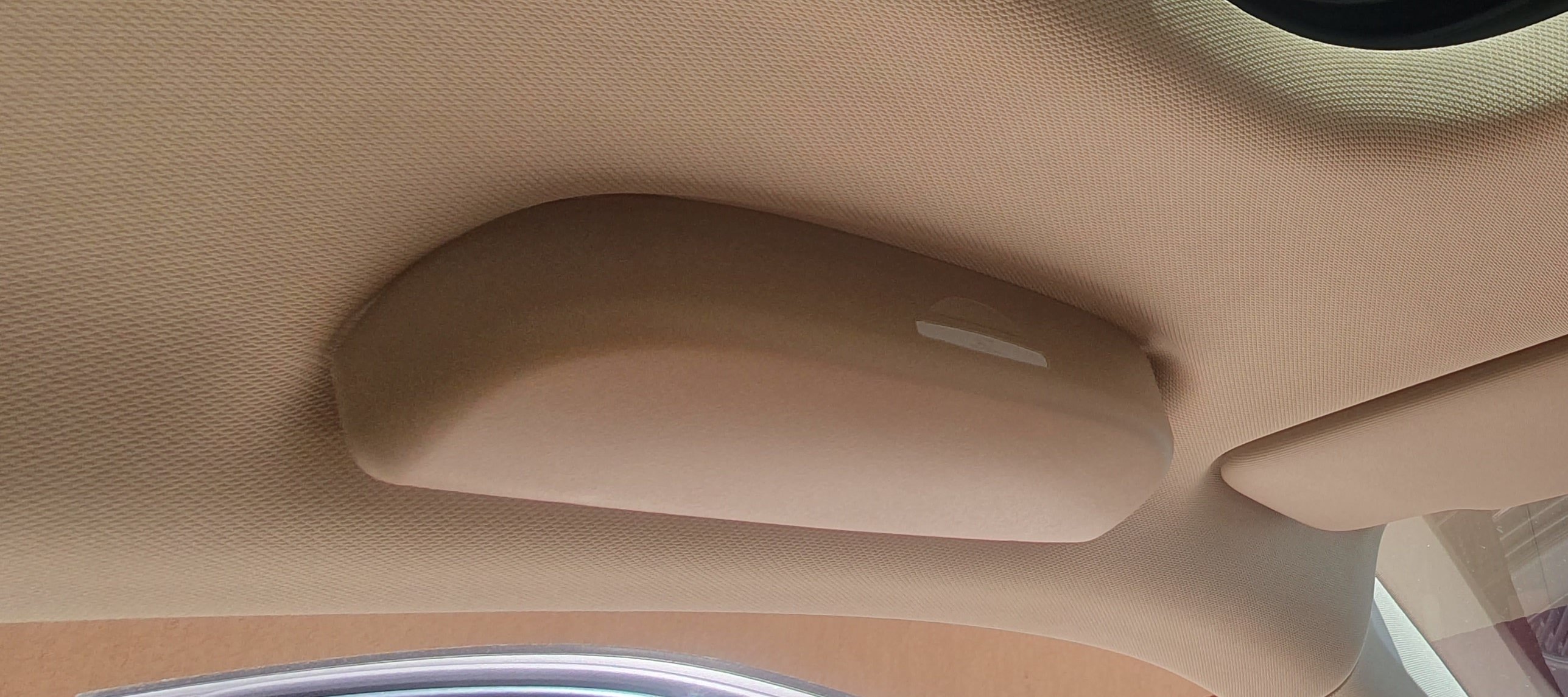

Using this very useful guide, I also managed to remove my sunglasses from laying around into a suitable place.
Nothing relevant about the installation, just make sure you got two sturdy but thin screwdrivers and pull at the same time.... no fear.
Price for this item was around 25 euros, that is 10 more than spent by fergard in the same ebay.de place three years ago ... 🙄
One photo in bright sunshine to see, the "beige" difference is not noticeable.
