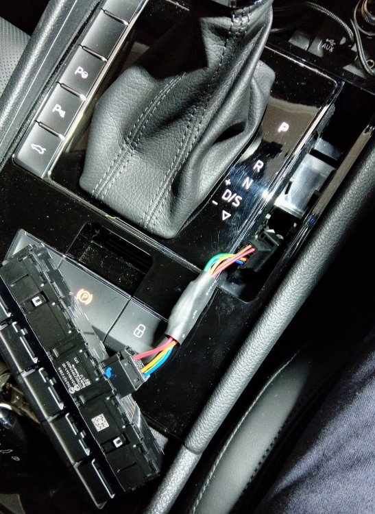

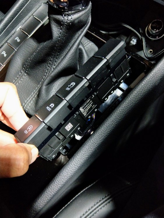

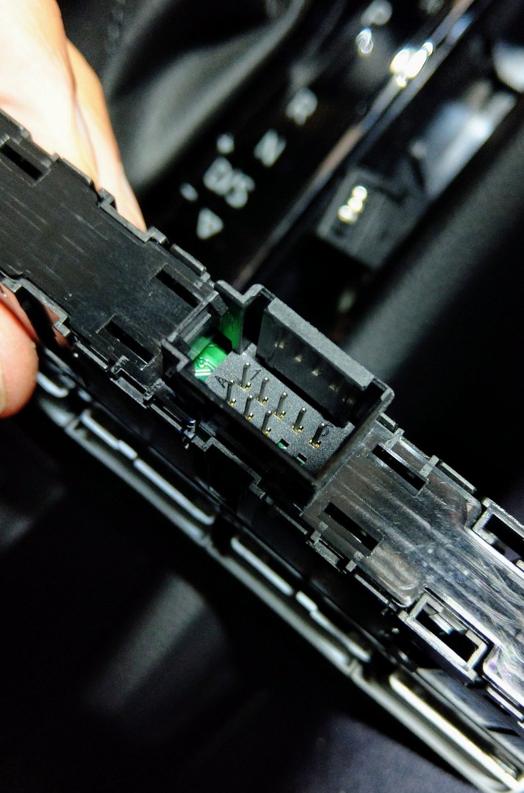

I'm keen on doing this too, but in my case to operate my garage door opener.
A number of Golf owners have done this by buying a additional button to use in a blank spot, and then wire up the garage remote to it.
I've removed the existing switch panel to see how it all hangs, and it appears they share the same "backbone" to interface with the car.
So adding another button to the existing loom will b tricky.
However adding another button, wired up separately might b possible.
IMG_27072020_075034_(1080_x_1440_pixel).thumb.jpg.f742099efb0557c3ff91b0d4395ad210.jpg
IMG_27072020_075104_(1080_x_1633_pixel).thumb.jpg.c28b3c2f205acb68153a05fb38b0ccdb.jpg
IMG_27072020_075048_(1080_x_1481_pixel).thumb.jpg.4ff54991b1ddd13872f0306922ee15c3.jpg
