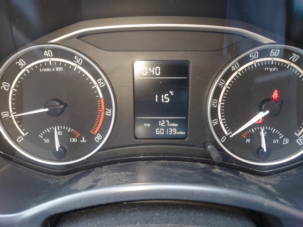

Speedo needle LED replacement 2010 VRS
Hi all, I can't seem to find anywhere that sells the LED's for an instrument cluster or what these types of LED are called exactly. Just wondered if anyone knew where to get them from?
I might not need them as sometimes the LED does work so it's hopefully just a loose connection but it might be worth replacing all of them whilst I have the chance
Thanks

Although LEDs do fail they are much more durable than the older incandescent bulbs so my first suggestion would be to simply locate the 'bad' LED and check using diode mode on your DMM, also checking continuity back along the PCB, chances are it's just a bad solder join.

Ok thanks I will try that I am hoping it's just a bad connection somewhere. It would be nice to have a spare LED ready though just incase it does need changing
If faulty, replace the LED with another from somewhere discrete on the board to match colour then salvage an LED from elsewhere e.g. TV backlight strip/torch etc and insert it where you took a donor.
I say discrete as any substitute may not be the same colour/brightness but may not be so apparent when not used on the main part of cluster.
I'm sure if you looked hard enough you'd find them online, don't be Skoda Octavia specific in searches, try the tube for guidance and go from there.  I still doubt the LED has failed instead a solder join has failed.
I would expect a whole bunch of LEDs to cost no more than a fiver including postage, there's nothing special about them.
* If you could, please post a closeup photo(s) of the LEDs to help future identification, preferably with a ruler showing mm in shot.

Doesn't have all the info on there although I'm not actually sure I will need to replace any as the LED does work sometimes. I imagine an LED either works or it doesn't? So it's hopefully just a dry solder joint or something
 in my experience repairing electronics I have seen LEDs dead, damaged, burned, exploded and some that worked intermittently.
Thanks for all the replies folks I have successfully replaced the LEDs for the Speedo. One of the originals seemed to still work so I guess the LEDs are in series? The LEDs I bought are brighter than the originals but I'm not too bothered about that. One thing. I noticed when testing other LEDs in the cluster is that my ABS light doesn't seem to work but I don't have a red or orange LED to replace it with so I left it. Think it probably hasnt worked for years but should pass an MOT without it anyway haha
