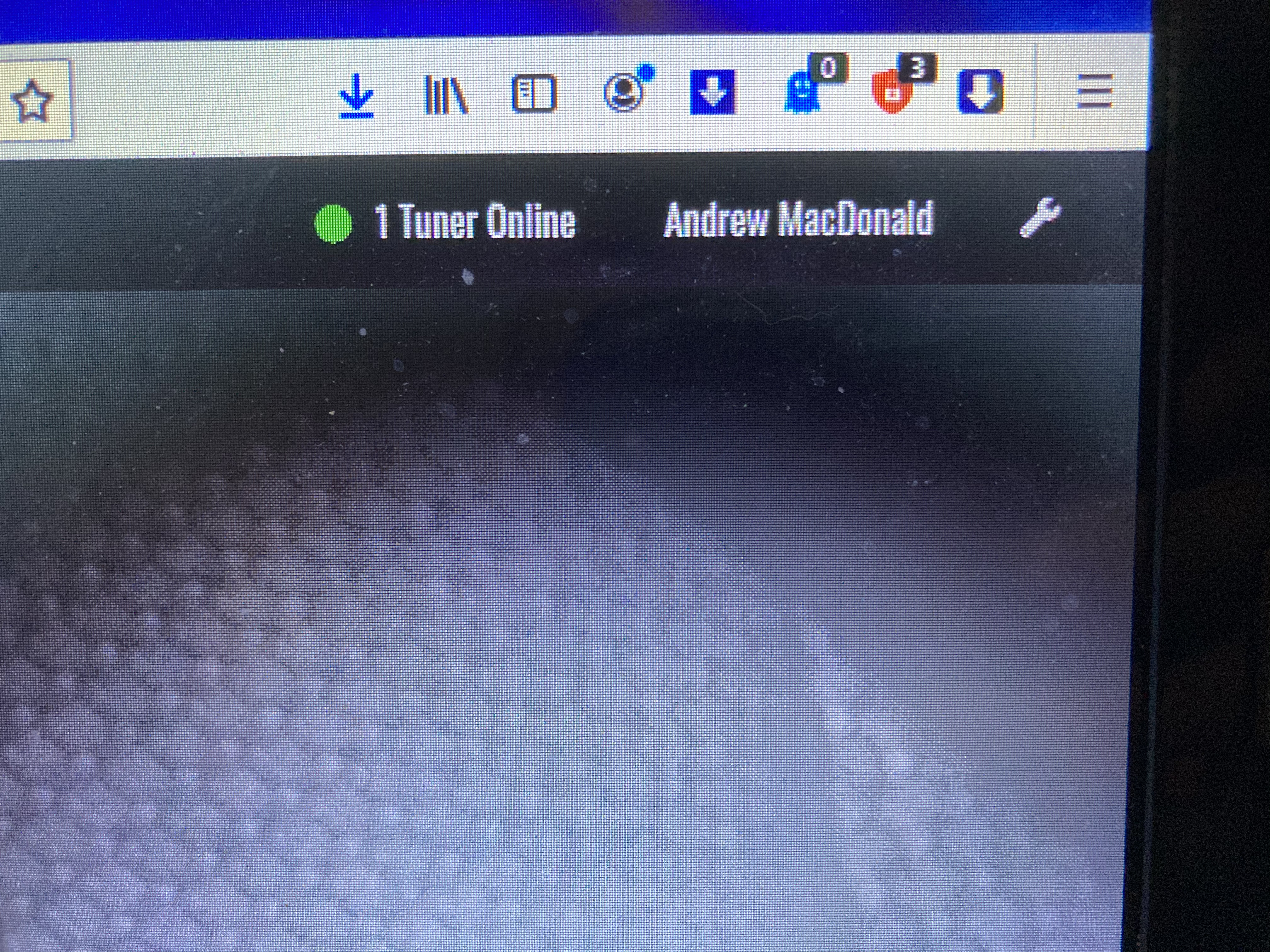

and it’s that simple plug it in select what map you want and it uploads it to the ecu and darkside are at hand via a online chat to get map tweaks when ever.
