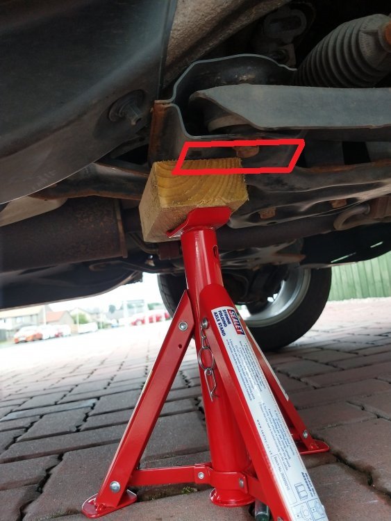

I'm hoping my placement for my axle stands on my Fabia was correct. I realise the dangers of incorrect placement but me and a mate had a good look whilst it was up on small ramps. Is there any issue where I put them??
No, that's fine.
I agree it was ok.................however I would / do have it in the same place but across that mounting like below so it's not resting on the edge and with the axle stand as it is
