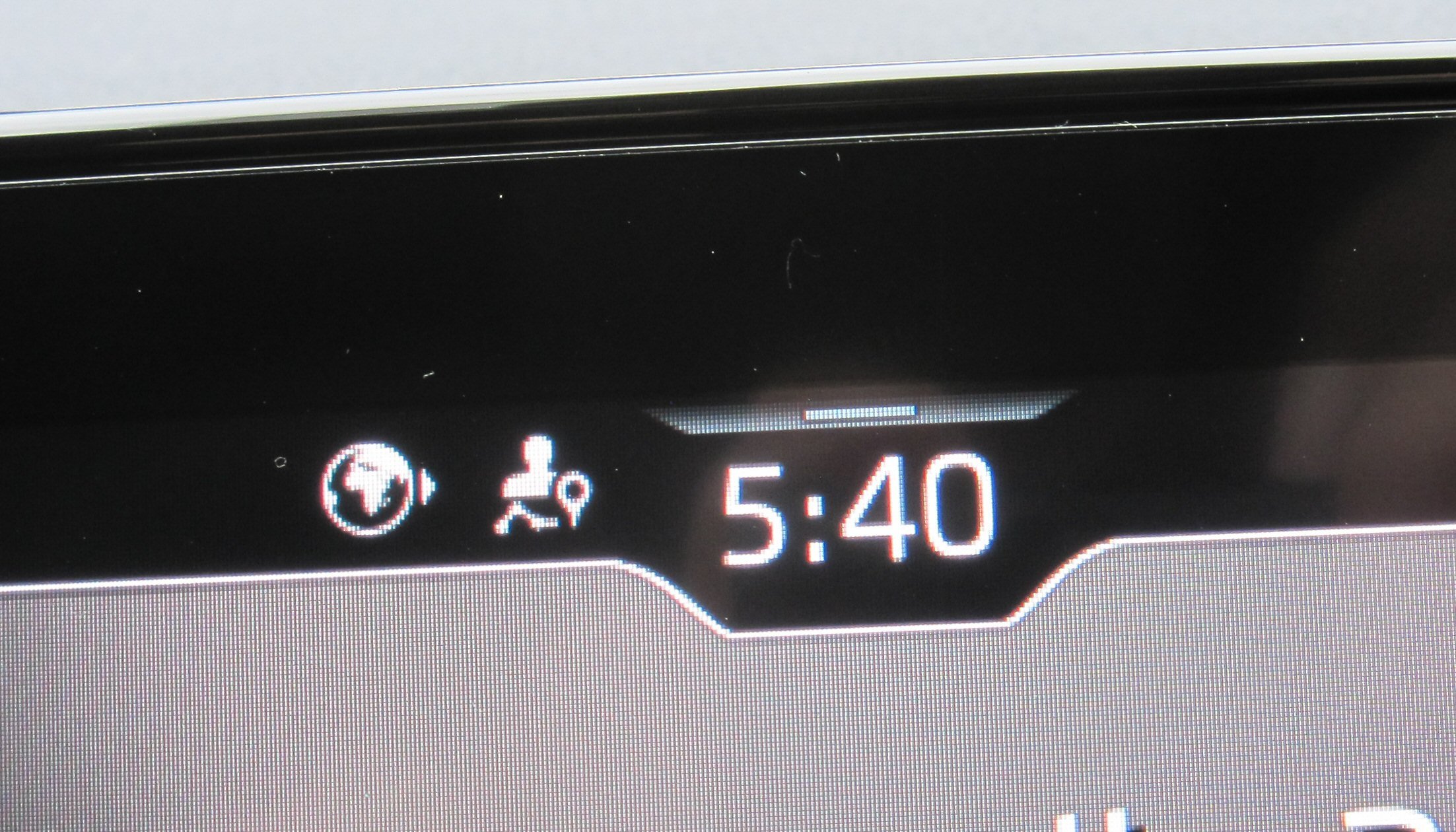

Secondly, there are a couple of icons at the top of the main display that I cannot find in the manual - see picture below, taken in the courtesy car.  The left hand one, looking like a map of Africa, was red in the Superb, which I now suspect means something else was wrong.  Can anyone advise what these two icons depict ?
Your white Africa will probably mean it is online whereas your old red globe meant you weren't.

The red globe icon means that the mediasystem does not have an internet connection. Setup a mobile hotspot or insert a simcard in the simslot if you have one.
